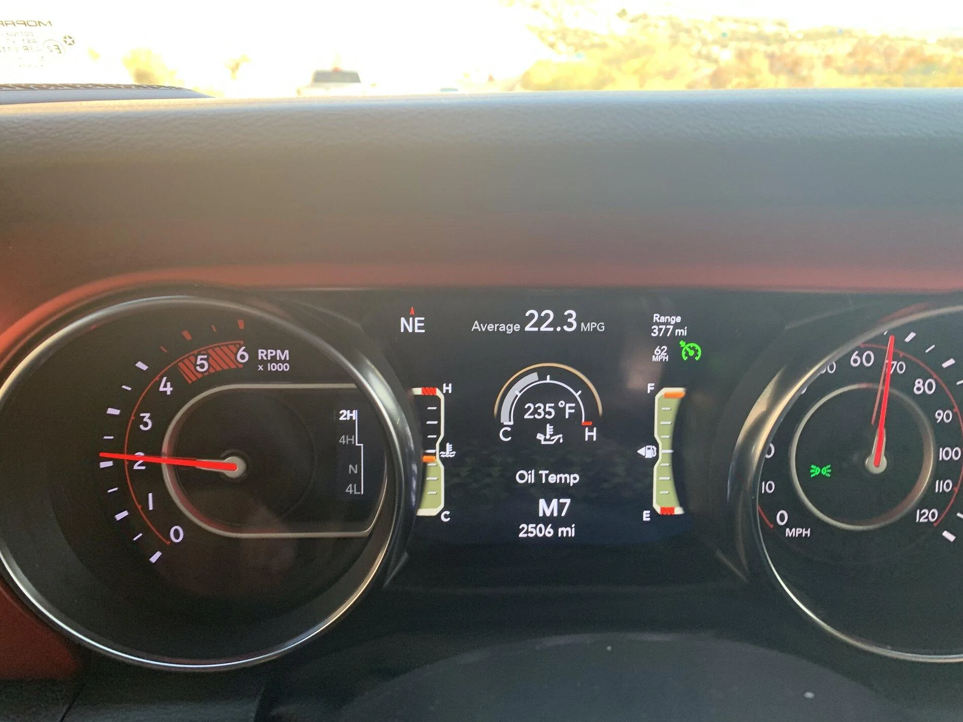

This pic was taken as I crested the climb north from Camp Verde, AZ, to the weight-station/rest area. The trailer being pulled is a 2014 28' Airstream International; the oil temp spiked to 240f when I had to increase speed to 70mph in order to overtake a slower RV. Once I resumed 62mph, oil temp returned to 235f, then back to 220f at the Sedona exit. Coolant held at 217f, and the venerable 8HP just barely fanned itself at 199f. With 4.56 gearing on 37 13.50's, it has little difficulty holding 7th on the grade while using cruise control. And finally, intake air temp dropped from the insane 199f pre-scoops to 88f, although ambient air was about 20f higher on the prior figure. I feel, that as far as my needs are concerned, this is a good balance.
Edit for pore grammer
This is really helpful; heavy load, steep grade, good speed and excellent results. Super

Wow you are lucky or I got a lemon. 268 degree oil temp 4 miles up Rt 87 from Sunflower to Mt Ord. Way less hill and distance than the one out of Camp Verde and I was not towing anything.
