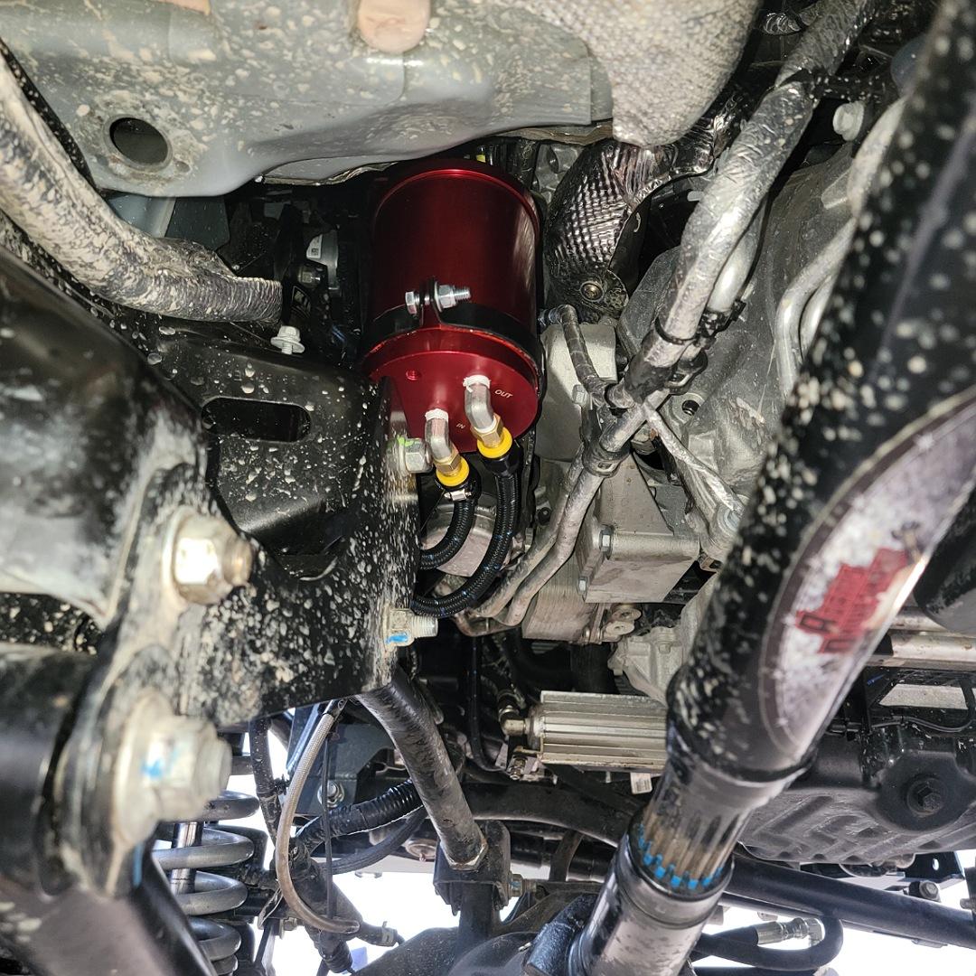

I used their generic bracket and made a few small modifications to it and tied it in to the driver's side motor mount by using the factory holes and replaced the 2 factory bolts that were not long enough with 2 grade 8 bolts.

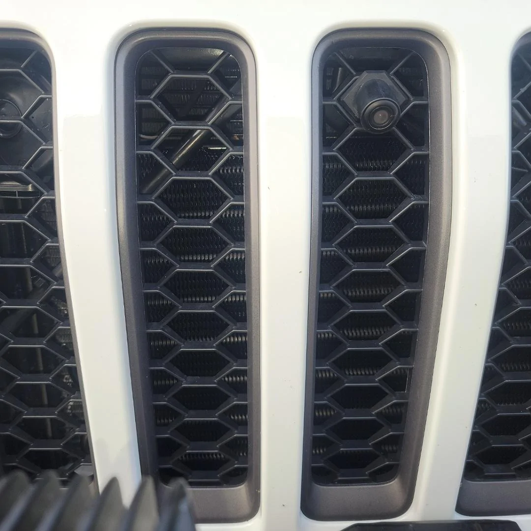

The oil cooler was lightly dusted with black spray paints to make it invisible and there has been no change to engine temis engine temps after placing it in front of the radiator.
I had to purchase more hose hose so that I could reach from the filter to the oil cooler and back command back, so I bought higher quality rated hose to use throughout the entire system.

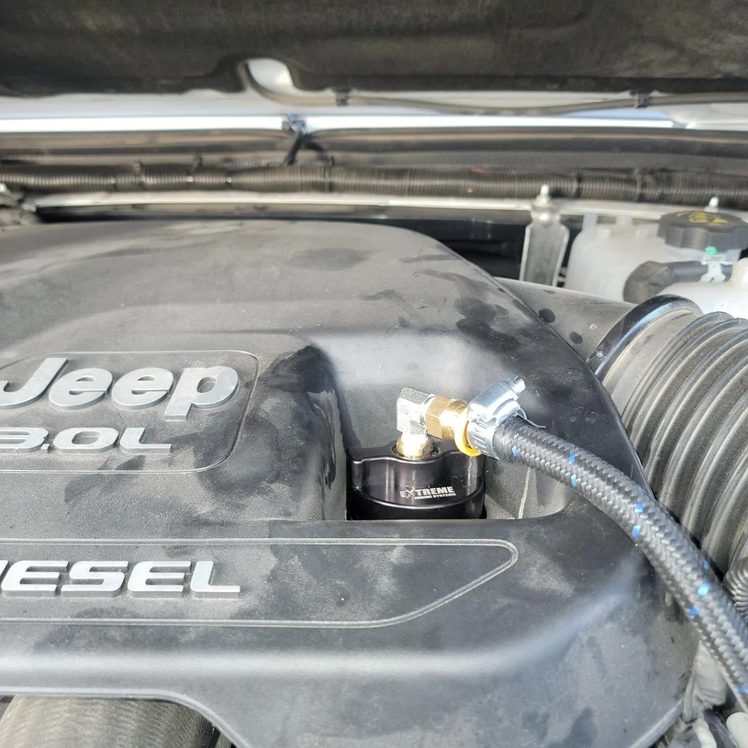

I also opted to go with the oil filter cap version of their kit to make installation incredibly easy incredibly easy since you just pop off your oil cap and install the new one with the older style oil filter from 2019 and 2020.
