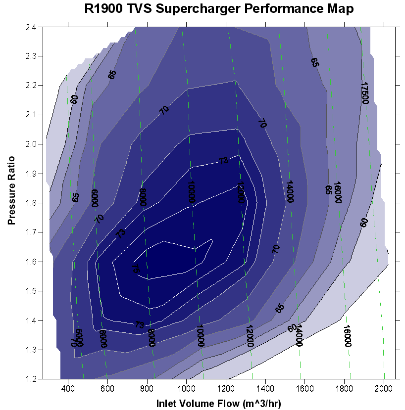

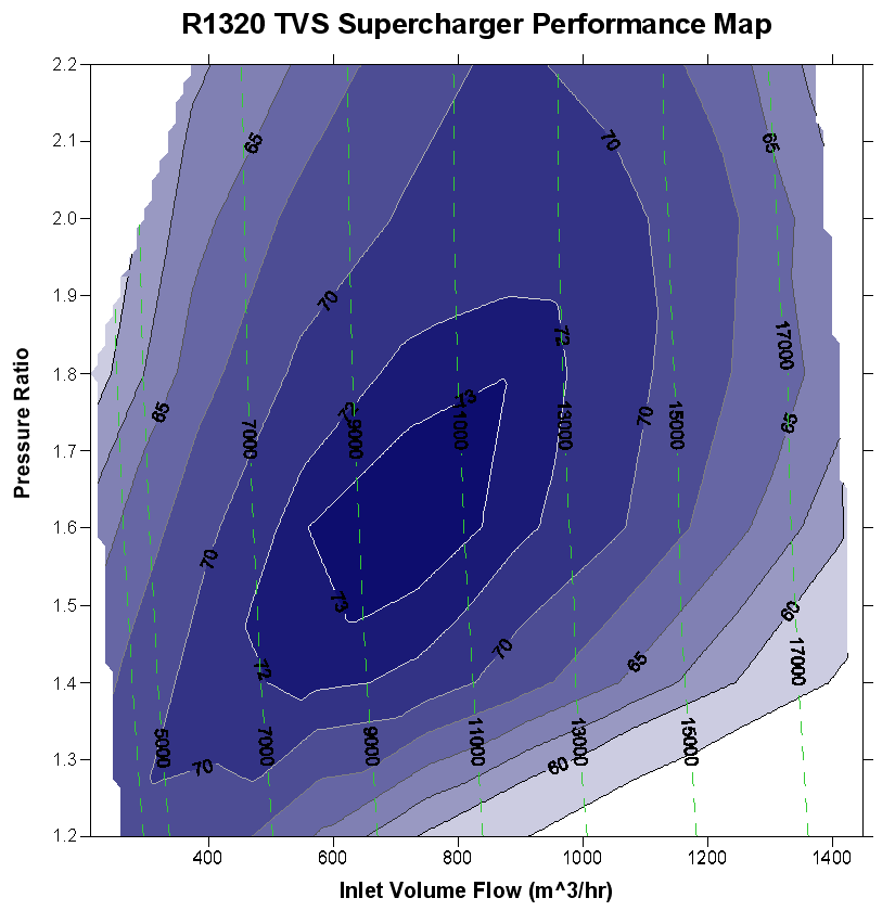

It will be interesting to see saturated IATs on the edlebrock. With the 1900 IATS always seem to be in check even on long grades with a load. Moving more air without having to squeeze it as much is good. The question is, is 1900 too much and is 1320 enough or just right.
I got some data on this. Towing a full 7600lb load, with multiple passes up baker grade (7%), in 110deg heat, the highest they got the ait's was 46deg over ambient. Back to back to back to back to back pulls at WOT in rapid succession on the dyno netted a 12deg increase to AIT's.
The 1900 is a big boy blower. For comparison, the 1320 came stock on the B8/B8.5 S4, and the 1900 came stock on the CTS-V.

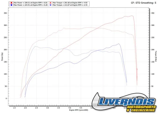

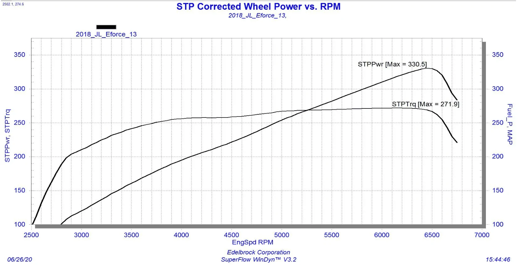

Looking over the efficiency maps at our power and boost levels, even projected out to 18psi and built motor power level, i dont see the 1900 having a massive advantage. Its the ability of the 1900 to fill a larger motor. The Magnuson side car orientation does allow for a much larger intercooler though, which I think would pay dividends when you turn up the wick? I think the 1320 can feed this motor fine, as long as the heat exchanger holds up with more boost, and id guess at stock levels a non emission tune would give the Edelbrock more meat on the tq curve. It would also be much easier to port the Magnuson for meth injection in the cover between the blower and the IC than it would be the Edelbrock. Very interested in your thoughts.
Livernois Magnuson non-emission legal 93 tune vs Edelbrock canned CARB approved 93 tune w/ TCM tune below. Edelbrock stock dyno figures are identical to Livernois
Jeep Gladiator Edelbrock E Force coming soon. 226D8EE9-0367-4056-AEA7-C24E102308C6
Jeep Gladiator Edelbrock E Force coming soon. 7F32C37B-924B-4AC9-9576-E3BFEF63C8EF
TVS 1320 and 1900 compressor maps:
Jeep Gladiator Edelbrock E Force coming soon. BC4233D6-2C54-4949-9C81-A5F4B773602E
Jeep Gladiator Edelbrock E Force coming soon. 392B7B5A-BD9C-478D-AE68-AE522DEBC87B
