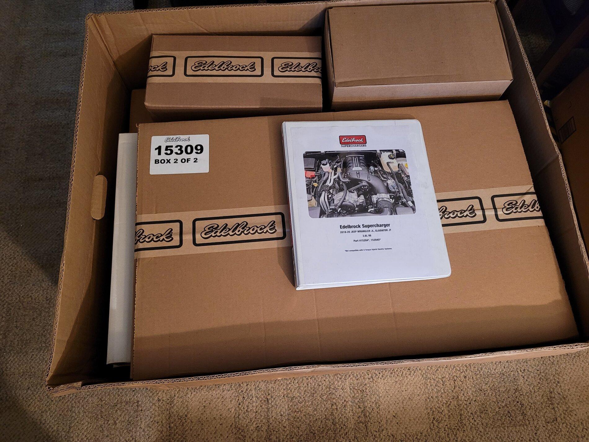

Well, this showed up today...
Jeep Gladiator Edelbrock E Force coming soon. 20210428_191442
So...
Jeep Gladiator Edelbrock E Force coming soon. zel8j
One thing I was wondering for anyone who might read this and picked up a spare ECM/PCM for their install... Edelbrock has some info that needs read off the ECM, namely the OS for tune purposes. If I get a used spare ECM and send that in to them, would I be able to just hook the spare up to my vehicle harness and read the spare's OS, or is that bad juju? Thanks!

Congrats! We used an HP tuners ECM which basically unlocked the whole computer. Going that route might be real nice if you plan to do any sort of tuning down the road.

Thanks TrailRax - and thanks for the 411 on how things are going with the SC on your Gladiator! I've been thinking about this and probably need to hit up Edelbrock because I have some more questions after reading through the directions (which are updated vs what's out on their site to DL).
Since the kit comes with the HPT RTD and 4 credits, was now thinking that sending the used ECM to Edelbrock to unlock would achieve the same thing as buying one from HPT. If I buy a used ECM and send that to Edelbrock for unlock (with the current OS/stock file from our Gladiator), I can just keep the one that came with the Jeep so my wife can drive it until the unlocked ECM comes back and I can do the install. Then install the unlocked ECM, flash with the tune, and go. Anyone think this is not going to work?
Also need to hit up Edelbrock about the tune selections. They tell you to specify if you want the 91 or 93, but I'd prefer to get them both as I plan on pulling a camper to western states (91 octane file), but 93 is what they sell around here on the right side of the US.
