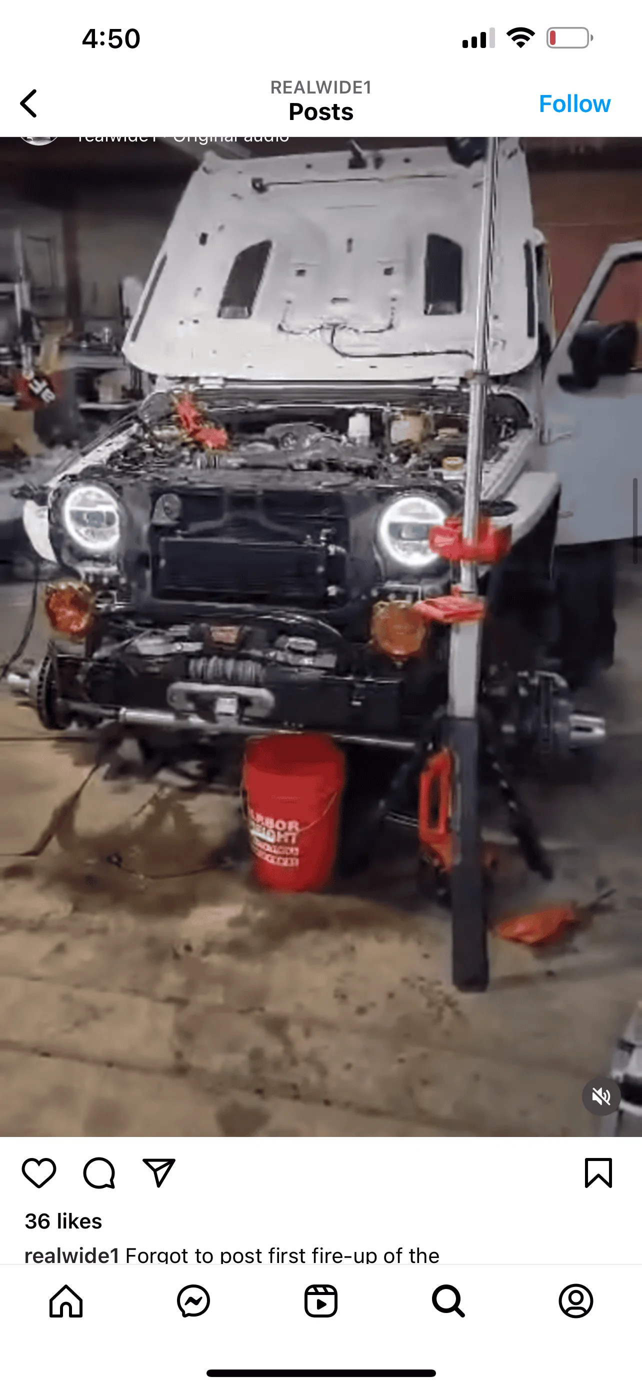

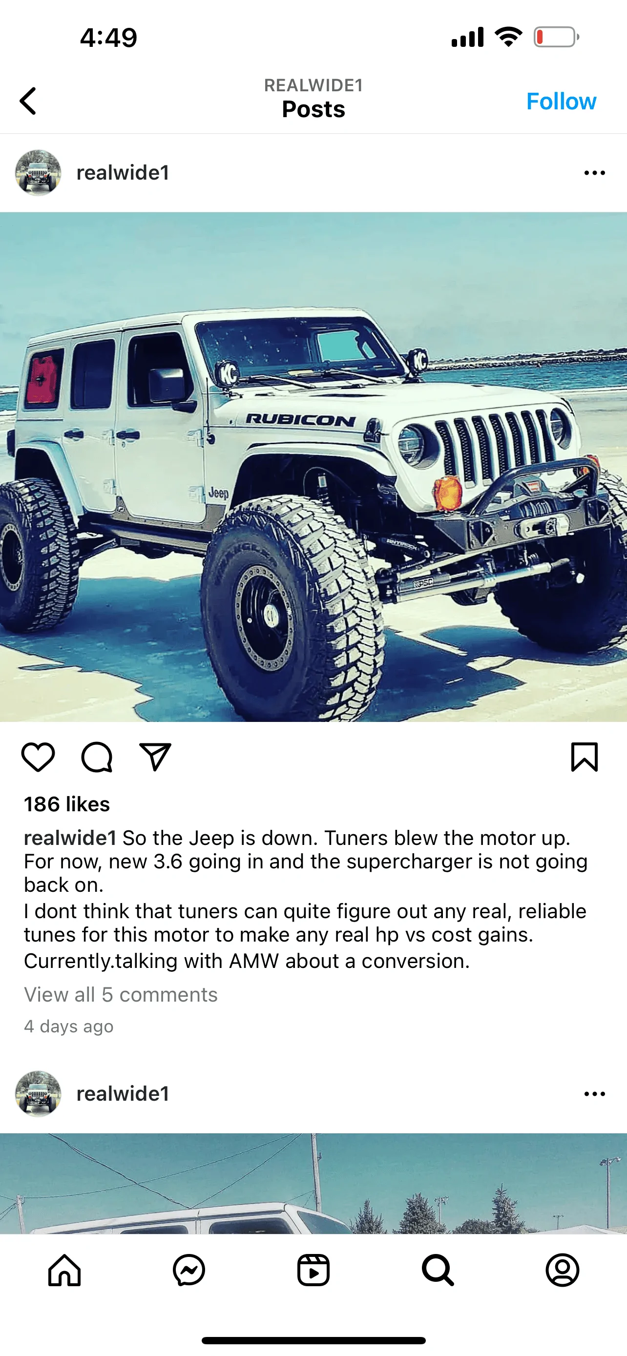

Well I am never one to shy away from the truth.
Yes the engine expired. I finished the truck and was using it as a daily and was getting the driveability nailed down on the tune. I drove it to work, took my kids to sporting events, to the family out to dinner.
With the Sprintex, I had to create a new tune from scratch as the boost curve was much different. I ran things conservatively as this vehicle presents a big load just driving down the road.
After seven days I was pretty positive I had the bugs ironed out and I returned the jeep to the shop. I was so confident I threw the keys to the shop owner and said let's go for a spin, even told him his wife could go for a ride.
As we got out on the highway the truck shifted to 4th and that was it. No warnings no jerkiness, all the data looked good. All the equipment I had hooked to the truck did not catch whatever happened.
We brought truck back to the shop and I apologized to the shop owner, for failing him, and disappointing his customer, and told him I will do what it takes to make it right, and I am. I Also called Sprintex and told them what happened, and apologized for not getting it right.
I have over 300 hours in this vehicle, and a bit of money in equipment and consumables, and now I will have more time and money into making the shop and customer whole again. Sprintex has been very supportive and is working with me on finding an engine.
I was also curious as to how this happened, so in a move that in hindsight was not very smart. I put this tune on my truck to try and sort out what happened, as I wanted to have answers and support everyone
Well truck was driving great. Went to do some errands yesterday, and now my truck is down, same type of failure. Whatever it is, it is fast and brutal, with no warning
Long story longer. The shop and Sprintex are not to blame. The fault rests solely on me, and I am very sorry for what has taken place. I was very confident I could figure this out, now I am not. It will be a bit of a burden to make it right, but all I can do is dig in and start doing so.
At this point I am not sure what my plans are going forward. I have 1000s of hours on my original tunes. I have dyno time, and lots of study. I will still work with those who have purchased them. I am pretty sure I will not stray from that formula anymore. At the moment I am pretty sure I am done tuning this platform as it his taken a fair bit of time and money, and I do not have much to show for it.
