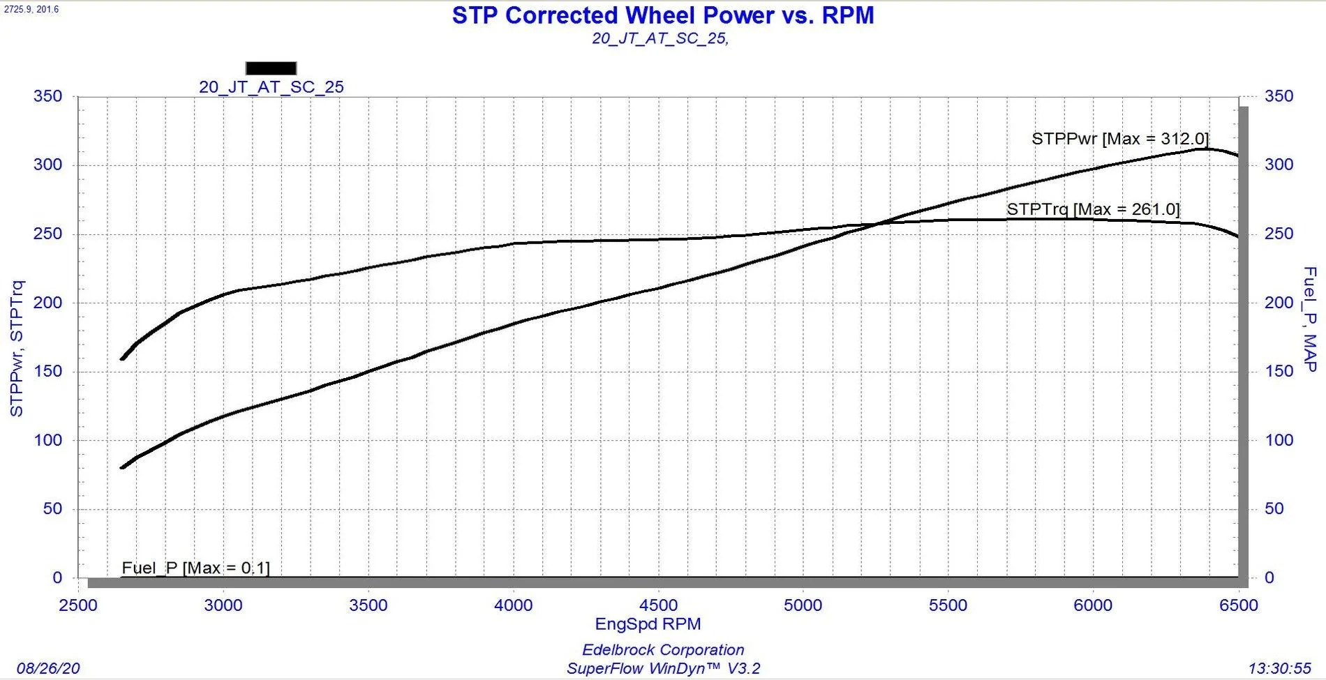

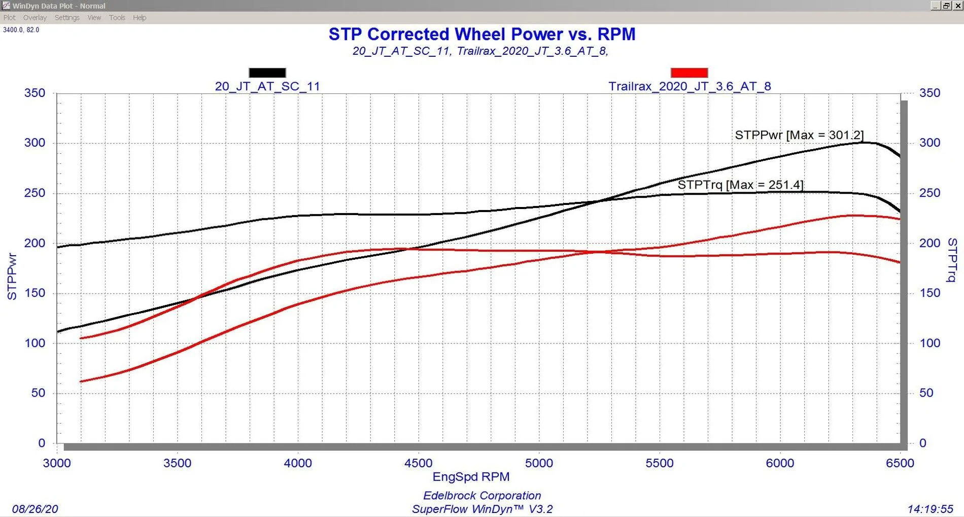

Hey all,
Back with some info. we got the go-ahead to leak some pictures! here is the power output graph straight from Edelbrock HQ. This is our Jeep's output stock and with the Supercharger.
Keep in mind our Gladiator is a 2020 Jeep Gladaitor Sport S with Max tow package rocking the 4.10s. Also Stock exhaust.
Edelbrock team shared with us this graph of our Jeep. Keep in mind this is POWER TO THE WHEELS. Stock power is shown with the Red lines. We thought a very important part was how the torque curve is much higher on the low end which feels really good driving this truck around town.
let us know if you have any question. We can answer them. If they are technical questions that would need to be answered by edelbrock please email [email protected]
Jeep Gladiator Edelbrock E Force coming soon. 1FDA3D77-D0A2-4965-B52E-672B5D5A3881
Jeep Gladiator Edelbrock E Force coming soon. 349BD658-2F54-4BC6-A107-22B2153CED8E
TrailRax
TrailRax
Jul 8, 2020
66
Woods Cross, Utah
www.trailrax.com
2020 Jeep Gladiator
Edelbrock shared another graph with me as well. This is the power output to the Wheel with 93 octane. Attached below.
Keep in mind, the first graph I sent (above in another post) is the power output at 91 octane.
Jeep Gladiator Edelbrock E Force coming soon. FD1F4BEC-CA23-4FB5-9FD4-F73B9E402734
JRobes
Oct 27, 2019
935
1,469
South Dakota
Enginerd
Huge bump to the band at low rpm, I bet it's amazing around town.
