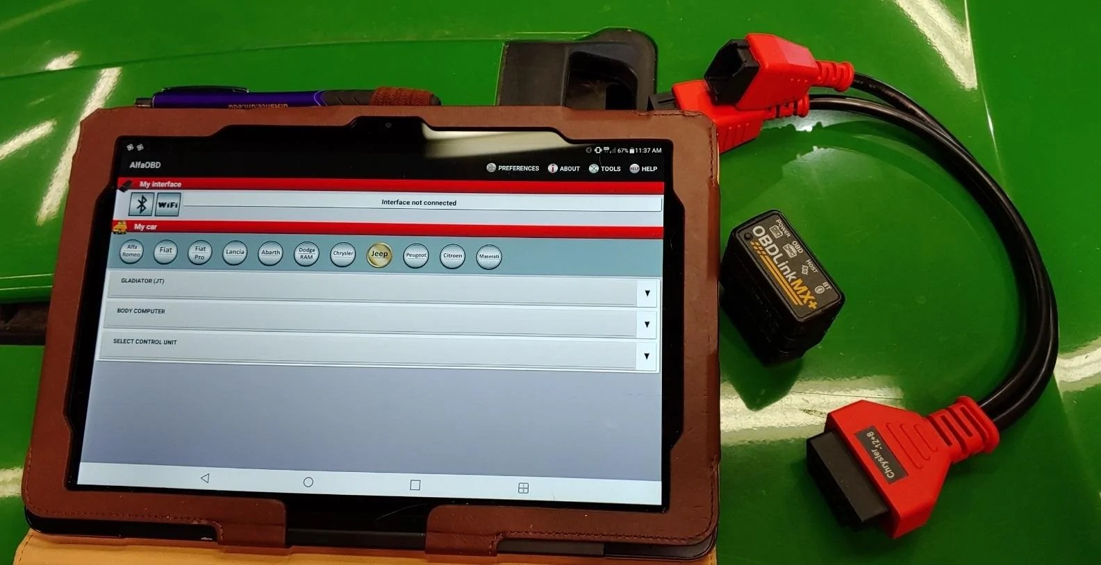

Android - and I have an LG tablet with AlfaOBD on it. I prefer using a tablet when looking for things as my eyes aren't what they were when I was 15 and reading the dates on old coins for my father - without a magnifying glass. The phone is fine for quick checks, but having a tablet with it is fantastic.
AlfaOBD is a different audience - think sports cars, Alfa-Romeo, all the Alfa stuff, Fiat and so on, a broader market, more than Ram trucks and Jeeps so it makes sense they are very current and in-depth.
Other than the tablet, it’s like my exact setup, lol. I have a smaller tablet, but it works perfectly for the setup.
40,483
53,970
Even my little Nexus would be ok for this, better than a phone. But this one makes it easy to search long lists, etc.
Now that I have the extension cables tucked up under the lower dash trim, connecting is a breeze.

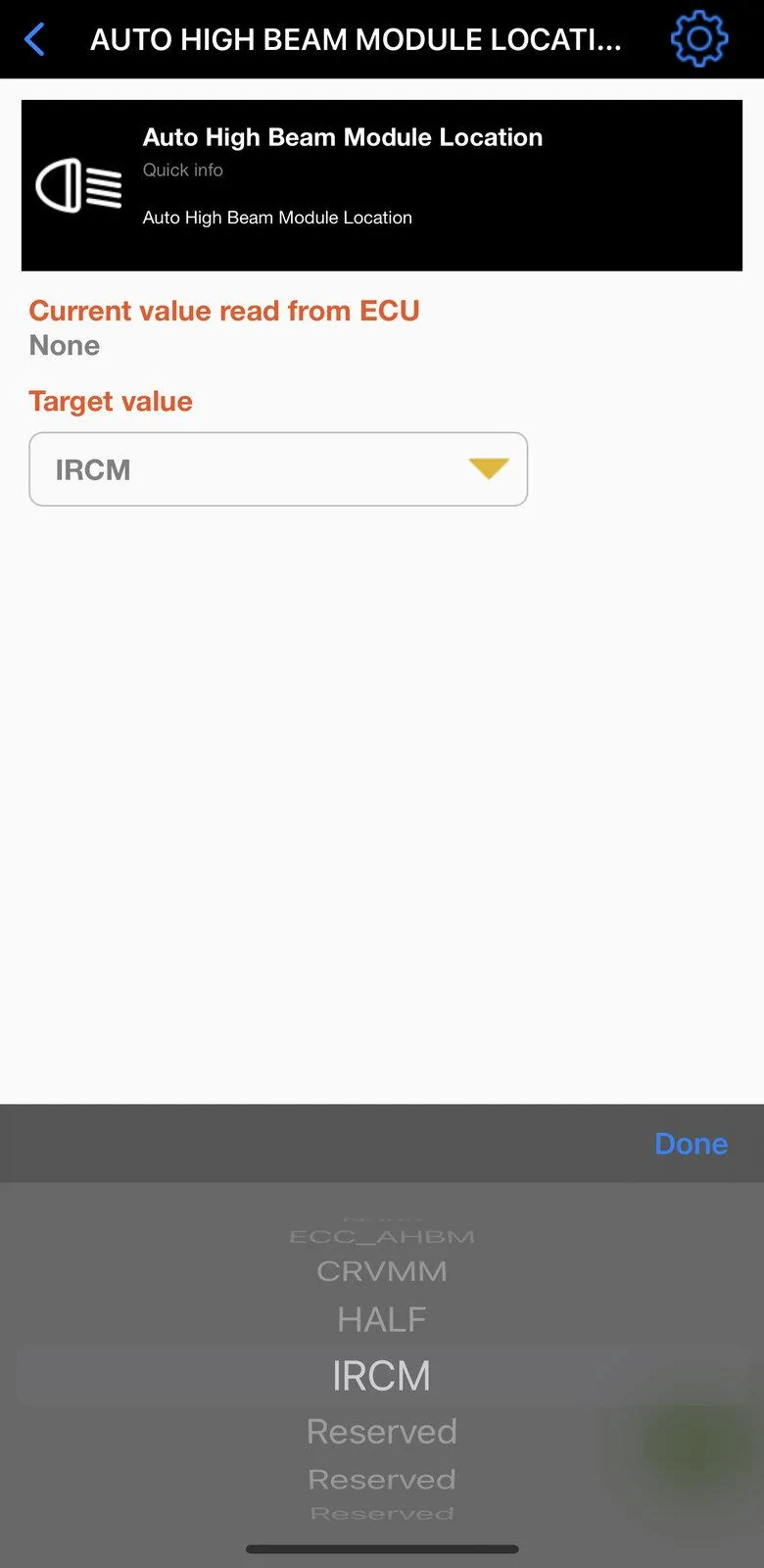

Updated info:
The one setting JScan was missing was the ability to set the sensors location to “IRCM” like AlfaOBD can do. I reached out to them about it a few months back, but they have now released the update that has this fixed, so now the IRCM setting is available. With this update, you should now be able to enable the Auto High Beams with JScan as well as AlfaOBD. This now gives us an iPhone option as well.

Updated info:
I have been working with JScan for a couple weeks on this, the new version does enable the function but the setting is still missing from the lighting settings on the radio.

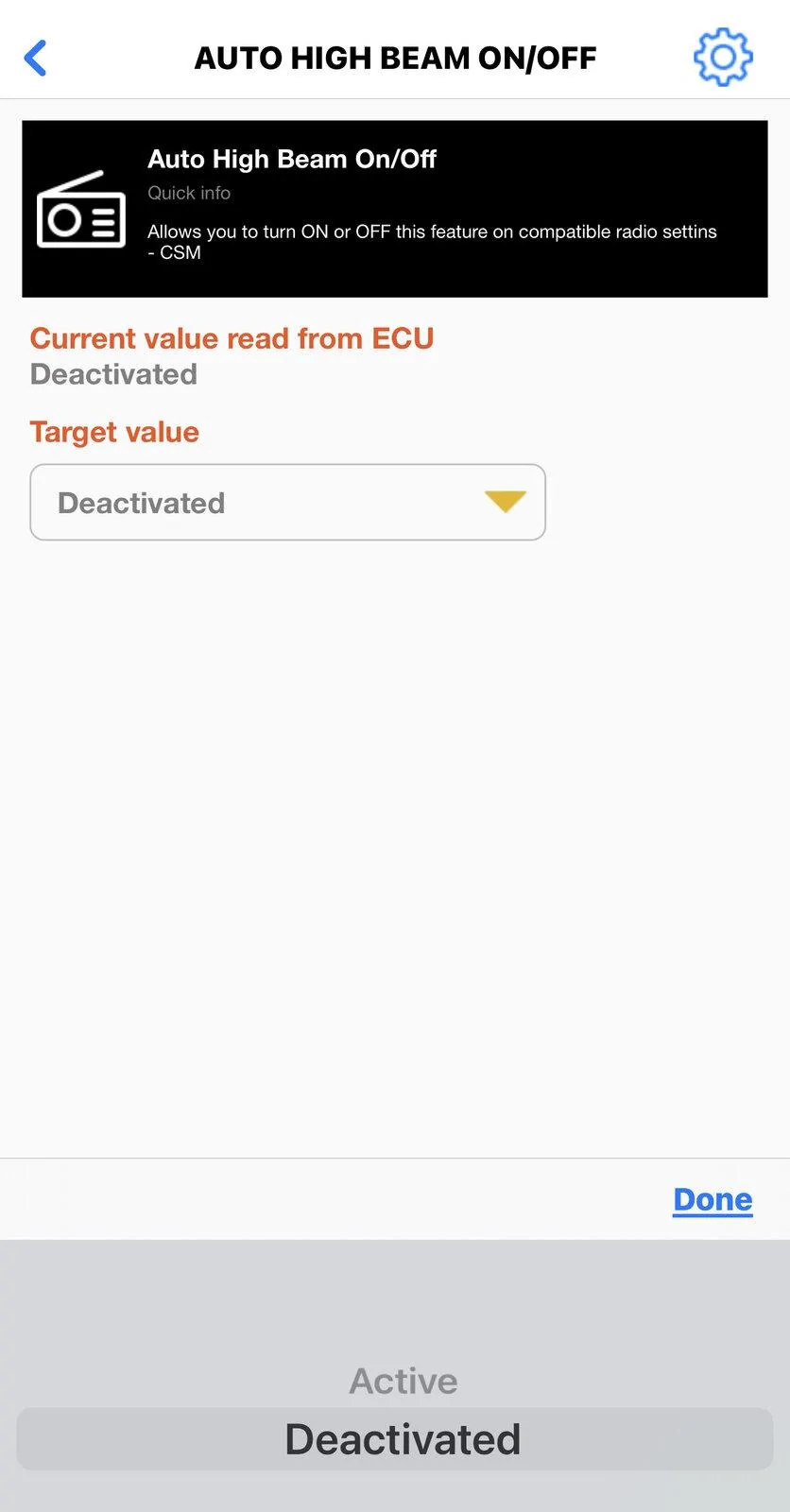

Not sure I follow. That selection IS in Jscan under JT to activate or deactivate. It’s probably a dead setting in the JT list on Jscan.

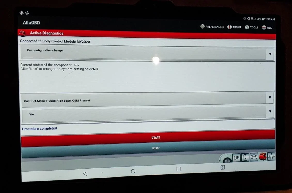

If THIS isn't present in jscan - it will never show up on the radio menu -
CustSetMenu 1: Auto High Beam CSM Present- YES
Yes, active or deactive, but is the menu setting there to make it show in the settings menu on the radio?

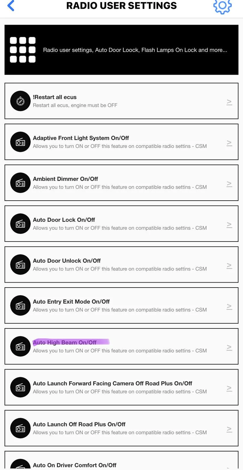

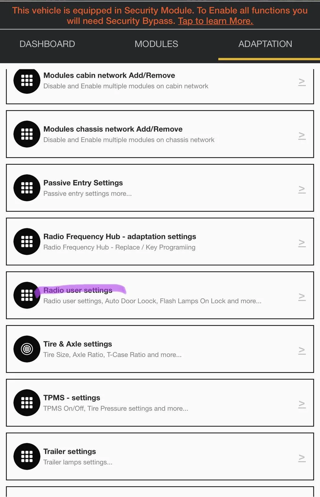

Ok- Jscan and AlfaOBD name the settings differently (a little more user friendly for Jscan), but they are changing the exact same message IDs in the BCM. Jscan doesn’t use the real setting names, such as VehConfig 1, ECUConfig 1, CustSetMenu 1, etc.
The equivalent for AlfaOBD CustSetMenu 1,2,3 in Jscan would be “Radio User Settings”, and the equivalent for AlfaOBD CustSetMenu 1: Auto High Beam CSM Present in Jscan would be Radio User Settings > Auto High Beam On/Off. They both do the exact same thing.
