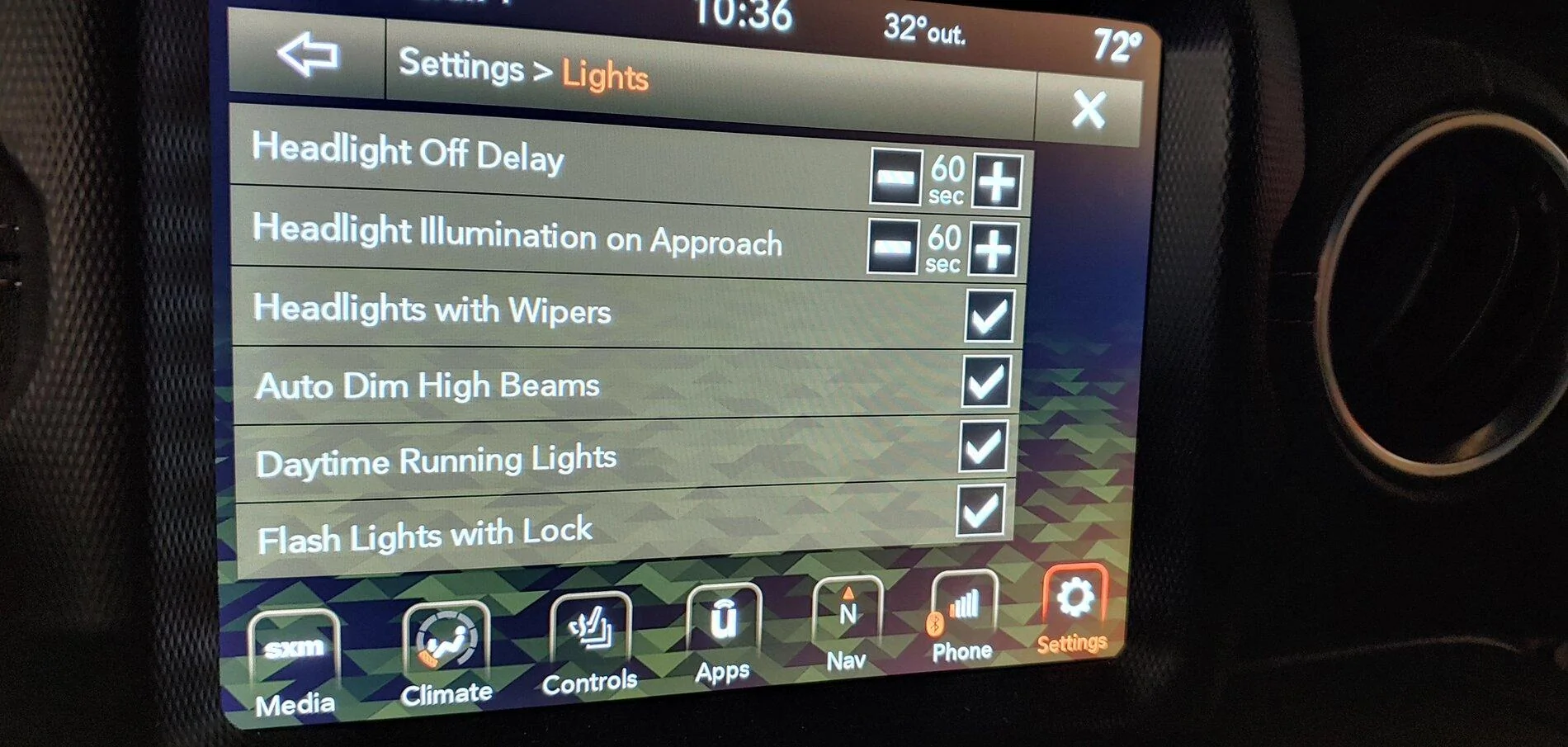

This pic shows adding the menu choice on the radio settings screen, Yes tells it this setting choice is present
If I recall the owner manual correctly, the headlight switch should be in auto position, and the TS stalk forward to high beams on. Flicking that lever again to change to low beams will trigger a "Automatic High Beams Disabled" message, meaning that you turned it off.
This is what the "CustSetMenu 1: Auto High Beam CSM Present- YES" setting does - adds the Auto Dim High Beams menu choice. It was not there before that setting ->
Special thanks to member Jimmy07 who furnished much of the settings details

IF you have this Auto Dim High Beams [ ] in your radio settings area under "Lights" then you can turn it on in the radio.
IF you do not see this setting - checked or not - then you have to do more.........
I did NOT have this choice, so followed what I wrote in post one of this thread.
Headlight switch must be on AUTO (not in the ON position) and the dimmer switch forward on high beams for it to function.
