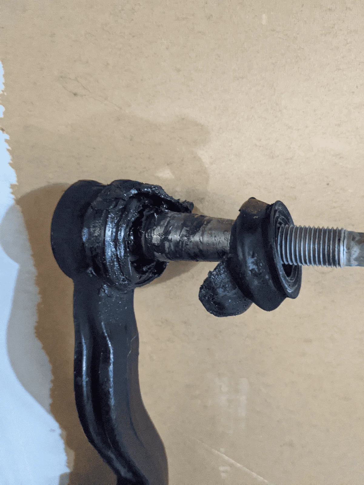

End link is smoked

My tie rod just dropped out. 20k miles.
