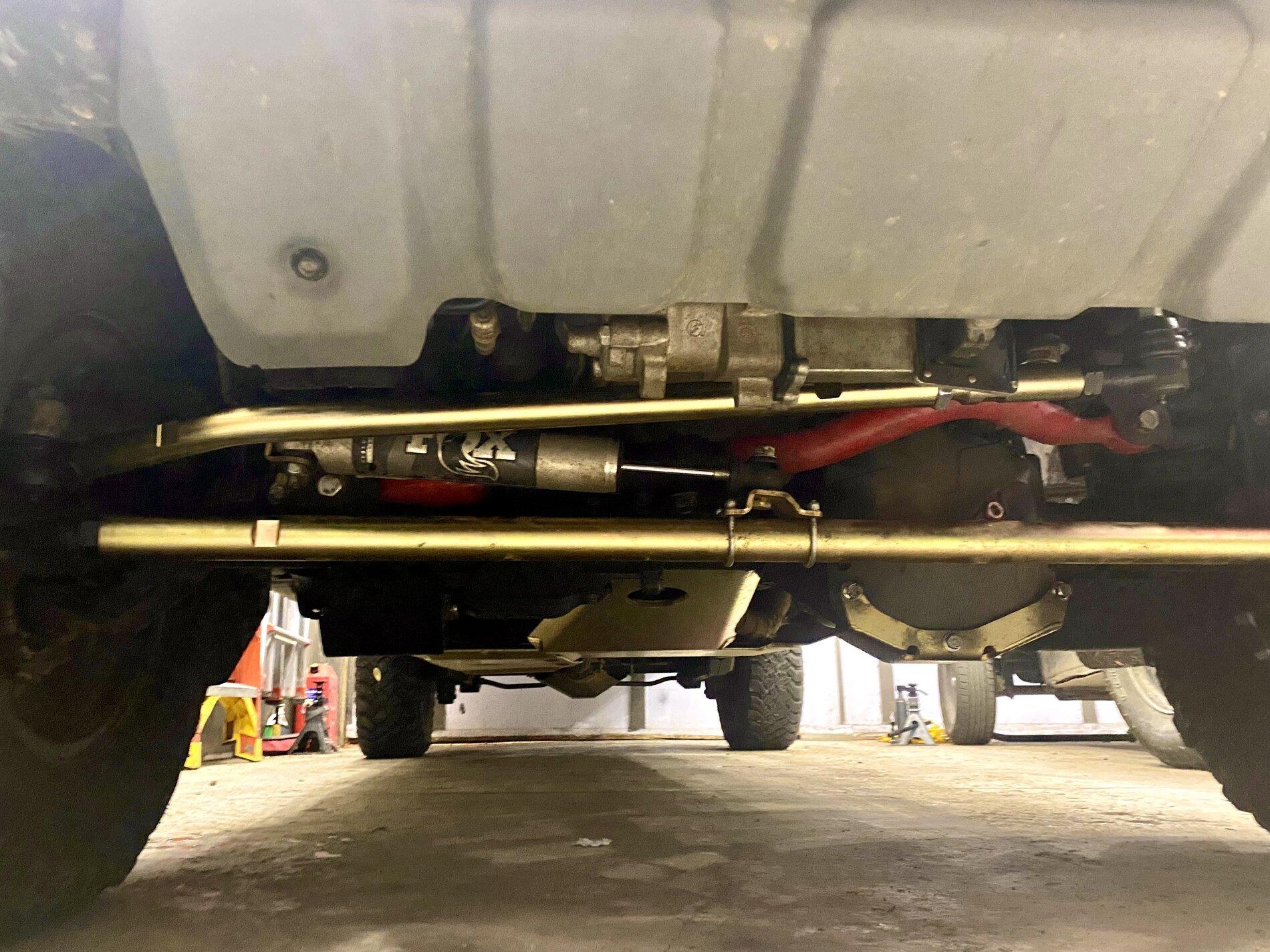

Just remember, when changing out the tie rod bar, you will need to relocate you steering stabilizer. It does not fit back into the bar the same way. Please check with the mfg’s of said replacement tie rod bars for proper application.
They make a bracket that allows for stock mounting location.

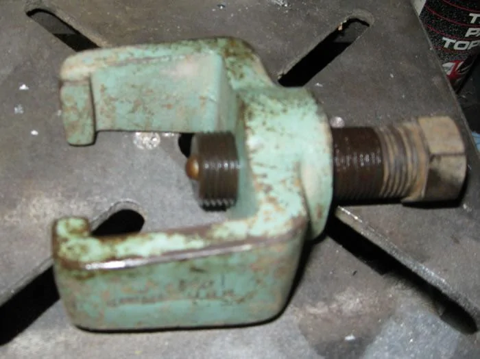

You can also use a tie rod end puller, but the one I have doesn’t fit the new larger tie rod ends. People who are new to Jeeps really don’t realize how far they have come…
I was going to comment on a tie rod puller too but didn't go through with it. For the reason you stated. Now many of the tools we have are now undersized for late models. Just as our grandparents had many neat looking S shaped wrenches and like tools. That would be hanging up on garage or shop walls to fit maybe just one bolt or nut on unknown or remembered vehicle.

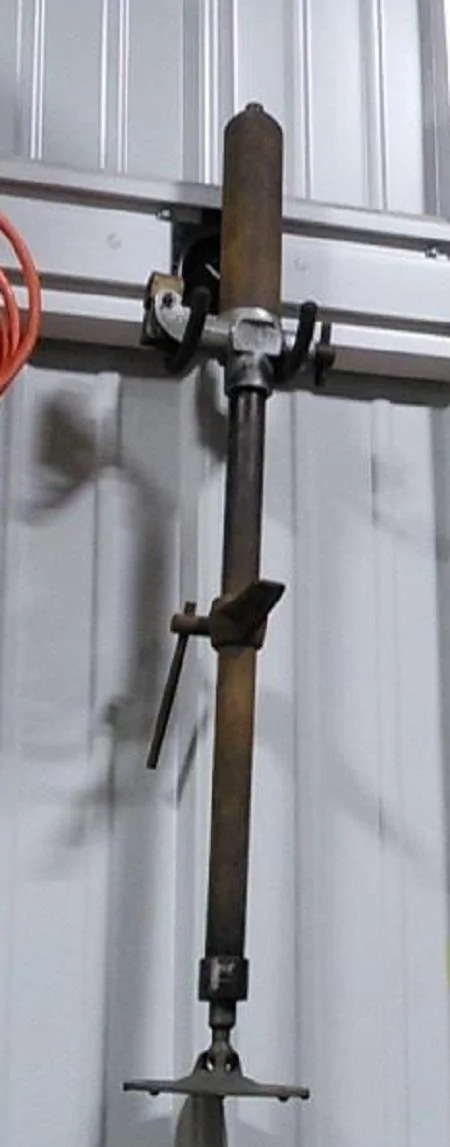

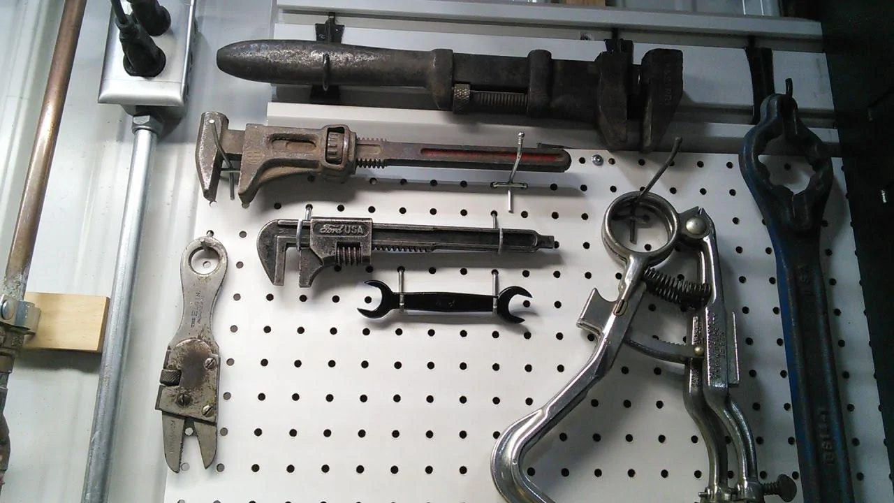

Hey, I resemble that remark...........
Top two - wrenches from railroad that later became the "Milwaukee Road" - they predate that period.
Can't find the pics of my Maytag wrenches.
