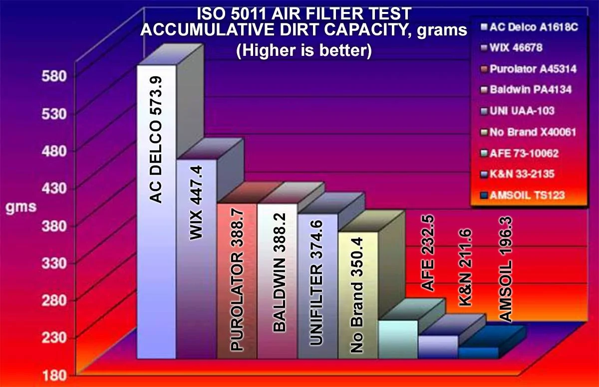

This isn't from your home made box test using flour. This is a real ISO filter test sequence.
(Project Farm also has a few things to say about these filters - they weren't fans of the K&N as I recall)
K&N restricts a lot faster (quicker to reach limits) In other words, the capacity to hold dirt is horrible -
Jeep Gladiator Engine air filters made of gold ISO5011_accumulative-capacity

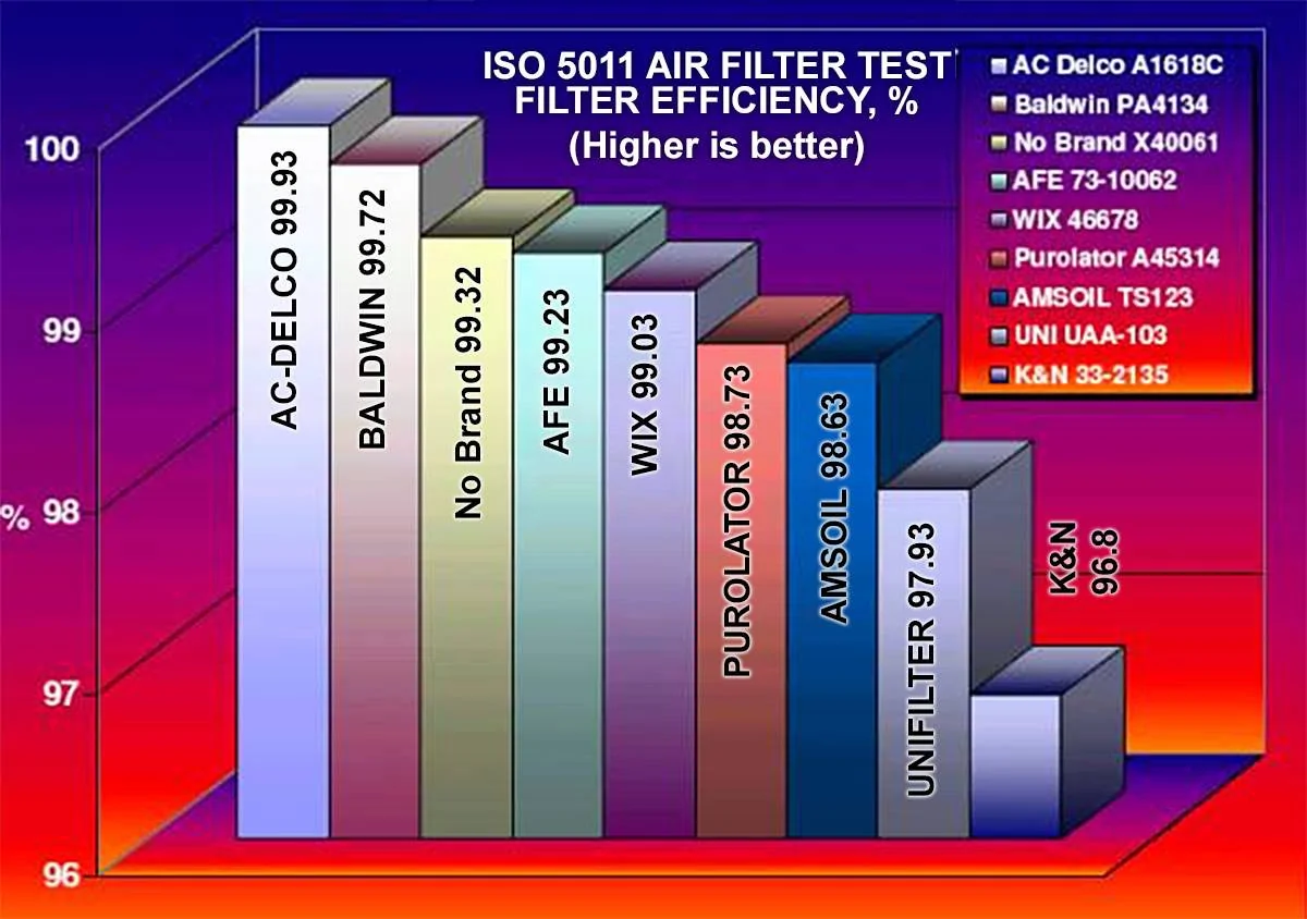

One of the least efficient filters out there -
Jeep Gladiator Engine air filters made of gold ISO5011-efficiency

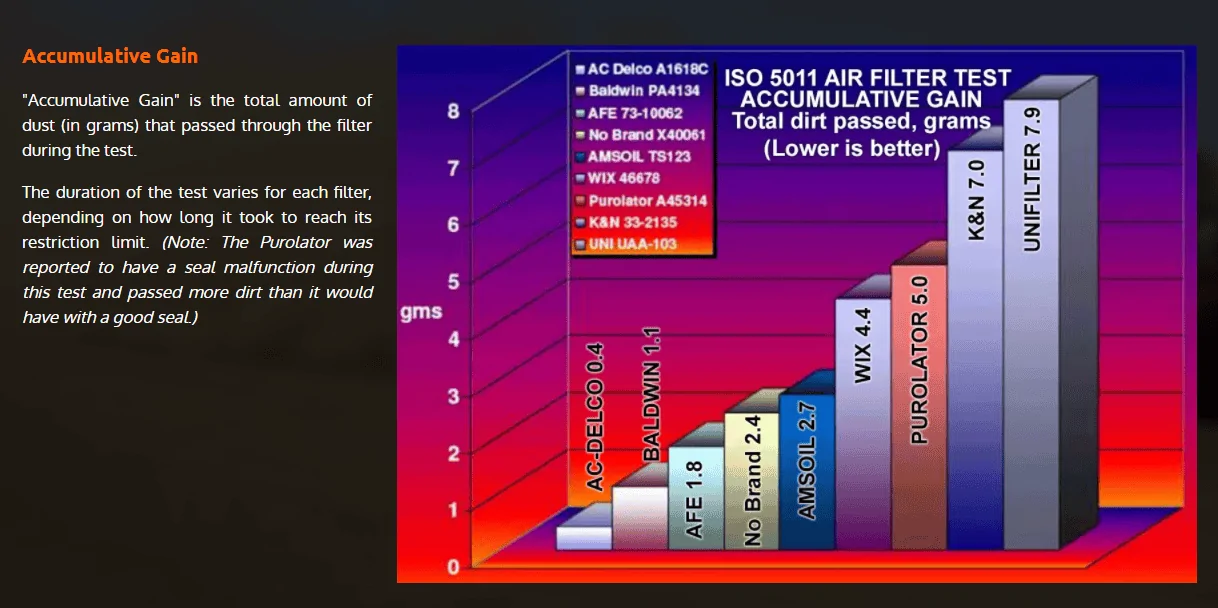

They pass a lot more dirt during their useful life -
Jeep Gladiator Engine air filters made of gold total-dirt-passed

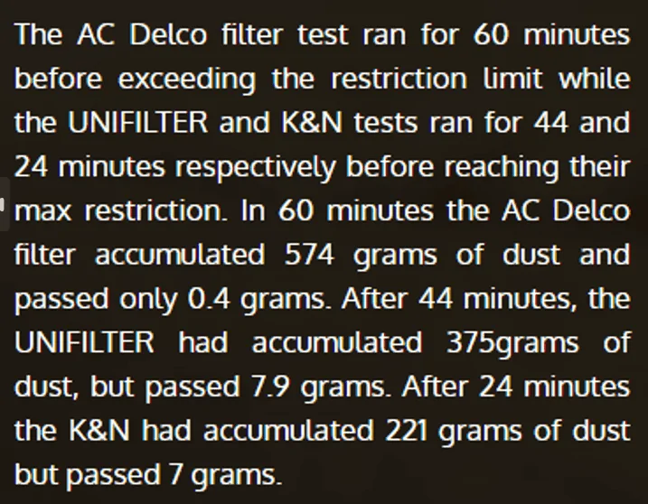

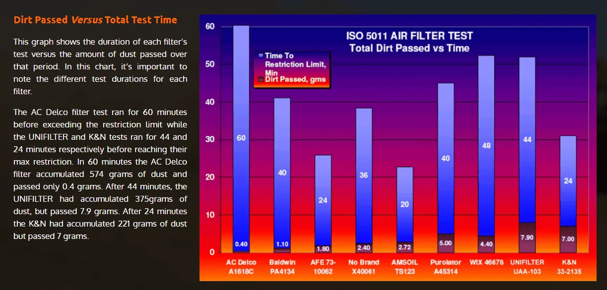

And read the TEXT with this one - the AC filter ran for 60 minutes before reaching capacity and passed only 0.4 grams
The K&N ran for half that time before reaching capacity and passed 7 grams
Jeep Gladiator Engine air filters made of gold total-dirt-passed-2
