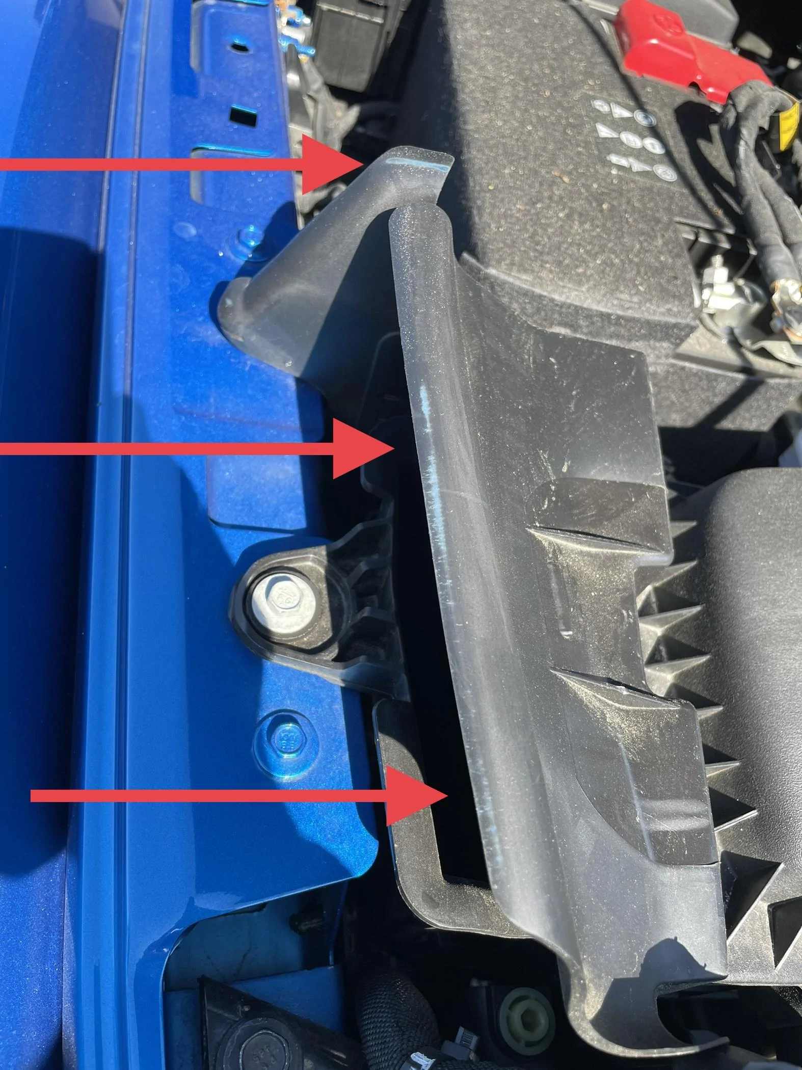

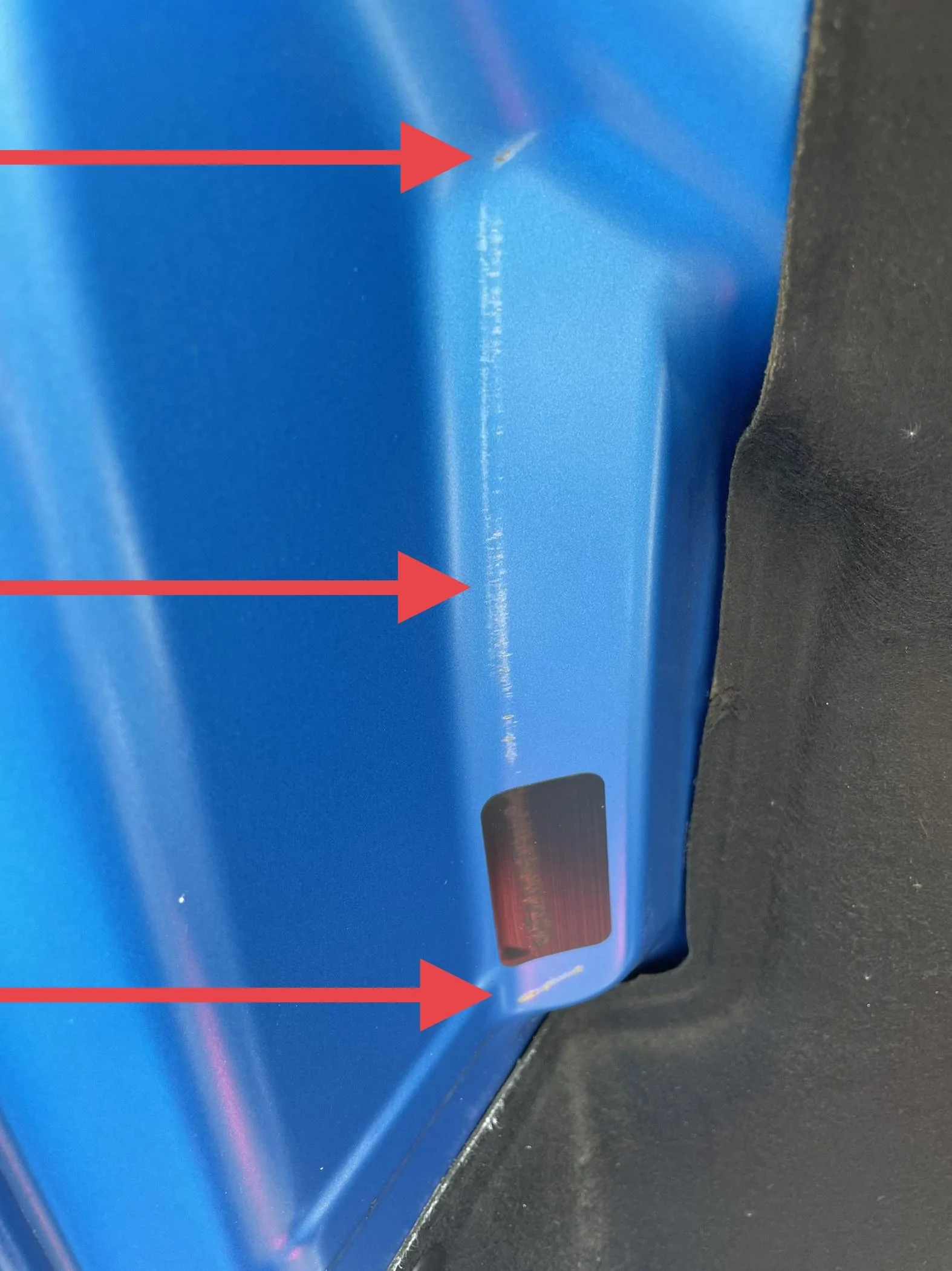

Here are the shots, they had the right idea, but the tape was too short.
Mine's like that too. I had them repaint under warranty. Still. It's just going to do it again though.

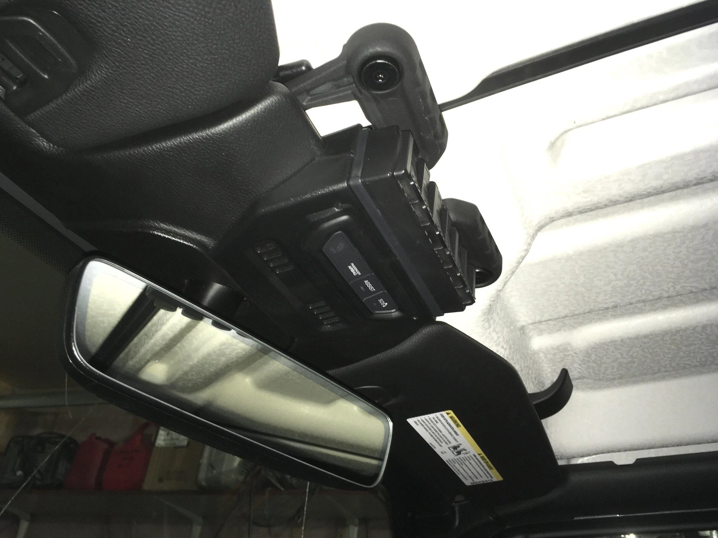

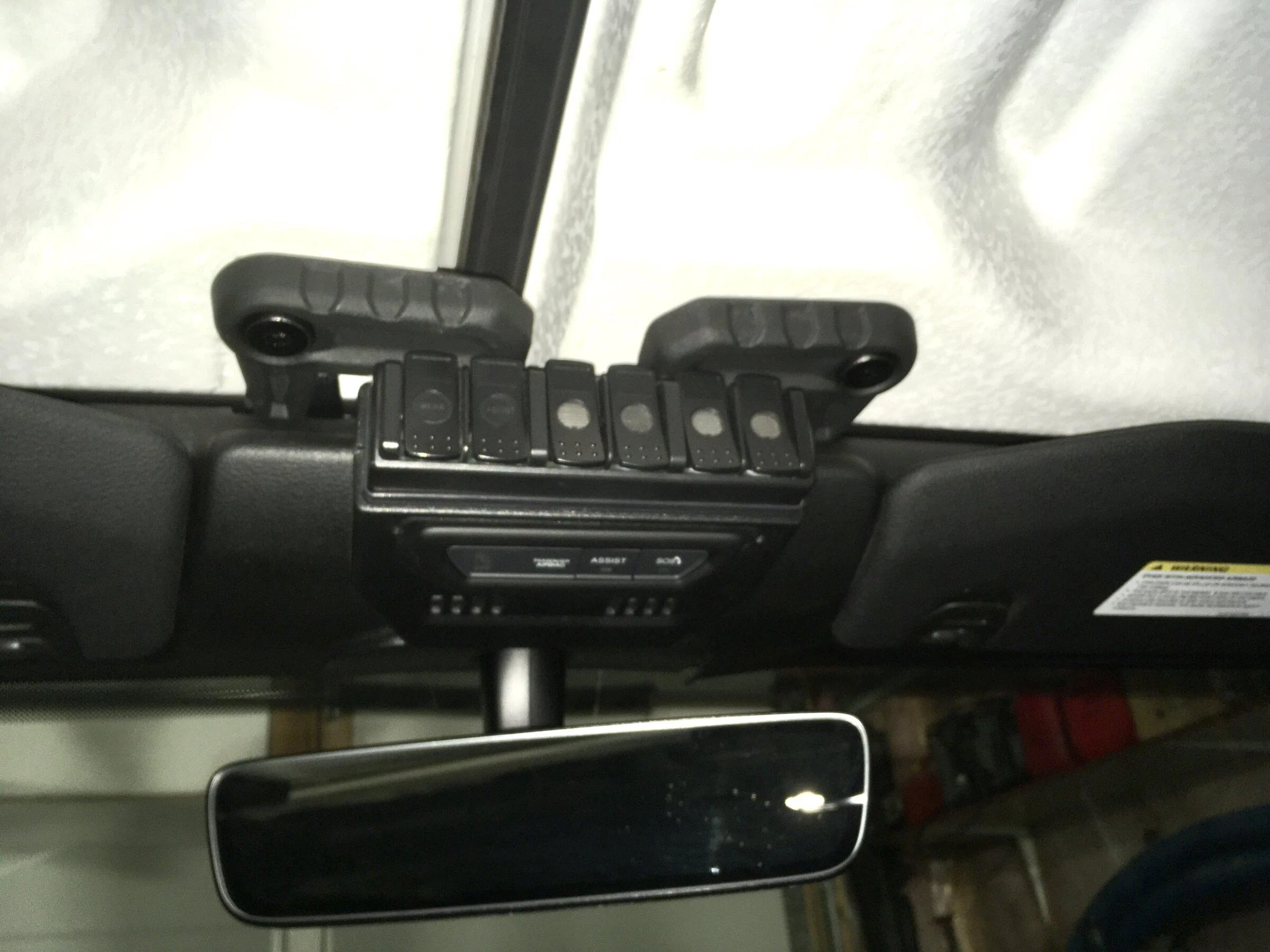

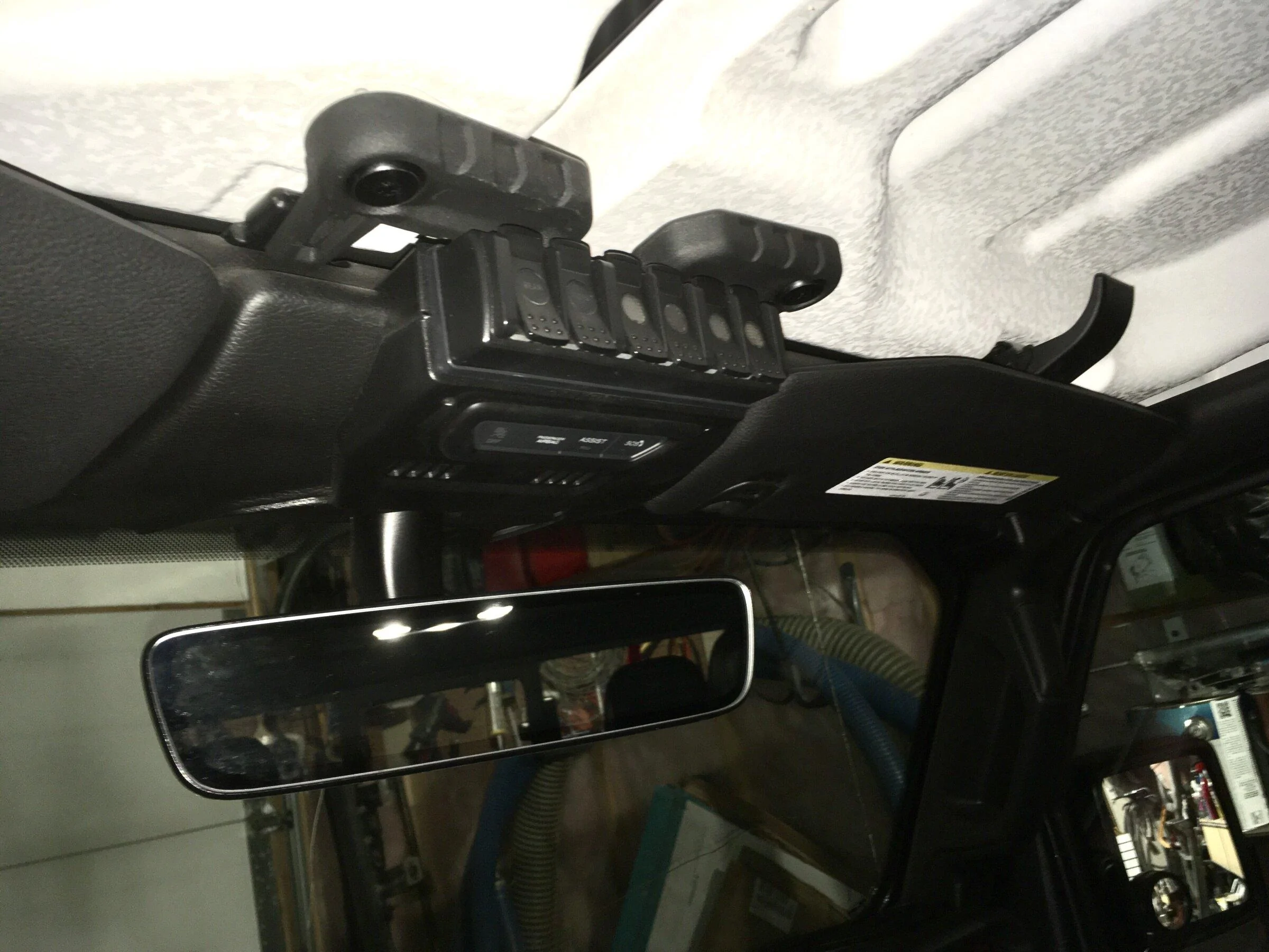

How do you like the trigger 6? What mount did you go for in the cabin?
Here’s the mount. I love the Bluetooth aspect of the Trigger 6 unit. There’s only one small gauge wire running from the unit under the hood to the switch plate to activate the switches and power the lights that have a soft glow. They could be brighter. The switch panel is magnetic and can be simply removed and used off truck if you want to play with the lights sitting by the fire. The panel takes 2 quarter size batteries. The batteries don’t last long as they are on all the time just for that feature. You cant shut them off unless the truck is off. I have the unit powered only if the truck is running. It doesn’t need the batteries in the panel to function. Switches are stiff which I don’t like but they do take some usage before getting easier. I believe they can be changed out for other types but haven’t looked into that yet and won’t unless I’m extremely bored and need something to do.
I didn’t have this system in my last truck so all the wiring had to be fished through the fire wall. Not this time! All wiring stays outside.
Eesh, I don't think I would have them repaint the hood, I can see it getting fixed at the cost of broken paint edges at the hood hinge bolts. No thanks, plus as you say it will come back.
They just re-painted the underside, not the top. The engine facing side.
Yeppers, I figured that but did they remove the hood to do it?
No clue. But they didn't damage anything. No overspray, no issues resulting. if they didn't, then they marked everything off well, and prepped well.

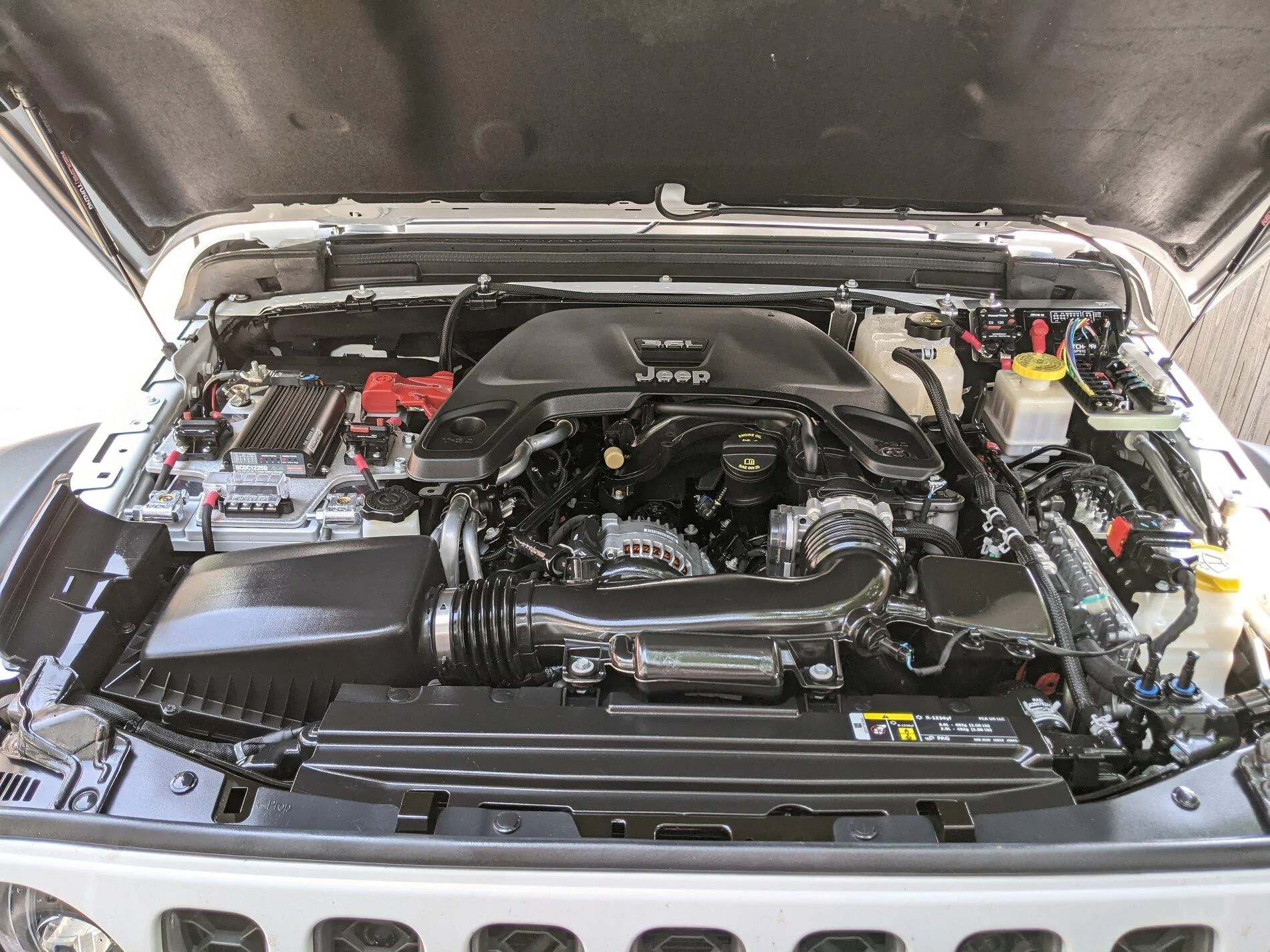

I've always been too nervous to do any type of cleaning under the hood.
I keep some of my cars spotless under the hood. I've pressure washed (although carefully), used cleaners (safe cleaners) and never had a problem.
Water won't hurt alternators as long as they don't sit wet for a day.
I've been cleaning my engine bays for decades, show cars for a few of those decades.
The key is rinse. Never leave soap or cleaners on things. Cleaners are caustic. (very high pH to break down greases and oils)
I restore auto electric, including alternators, starters and more - the trick is to let them dry, don't wash then close the hood and park it. Alternators can take it. Heck, if you'd see where they are mounted on some cars - like mine........... they get wet just driving. They are wide open, dry out fast, and there is nothing to damage if it's just water. Sand and mud are the problem.
This is a 1982 car with a 1994 engine - and it's been washed many times. You could take a white glove to most of the engine bay when I prep it for shows.
