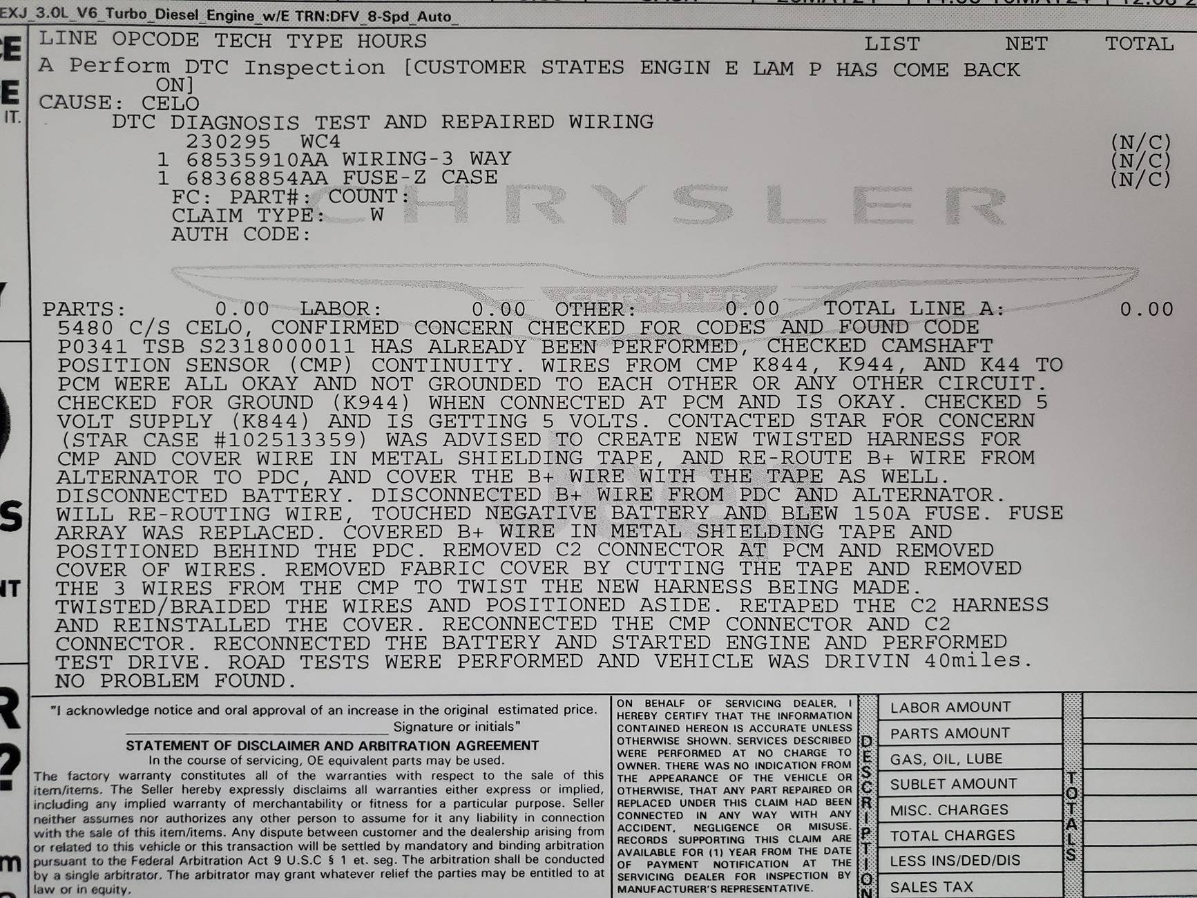

***Update 07/01/2024
Have had the vehicle back for about 3 weeks. They reran the wiring harness as mentioned above in this thread and put in a couple of twists and a shield as instructed by the manufacturer. It's running great. No issues. I've heard they suspect it's a interference issue sending bad signals. The service rep working with me truly believed it's a bad computer but so far it's holding. 🤞

@electroneye it’s been 2 more weeks. Is the code still not throwing? So it was a wrap of the wiring that fixed it? Any chance you can post exactly the write up your dealer did on the invoice so that I can share it with my dealership? I’d eveb like to get the name of your dealership and have mine call them to discuss the fix, if in fact it’s still working. Thoughts? Thanks.
Good Afternoon,
Apologies for the delay. It's running great. I'll post the work order once i get the chance to scan it. It might take a few days. I can also try to get a picture of what was done.

Asking for an update here as well. Update: David PMd me. Check engine light has not come back on. For him, this fix seems to have finally worked.
For the rest of you, David sent me the work order from his dealership; posting that now.
Jeep Gladiator Error code P0341 Camshaft position sensor ’A’ circuit range bank1 or single sensor 240724 - Jeep Receipt for potential fix to code P0341
