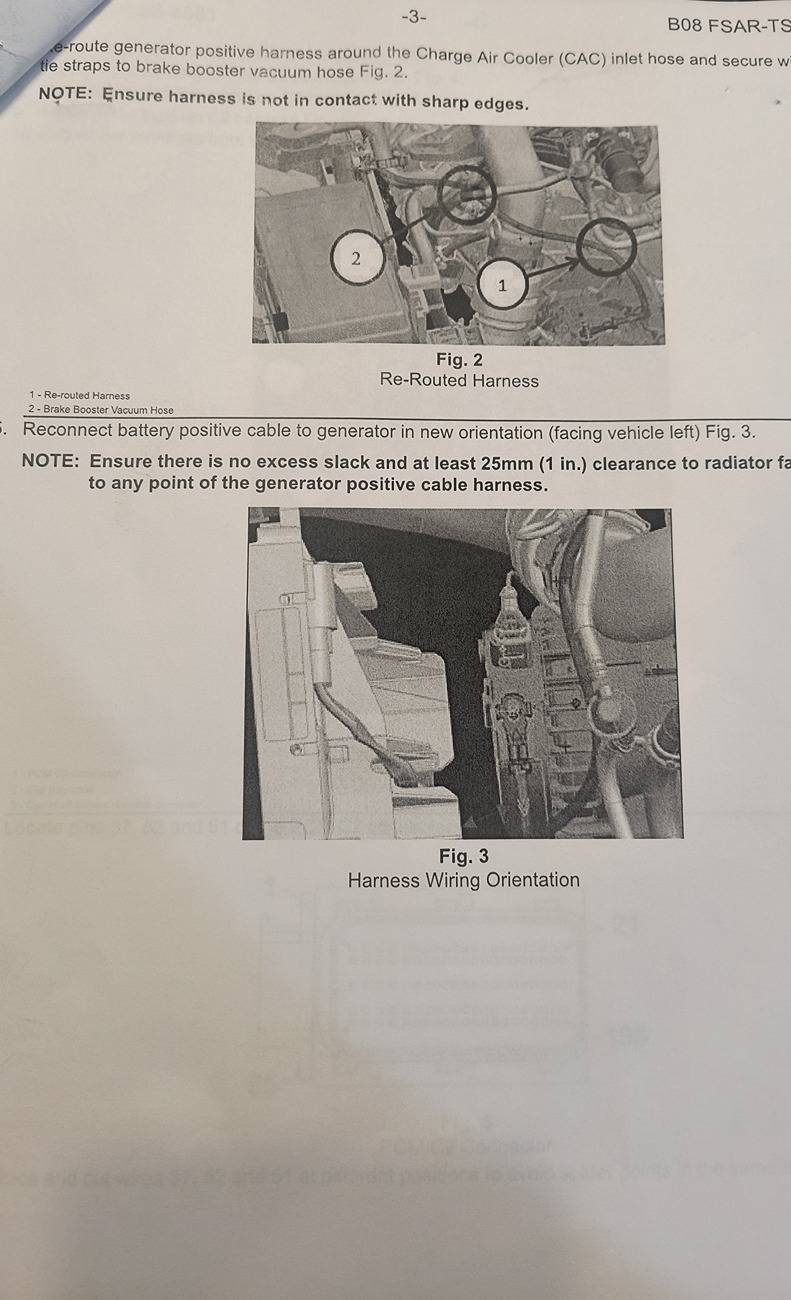

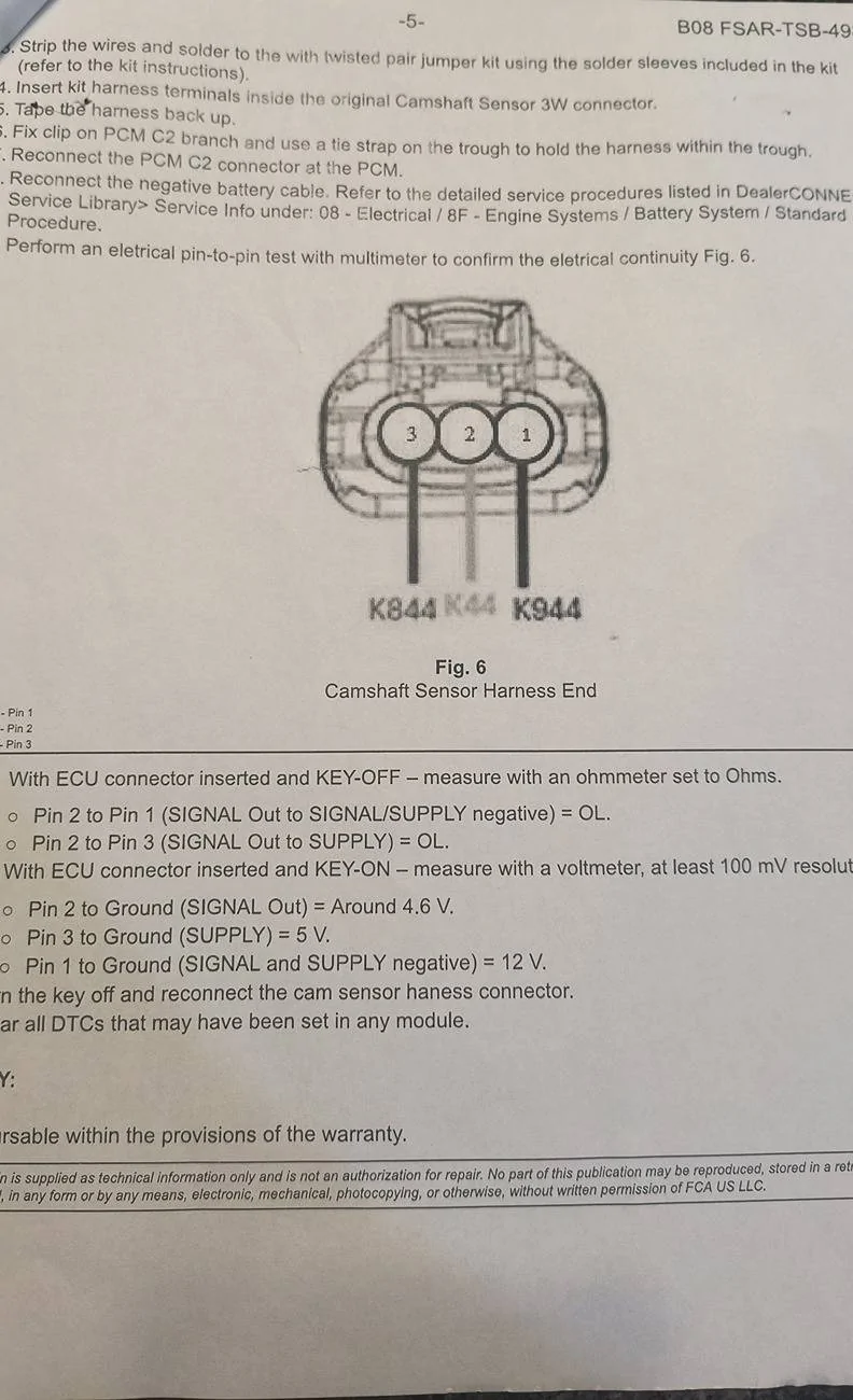

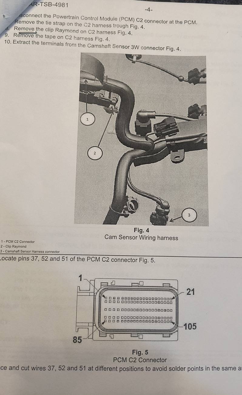

After reading about the possible fix with shielding the B+ wire, i decided to take the truck in for repair. By that time it had over 8k miles and a couple other recalls it needed. It took a couple trips in and the dealership keeping it 5 weeks total, but they finally listened when I showed them the information from other dealerships on here. Stelantis had them re-route and shield the B+ wire from the alternator, and twist the camshaft sensor wires and shield them as well. The truck has been flawless since.

Gentlemen: The official TSB was issued 18 days ago (see attached). The fix is official!! It took 2 years to get here. And my light has been off for 3 weeks now!

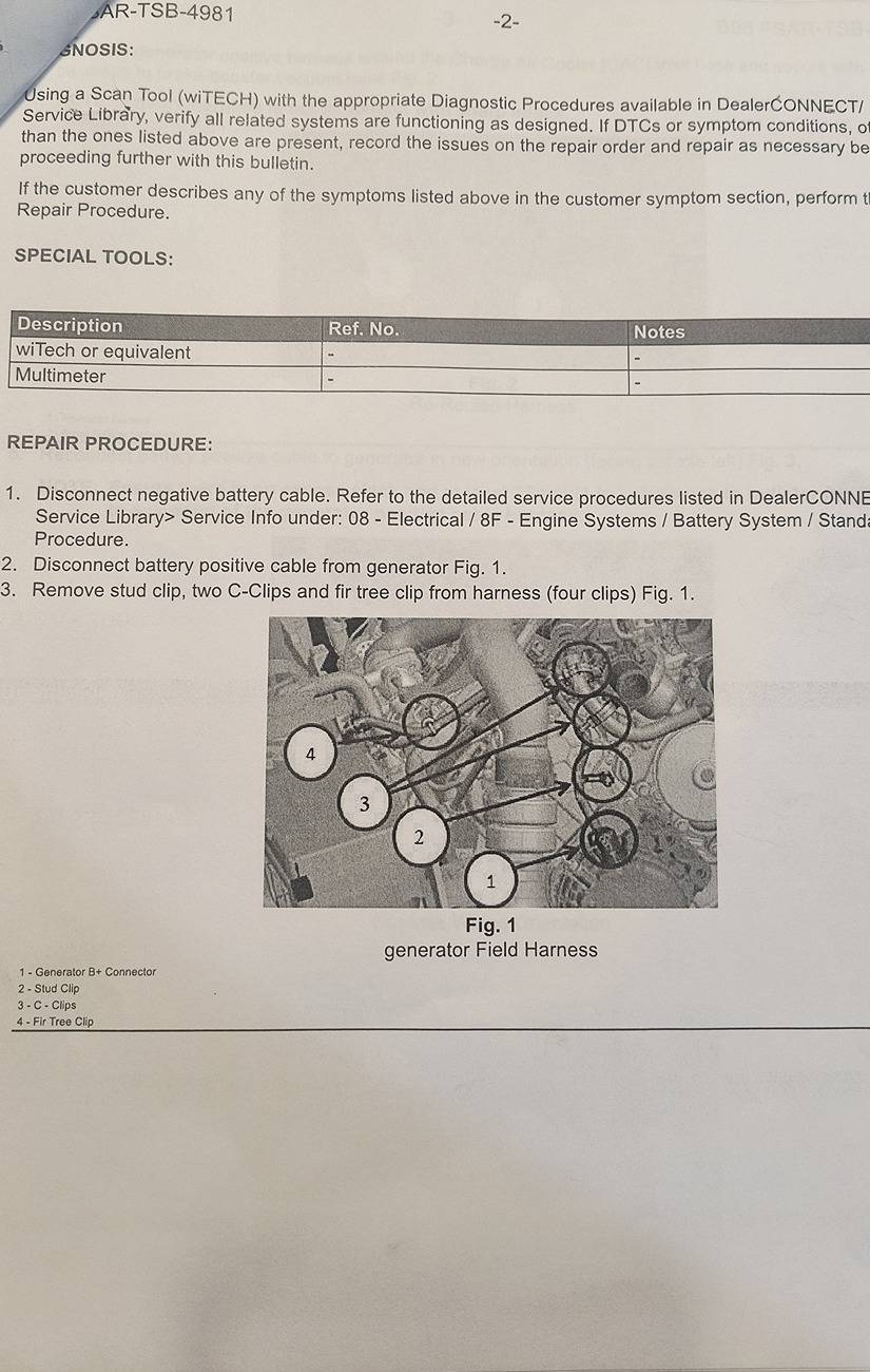

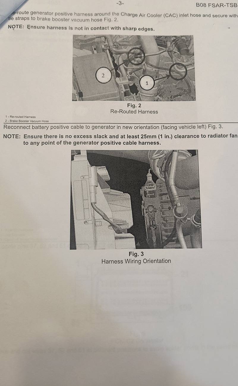

Okay I'll join the Cam sensor club! 2023 Eco diesel. Cam sensor code at 12000 Miles dealer reset and back on around 13500 reset and on again around 15000. No limp mode or running issues noticed Ordered the Cam sensor and harness and dealer installed. Here's the instructions for the repair along with the work order. Strange thing about the repair, they didn't install the sensor but only the harness with hope it fixes the issue.
