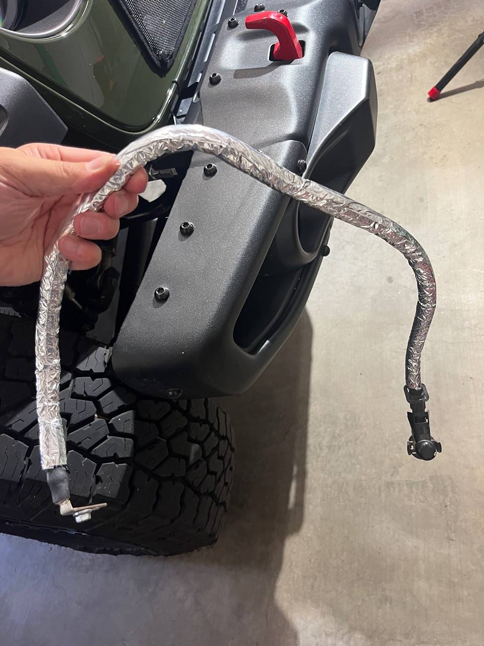

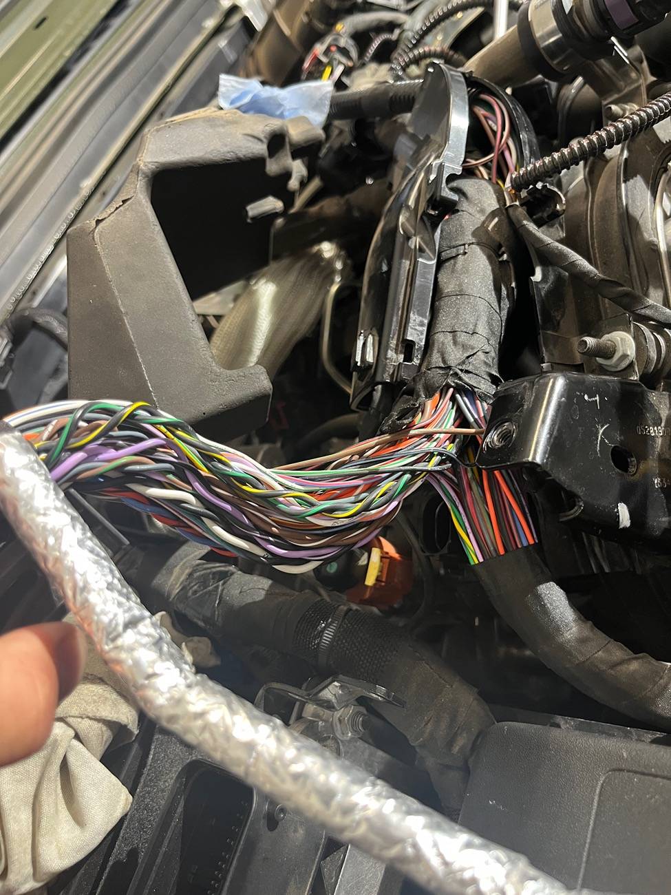

Decided to reroute and cover the cam and alternator wiring harness before having problems to hopefully keep mine trouble free.
ordered a few different sizes of this heat wrap. Pretty good stuff !
https://a.co/d/h6euDmC
will update with more photos after I finish but planning on re taping and wrapping the larger wiring harness with the heat shield as well.
Jeep Gladiator Error code P0341 Camshaft position sensor ’A’ circuit range bank1 or single sensor IMG_1293
cam sensor harness
Jeep Gladiator Error code P0341 Camshaft position sensor ’A’ circuit range bank1 or single sensor IMG_1292
Alternator
Jeep Gladiator Error code P0341 Camshaft position sensor ’A’ circuit range bank1 or single sensor IMG_1294

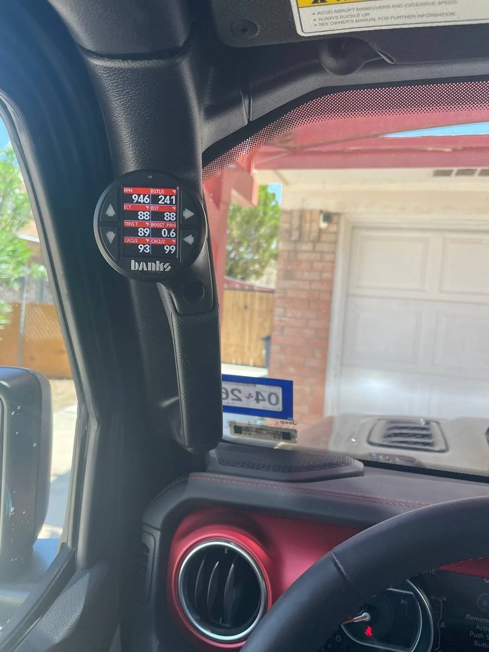

Well, I feel your pain in this, mine threw the code in the first 100 miles and then cleared itself, and it will still toss it out every now and then. It always does it at start up and I know it is going to come up because it feels like a misfire during cranking. I love the truck anyway and have no plans of getting rid of it.
My solution for it is an iDash. When the code pops up I shut the engine off and put it in run mode and clear the code and start it up and go about my day. You should get something to monitor the engine anyway, the dash doesn’t really cover all the things you need to monitor.
There are too many folks on here who have pushed the dealer to do something to fix it and clearly they don’t have a sure fix for it. At least one person on here had a dealer do a lot of mods to the wire harness and not fix the problem, they took it to another dealer who refused to work on it because of the wiring mess.
If your truck doesn’t go into limp mode I would leave it alone until there is a sure fix, or if it really bothers you get rid of it. We shouldn’t have to be put in this situation but here we are. I love my truck and will continue to deal with it as I do now.

Gregj
Thanks Greg. Mine acts the exact same way after it’s been running and then parked for a while and then at start up the code comes on. Sometimes it feels like a misfire. It will usually clear itself after 10 miles or similar or the next day at start up the CEL is cleared. I am willing to wait for a while to see if a fix is found. I find it hard to believe that they cannot find a way to shield the sensor from the heat. I have a Willys version. I was wondering if the hood had vents in it if it would stay cool enough to solve the issue. I know…wishful thinking but honestly a manufacturer can’t figure out how to shield the sensor or the wires??? Dumbfounded. By the way all those following the thread the Ram version of this engine has never had this problem. They are 90% the same engine. The Jeep version is just tuned down and in a smaller space. I had a 2018 Ram eco diesel for 5 years and 120k with no engine issues.

Also can you explain just a little more how you use the Idash. Are you just monitoring heat with it in this case? You have something else to clear the CEL code.
The Banks iDash plugs into the OBD port and reads the info on the canbus system, there are about 130 some parameters it can read and display. It can display up to 8 different values per screen and has 5 screens you can set up any way you like. It can also display user defined alerts and stores minimum and maximum values. It also can read and clear codes.
I currently have mine set up to monitor RPM, EGT, coolant temp, oil temp, trans temp, boost, charge air inlet temp and charge air outlet temp.
It can also monitor soot load and regen status. Here is a list of the things it can display.
iDash PIDS
iDash Pro
Sort of expensive but well worth it in my opinion.

Finished up this evening. Ended up using 1/4, 3/8 and 1 inch diameter heat shielding to do the wiring harnesses shown.
also wrapped the wiring with high temp fabric tape first since there where several areas of exposed wiring under the plastic cover. Was a tight fit to get the plastic cap back on but went together pretty smooth.
the cam sensor wiring are some of the smallest gauge wires in the harness and the insulation isn’t very durable on these so I could see them possibly rubbing through on tight corners mixed with the heat and vibration?
I checked all the wiring in the areas Im working on and didn’t see any signs of chafing but again can see why the service bulletin says to replace with larger gauge wire and to reroute it.
Again to clarify I didn’t have any check engine lights for the cam sensor. I just wanted to be proactive on the wiring and try to prevent mine from getting the issue.
