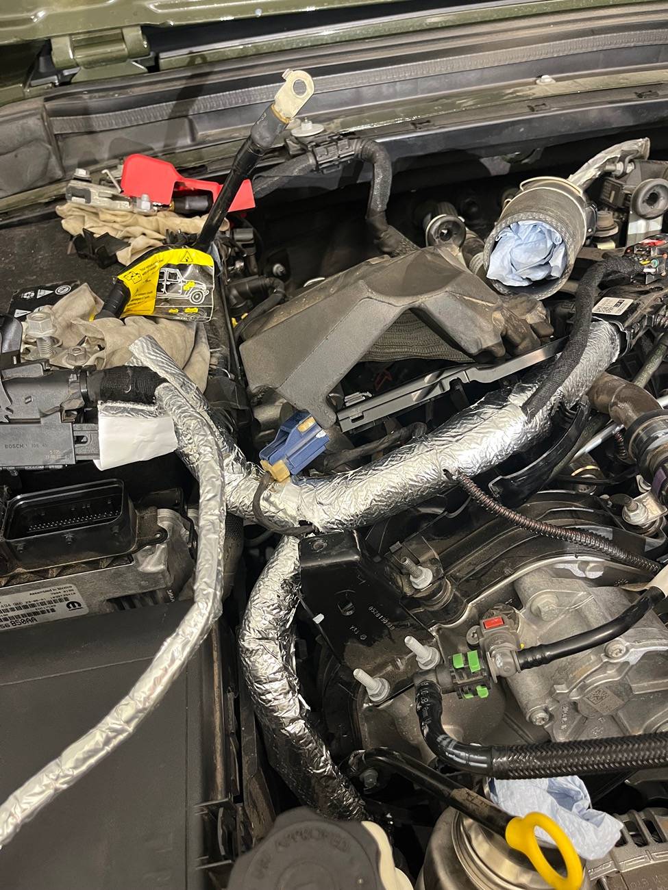

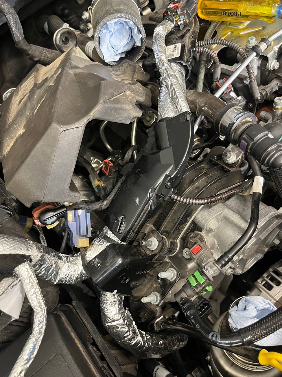

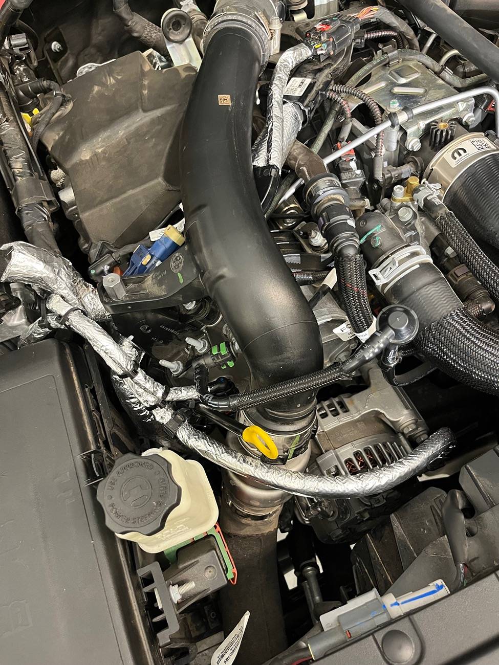

Finished up this evening. Ended up using 1/4, 3/8 and 1 inch diameter heat shielding to do the wiring harnesses shown.
https://a.co/d/0bHg8r4
https://a.co/d/dKStMzQ

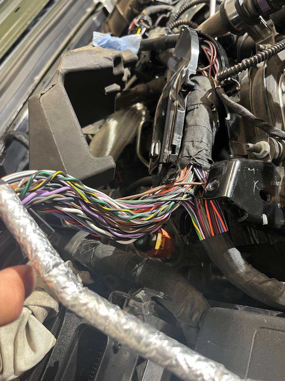

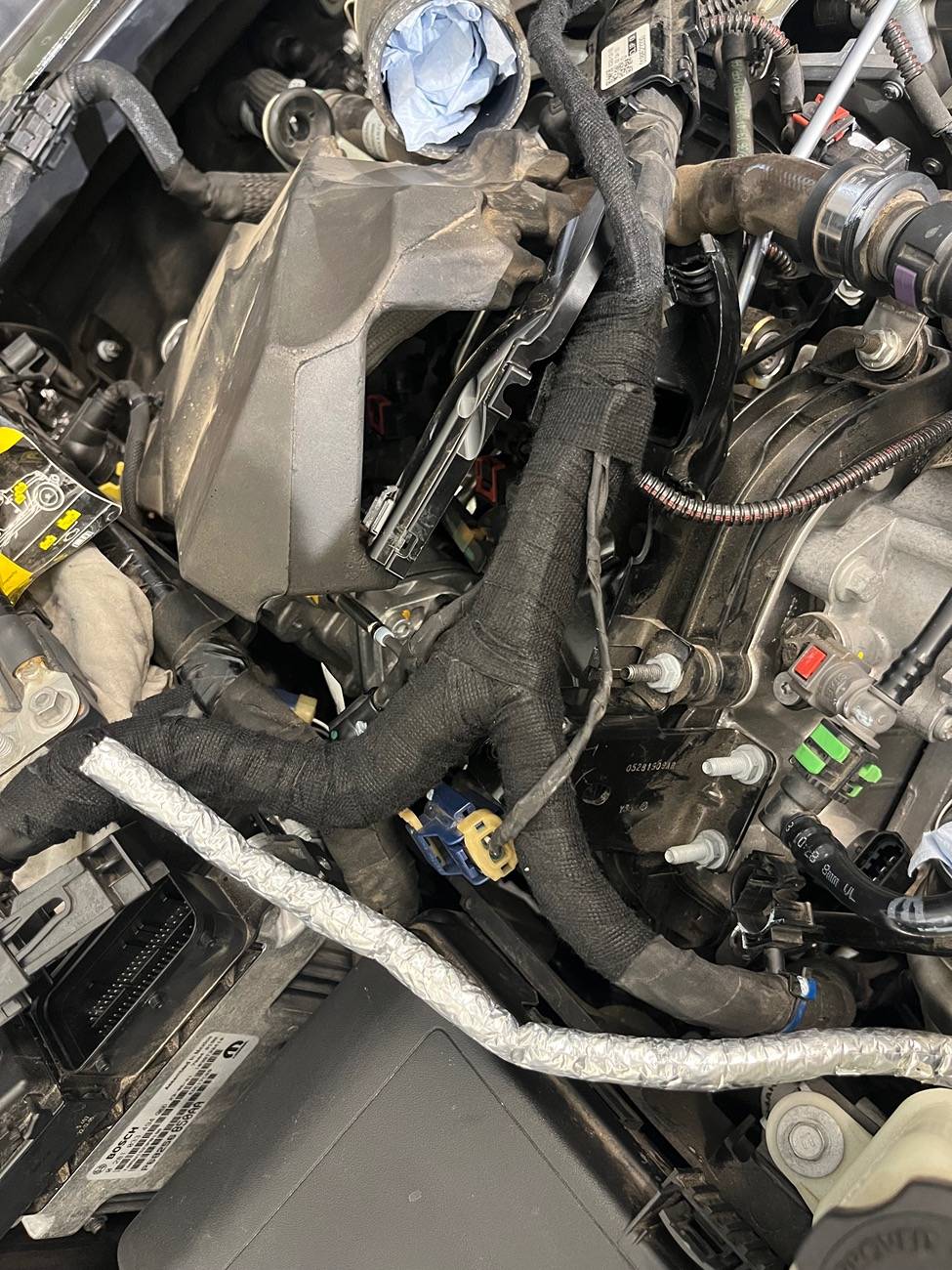

also wrapped the wiring with high temp fabric tape first since there where several areas of exposed wiring under the plastic cover. Was a tight fit to get the plastic cap back on but went together pretty smooth.
the cam sensor wiring are some of the smallest gauge wires in the harness and the insulation isn’t very durable on these so I could see them possibly rubbing through on tight corners mixed with the heat and vibration?
I checked all the wiring in the areas Im working on and didn’t see any signs of chafing but again can see why the service bulletin says to replace with larger gauge wire and to reroute it.
Again to clarify I didn’t have any check engine lights for the cam sensor. I just wanted to be proactive on the wiring and try to prevent mine from getting the issue.

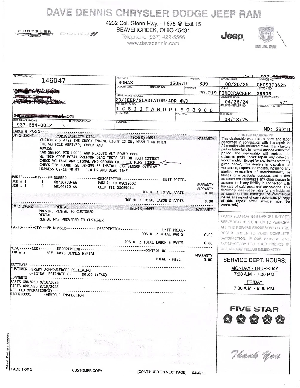

Update: As he didn't have the TSB, they didn't do EVERYTHING that they were supposed to. Part on order for almost 4 weeks now.
Bobholthaus- thanks for your pursuit and information on this potential fix. I have been following the Gladiator and Wrangler forums where you have been commenting. I also have this same issue among other issues and am curious to know if you have any more information on the fix. I think your last comment was there was a part on order early July. Have they installed it yet? I would ask you in the Wrangler forum but am waiting for approval from an administrator to comment on that forum.
bobholthaus
Bob
Apr 4, 2020
St. Louis, MO
2023 JLUR Diesel, 2014 Grand Cherokee Diesel
So the dealer did my final "fix" about a week ago; they had claimed that there was one more thing to do to "complete the TSB". And then the light went on about 3 days later. I am going to try another dealership next, and then I am going to open another case with Jeep.

Got mine back after 3 days, they did the "fix" of re-routing the wires and shielding, but they found something I haven't heard mentioned here. There were loose pins on the cam sensor wiring harness connectors (three pin connector).
That would actually better explain the problem than "electro magnetic" or "heat" because it would seem those problems would be a constant rather than intermittent if they appeared at all. Loose pins on the other hand could be quite variable and come and go depending on driving condition vibrations or even be constant. And with these parts suppliers if they shipped one defective part, they shipped a thousand or more.
Keeping my fingers crossed the loose pins were actually the problem.
