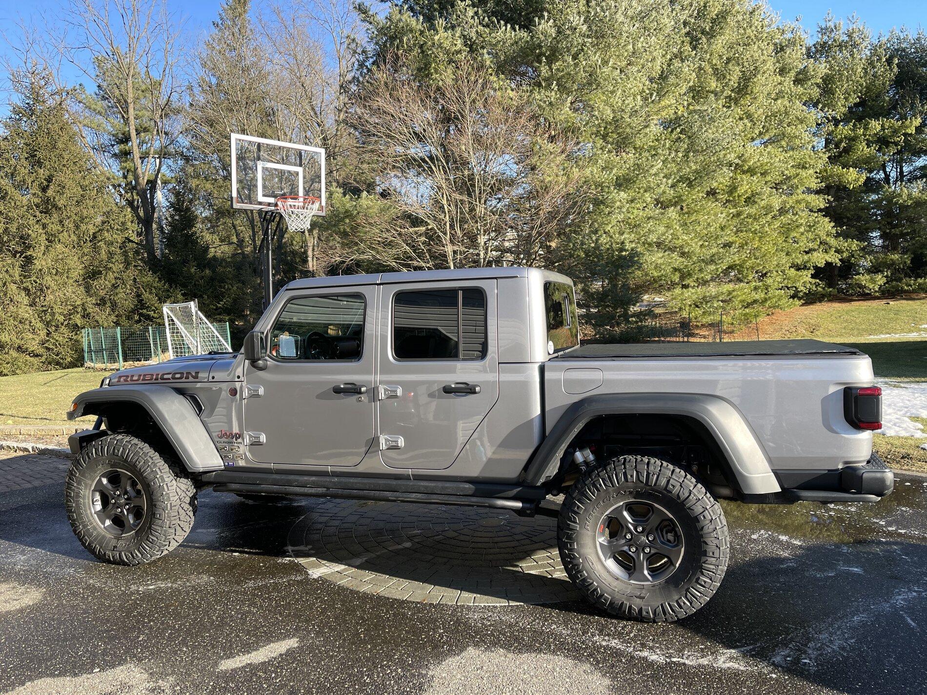

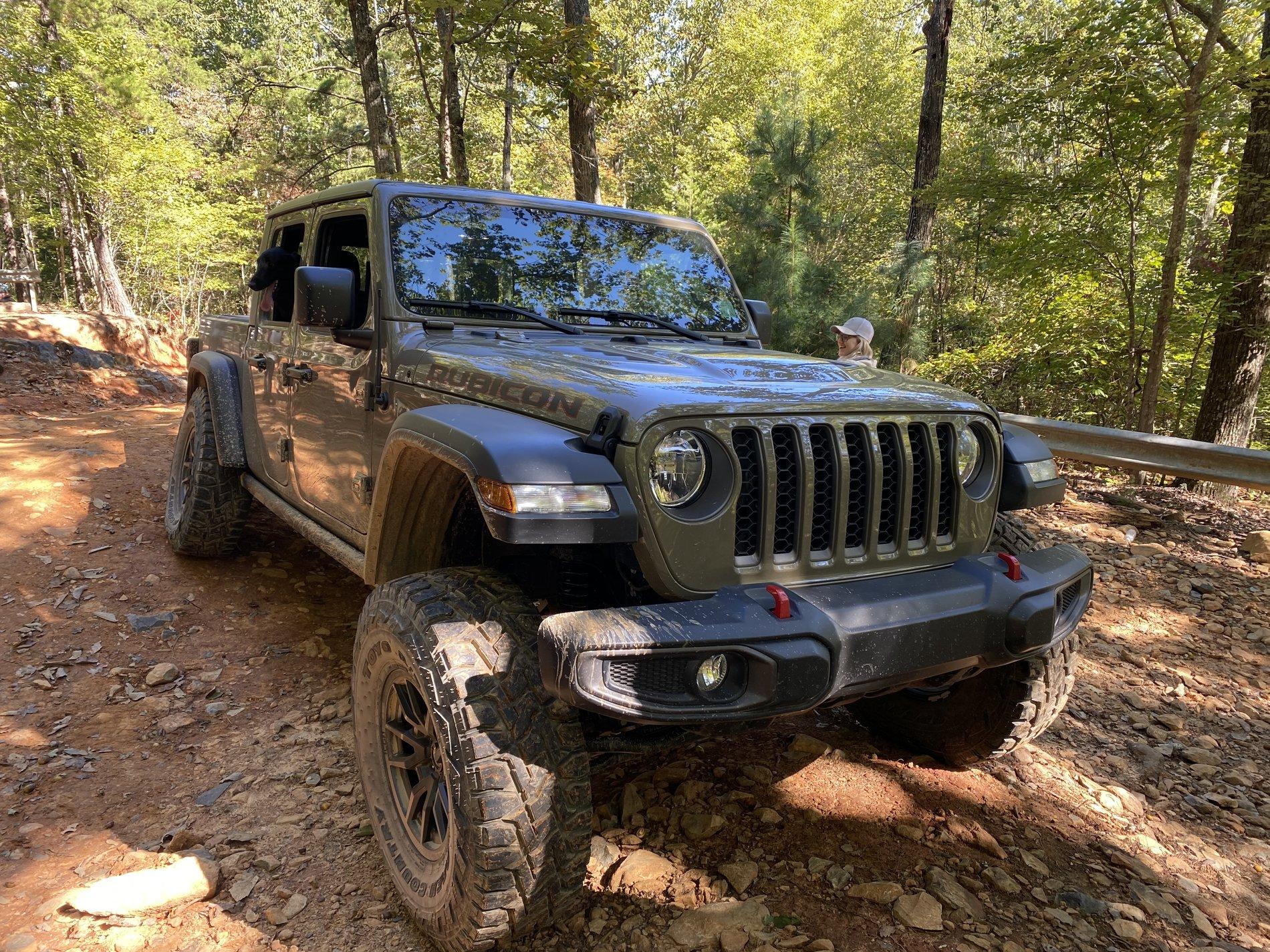

Happy to help. Have you checked out the Ridge Grapplers? They have the look and most of the functionality of the trail grapplers with a better and quieter highway ride. Here is a pic of my JTR on the 3.5” and 37s.
Jeep Gladiator Evo Enforcer 2.5 Stage 2 Installation 80608925-6D7A-4CB0-8F5A-88F06F5D48C6
Yep... that's the look I want :) 3.5" FTW :rock:! Yes, my eye is on Ridge Grapplers as well. But my rig lives in Moab and I want maximum strength on the rubber, so I am leaning more towards Trail Grapplers. But those RGs are on back order too :( My rig will be used primarily for overland style riding to cool places to camp and enjoy in southeastern Utah and western CO. It won't be a crawler and I won't have it visit places like Cliffhanger. I just want it to go through level 6 trails and below without having to worry about the scrapes I have been getting with my stock Rubi. My analysis and talking to Gladiator owners last week at Jeep Safari evinced that 3.5" + 37s is more than good enough to cover the breakover and departure angle. The look of your rig is sweet and that seems will work well on my MC lift with 37s.
Thanks for the compliment. Yes, the terrain drives the tire selection for sure. I had Trail Grapplers on a past Jeep and really liked them as well, just were a little noisier than the Ridge Grapplers. I have been happy with the angles and capabilities with the 37s and the 3.5" lift. IT will get a good test this weekend at Rausch Creek and in about a month at the TN Jeep Jamboree.
