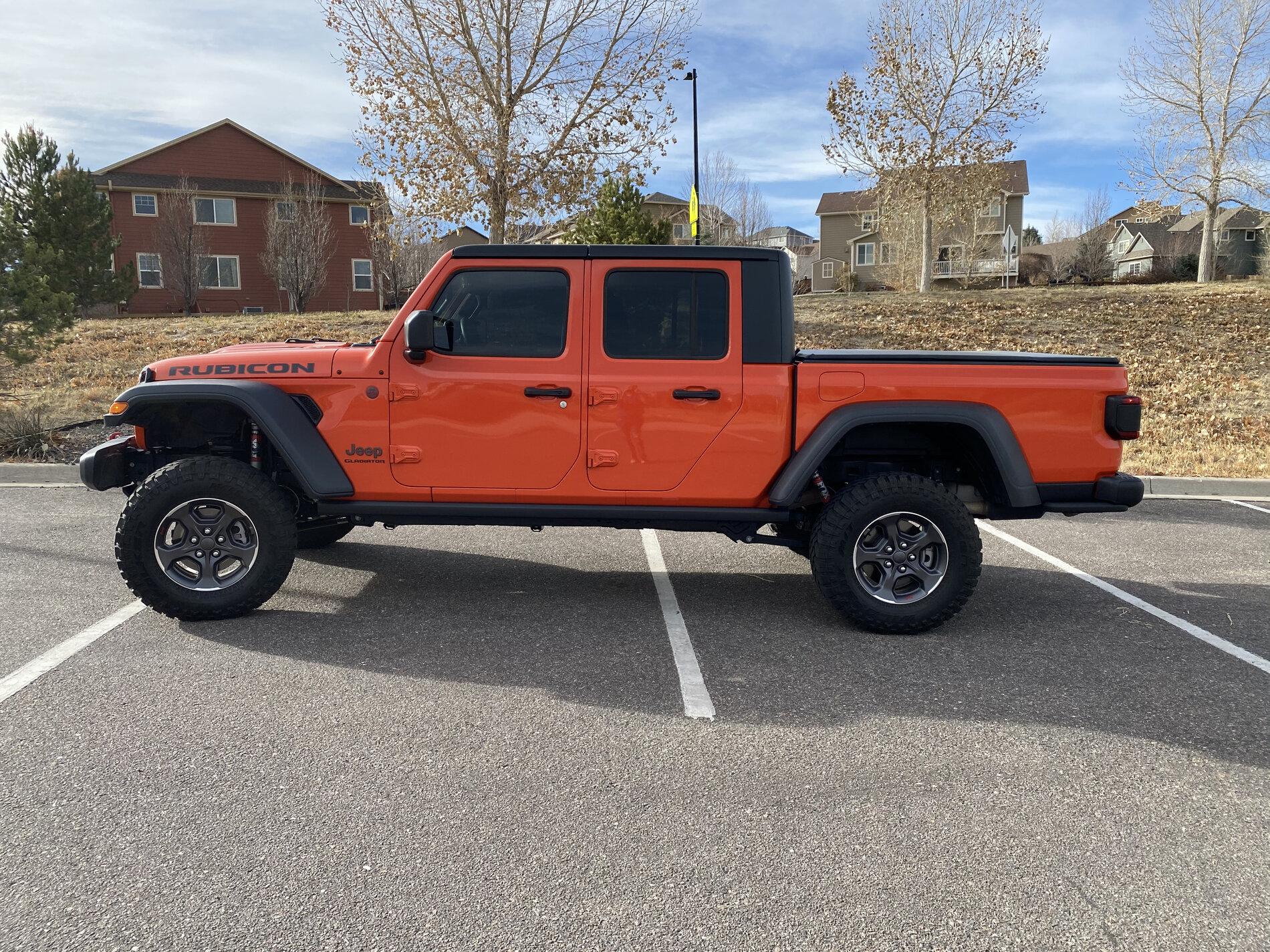

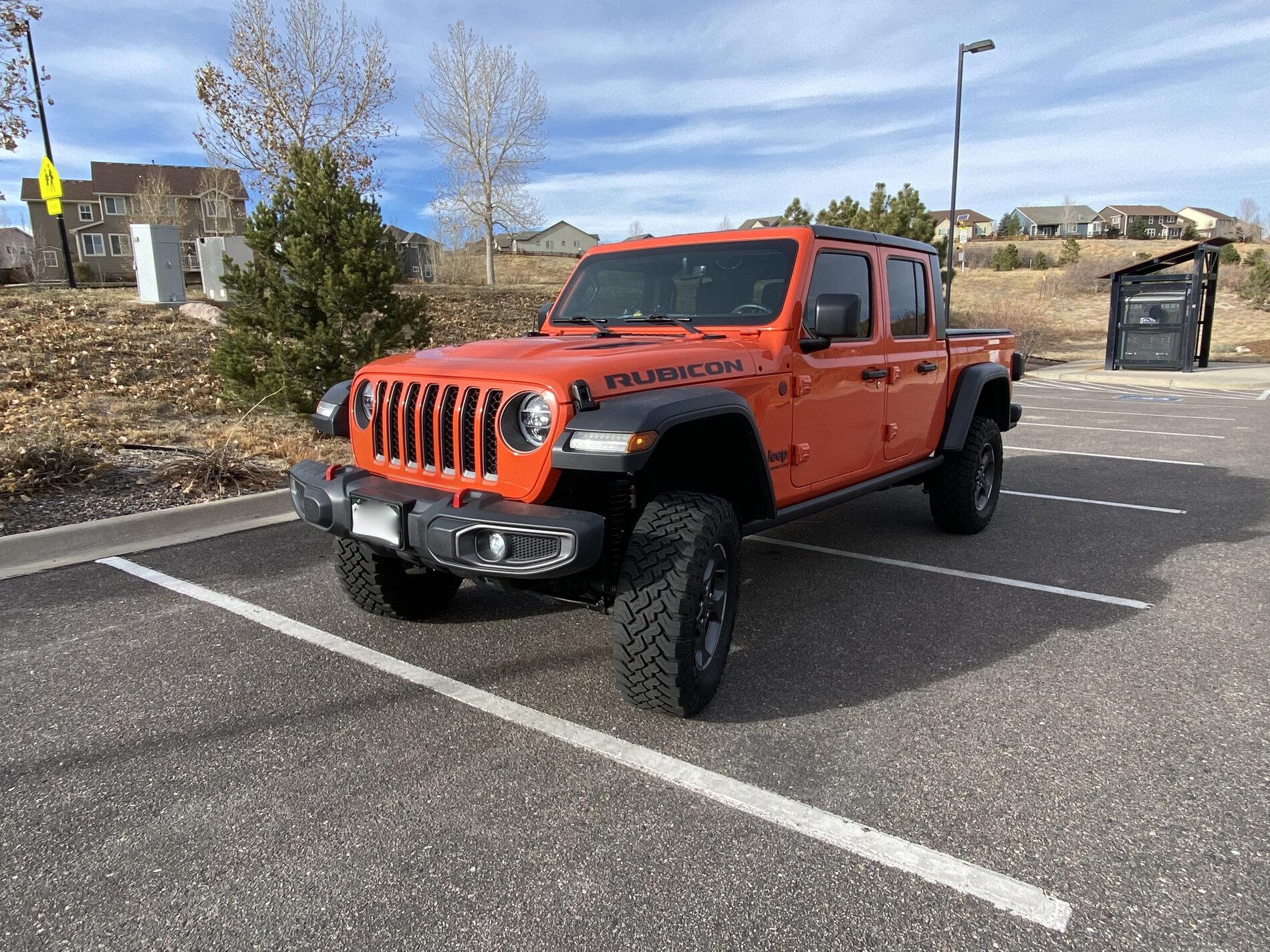

Finally complete, it looks better in person, but I'm very happy with the end result. Definitely going to be getting front and rear adjustable trackbars in the future, axles are a little more off center than I anticipated due to the additional height.
Starting Heights Floor to Fender w/ 33s:
FD: 39"
FP: 39"
RD: 39.5"
RP: 39.5"
Ending Heights Floor to Fender w/ 37s:
FD: 45"
FP: 45"
RD: 44"
RP: 44"

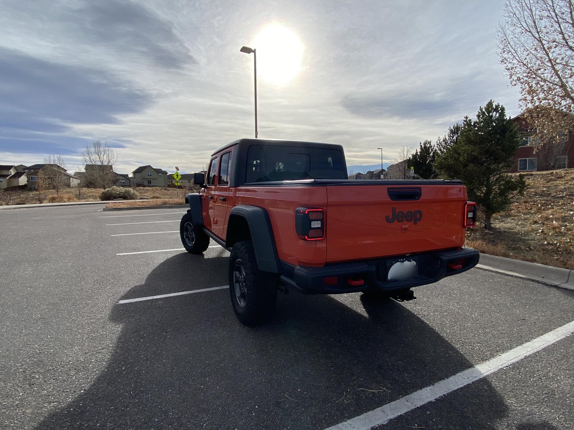

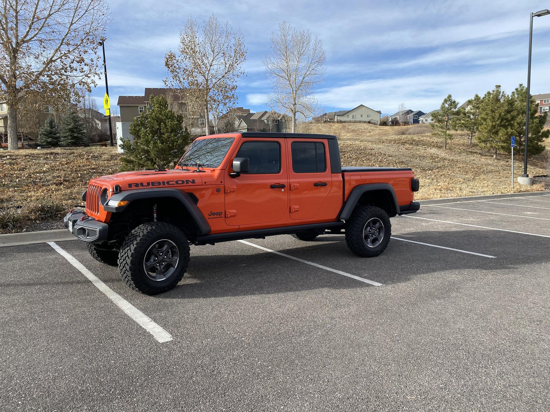

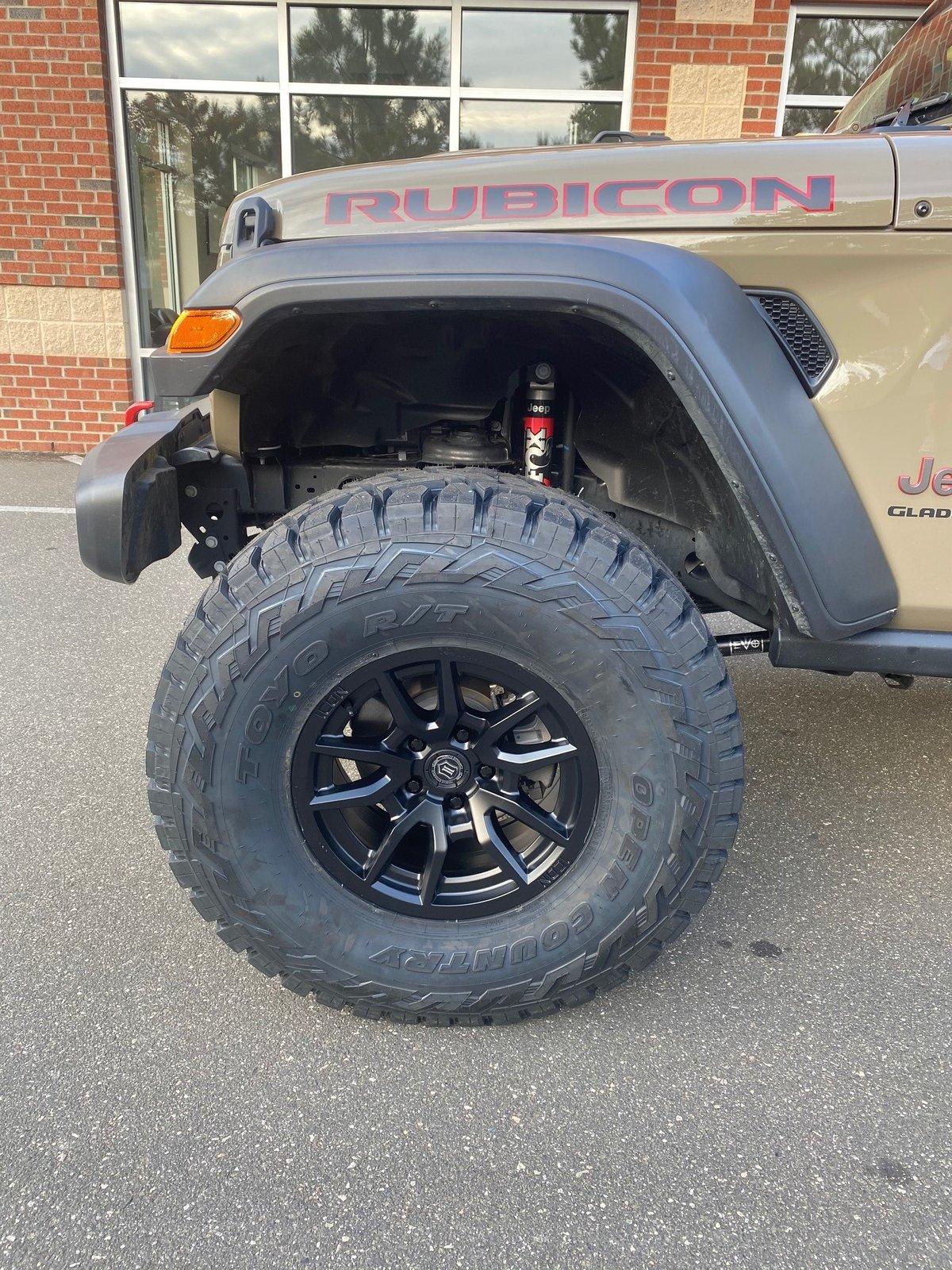

Had the EVO 2.5" Enforcer installed with Stock Shocks for now and Extensions. The front Trackbar was broke from EVO and getting a new one sent out.
Measurement - Before | After
LF 39 | 42.5 - 3.5”
LR 39.5 | 42 - 2.5
RF 39 | 42.5 - 3.5”
RR 39.5 | 42 - 2.5”
