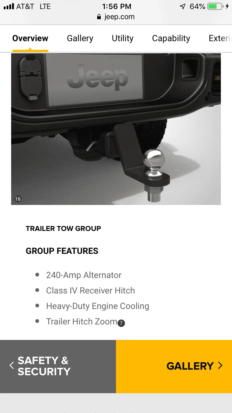

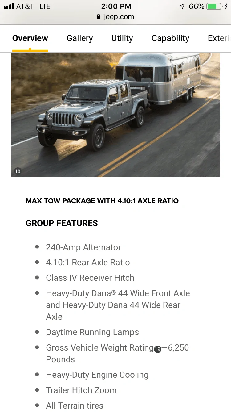

I have an Overland with the tow package and 3.73 gears. The factory tow package is supposed to come with better axles, which may affect the handling. The 4.10 gears are only available on the Sport S Max Tow and the Rubicon. Whether or not it has the Factory Tow package would be a better differentiator than the gearing.
I
No, The wider track axles are only with the 4.10 gears and not available on Overland trim. Regular Tow package adds the Equipment listed below to all trims. The Sport and Sport S can get Max Tow with wider axles and 4.10, or the regular tow group addition. Rubicon has 4.10 and wider axles stock.
I said better, not wider. I was under the impression that the Factory Tow package included better axles and brakes than the standard model, which may not be correct. I looked at my window sticker and it just shows 3.73 gears and Heavy Duty Dana 44 Axles as standard equipment.
Sorry not trying to be a jerk, just want to be correct for others, who may not know or be fed BS by ignorant salesman. Your axles are the standard D44 axles, same as what is found on the Sport and Sport S trims without the Max Tow option. The regular tow option makes no changes to the axles. Only the Max Tow option.
