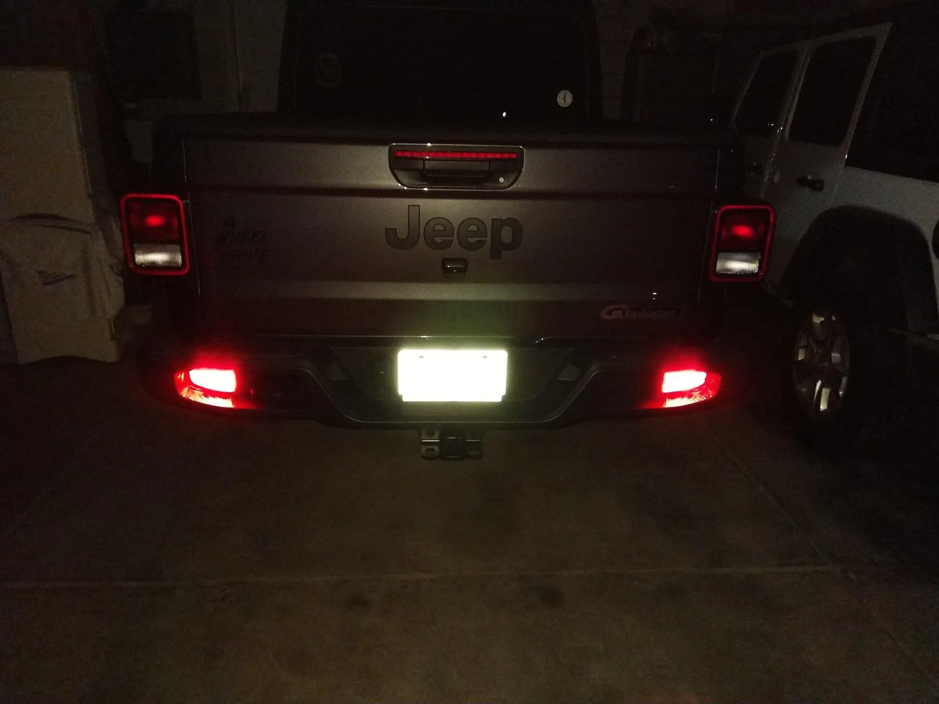

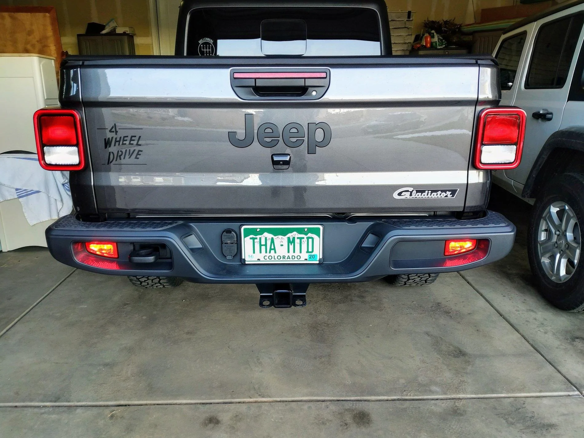

Here's how they look turned on.

looks great man, your initial post is what got me to order these parts before my Gladiator even showed up. I was hoping I could make everything work like factory but looks like it might take a bit more than that.
Did you run you wiring underneath to the engine bay ?

I did. I have about 25' that I wrapped to match the factory harness and then ran it up passenger side frame rail up into the engine compartment, connecting it to the aux 3 wire. The ground I terminated right above the spare tire at a grounding point.
