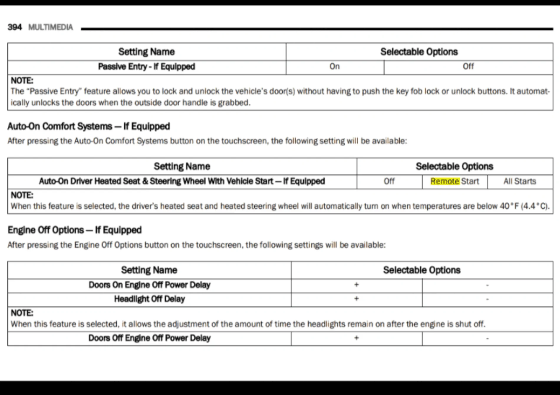

There is a setting in UConnect when to have three heated seats come on if temperature dictates. Mine is set for remote start, but others may have it set for anytime.
Vehicles Equipped With Remote Start
On models that are equipped with remote start,
the heated steering wheel can be programmed
to come on during a remote start.
This feature can be programmed through the
Uconnect system. Refer to “Uconnect Settings”
in “Multimedia” for further information.
I've looked through my unconnect menu and I can't find that option. Do you have the 8.4 or 7 screen size, seems to be a lot of stuff the 8.4 set up offers the 7 doesnt?
That was quoted from page 46 of the manual. Attached is the page for the 7" screen.
Correct - but the heated wheel and seats only come on in this setting when the temp is 40 or below. Too bad there is not a way to adjust that temp.

Try switching from "Remote Start" to "All Starts" and see if they work regardless of temp.
I know it's not a fix, it's an experiment.
