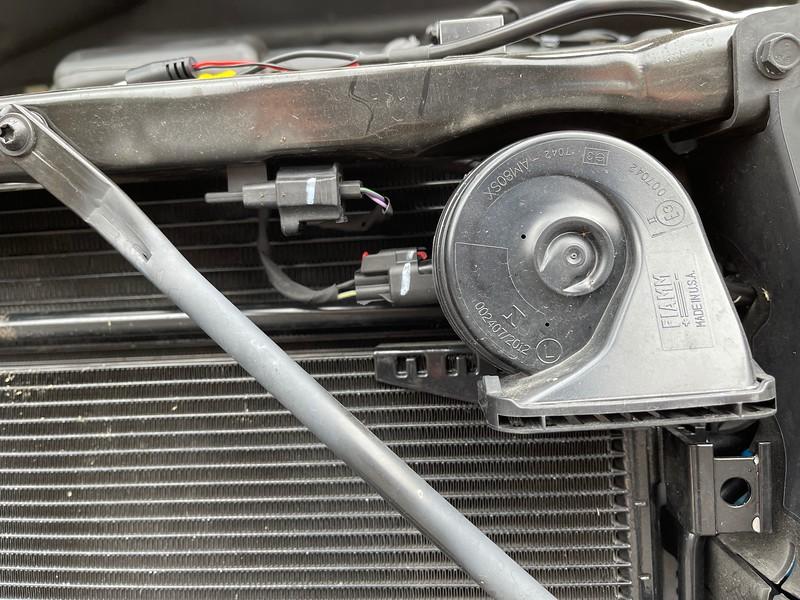

do you know specifically where the sensor is?
