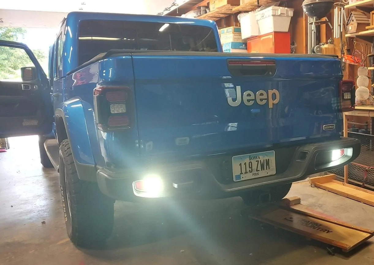

These lights are BRIGHT. In fact, they light up the whole garage addition when I turn them on.
In this pic - it was a bright sunny day, sunlight coming in both windows, and the LED garage lights were on - and my Oracle bumper lights STILL cast a shadow in the daylight. (hope they don't fade the red paint on my car)

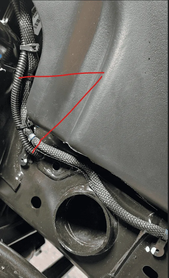

Papa, how did you run the wiring for the rear mounted light bar to the engine bay? What path did you take and how did you secure? We are going to be getting a new trailer and that would be great to have that to one of my Aux switches.
For the LED backup lights I ran the wire through the frame on the right side. I did secure it to the frame here to keep it from moving around.
The pair I ran back for the 12v outlet, etc. I ran through a woven sheath and ran on top of the right frame rail, strapped to other wire harness most of the way back.
This is where I entered the frame from the engine bay for the single 16 gauge wire going back to the backup lights -

AUX 4 - Oracle bumper mounted LED backup lights - they come on in reverse, or I can hit AUX4 and turn them on any time I want to light up my trailer when loading or strapping down a car, or for whatever reason I want.

Did you use the Oracle harness? And if so, how did you make that work with the Aux switch? Just tap into the power wire?
I used the Oracle plug and play harness and a diode from Amazon. I was going to use my own military surplus diodes from the 60s, but decided the commercial setup would be neater for wiring.
It all sits behind the right tail light. You can see the diode - two inputs, one output.
One input is the white wire from my aux switch, the other is the red wire I have coming from the Oracle harness.
Output goes to the red wires in the pigtails from the bumper mounted backup lights.
