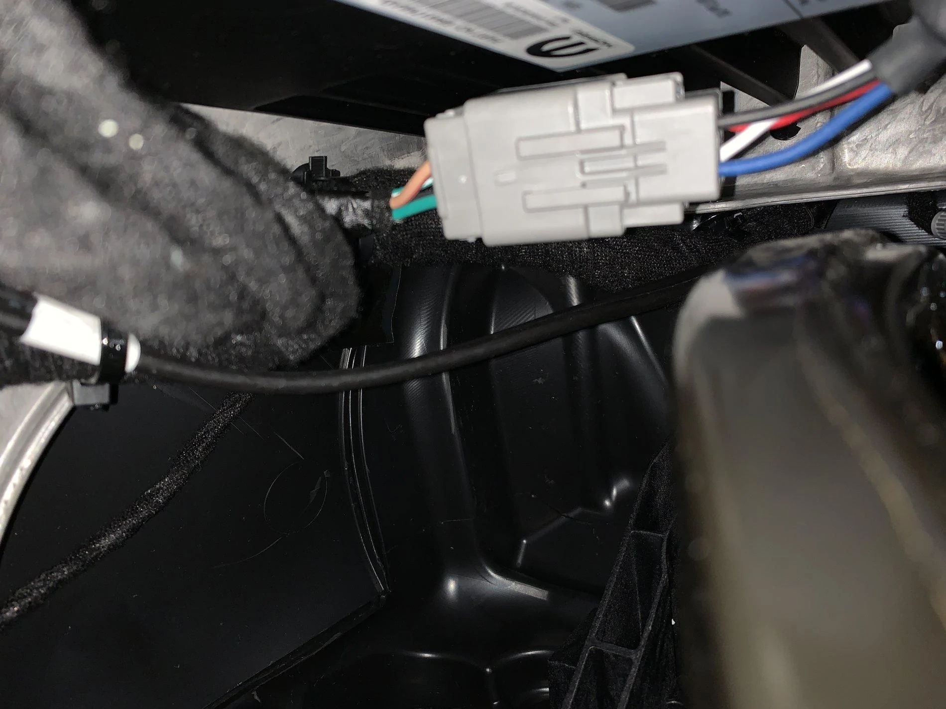

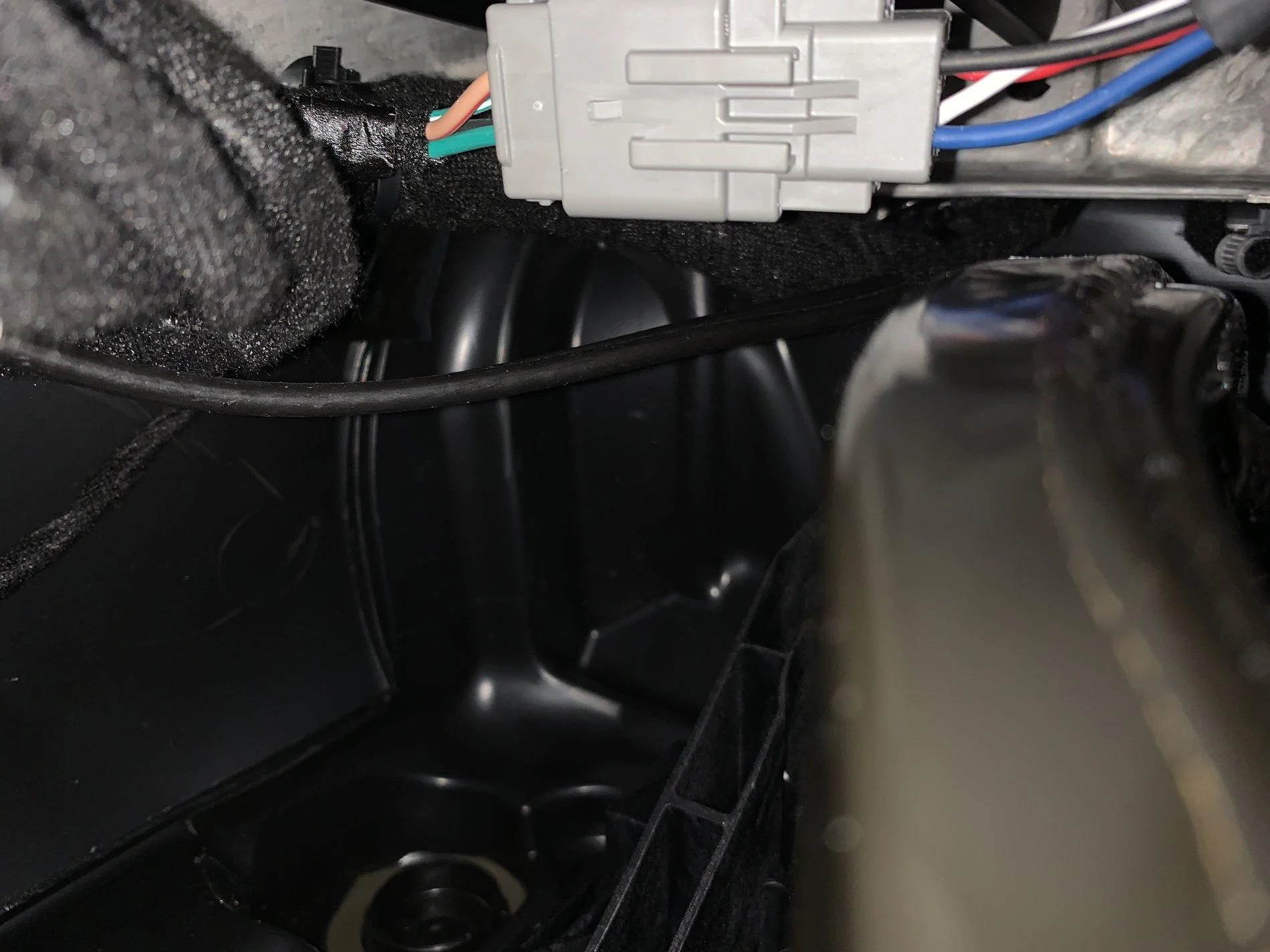

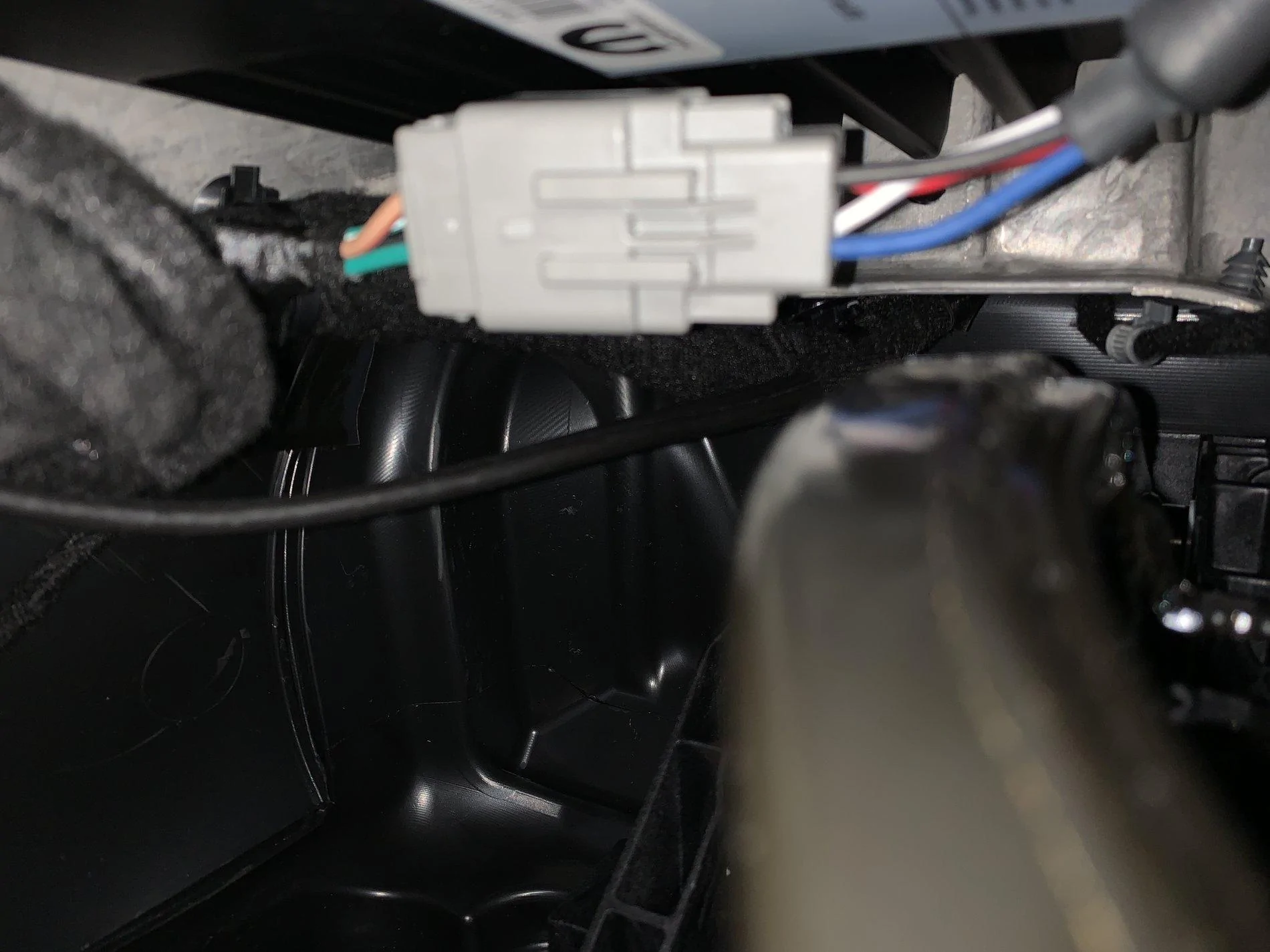

Not sure if it helps or if you already got it, but here’s a couple terrible pictures I got by stuffing my phone under the dash this evening. The part on the left with the green and orange wires is the factory plug, the part on the right is my controller harness.
