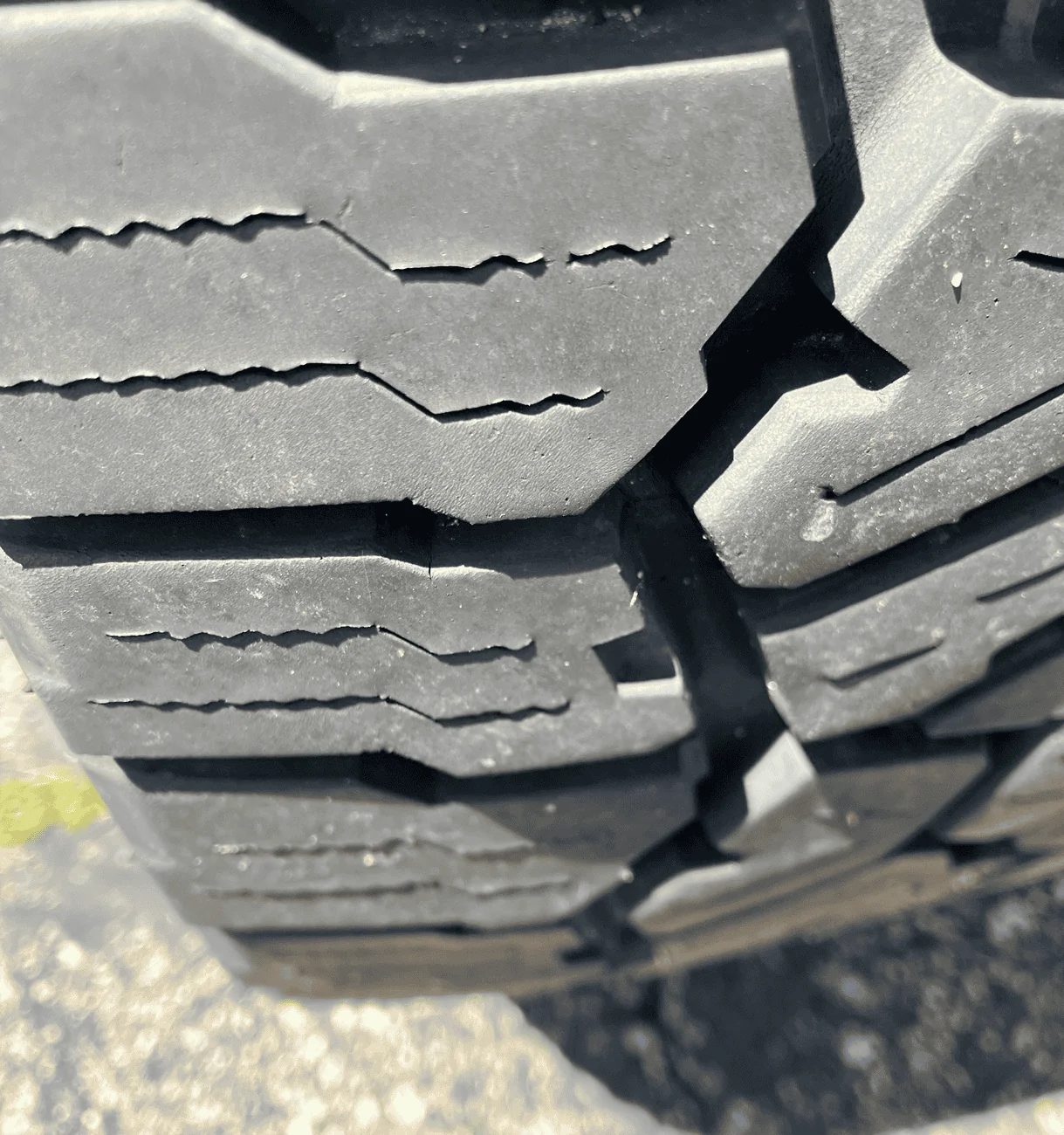

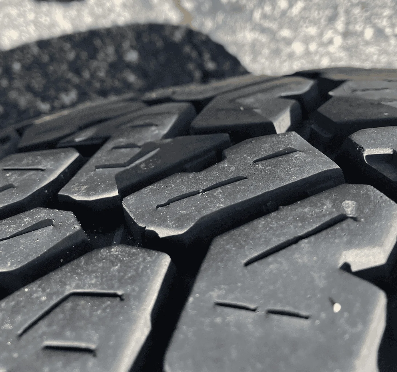

Hi all I have 24k on my Mojave, Looking at the tires I noticed lugs casting shadows as if they were protruding past one another and not at even heights.
Is this normal?
I Rotate every 4k at least, and keep them at 33-34psi.

A little under 24k miles and mine are showing the same condition…
Stock everything… no lift. Tires rotated every 5k miles.

Cupping wear appeared on mine around 40k. Dealer insisted it was an alignment problem. We found a local, independent front end specialist. His remark was, “the factory spec has too much toe in”. He did a 4-wheel alignment to his specifications and no problems since. Drives straight, no wiggle or wobble and w/regular rotation the tires are now wearing evenly.

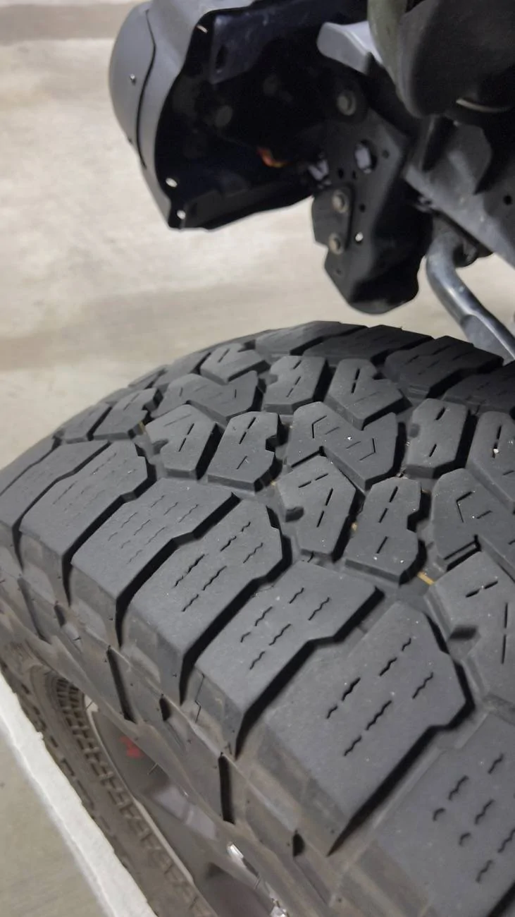

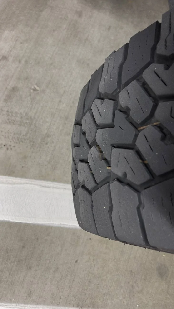

Well, decided to go the most inexpensive route. Only the front tires were showing this wear with 22,000 miles and just one rotation some 12,000 miles ago…
Jeep Gladiator Falken Wildpeak wear issue? IMG_6988
So instead of taking this opportunity to buy 5 new tires (pizza cutters that I want next-Mickey Thompson Baja Boss A/T LT255/85R17), I bought one tire. Had the dealer swap the spare tire from the spare rim to one of the front rims. And will be installing a new tire in the other rim on Monday, since they had to order it. Jeep will be parked until then.
Effectively giving me two new tires in the front.
Jeep Gladiator Falken Wildpeak wear issue? IMG_6987
Then, when all these wear out, it is pizza time baby!!

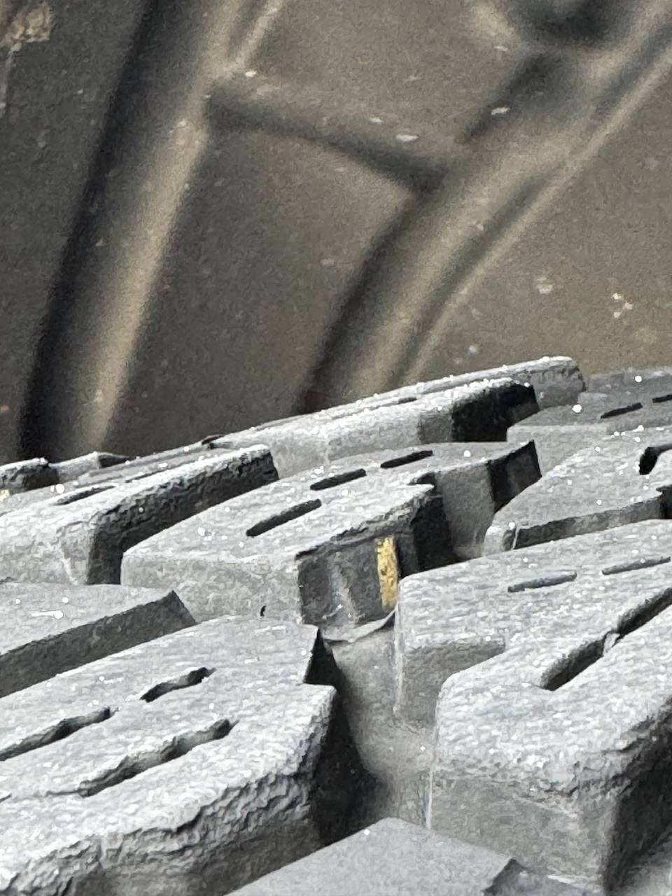

PA
2023 JT Mojave
I just noticed the same thing as the OP on my new to me 2023 Mojave. I have no idea if the tires were rotated or not, but I just hit 31k and the front tires are wearing unevenly. The rear ones are exactly as I would expect tires to wear.
