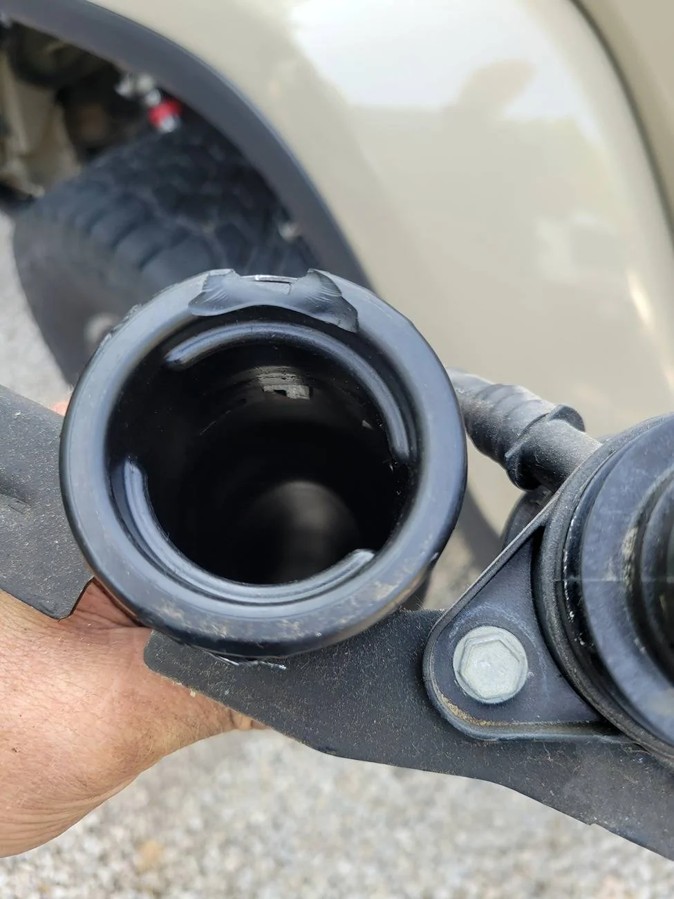

I used the 12" straight jaw "channel locks" to twist the nozzle. I tried the curved jaws and no joy. Then pry the nozzle out w/ a flat screwdriver. I tapped the nozzle back into place. Like others noted it's about a 5 minute mod.

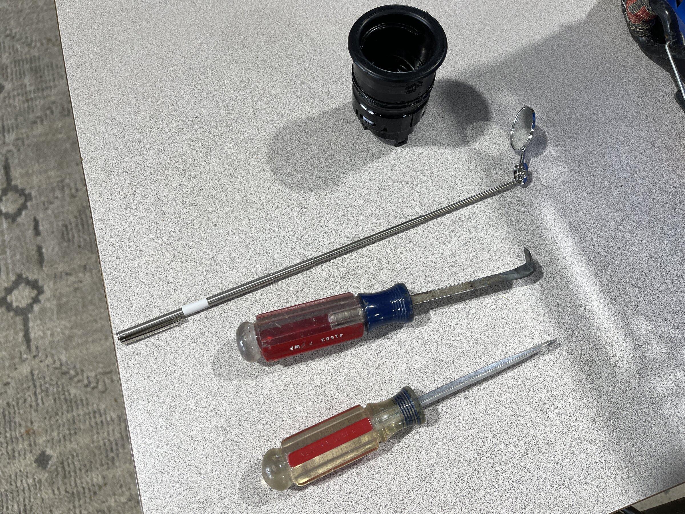

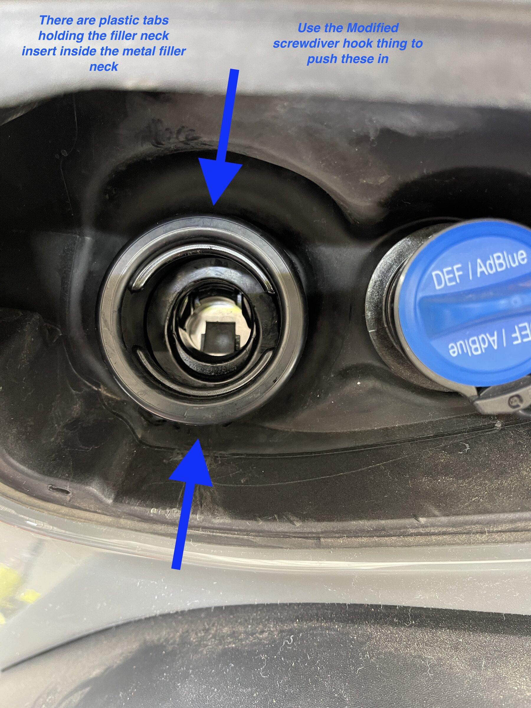

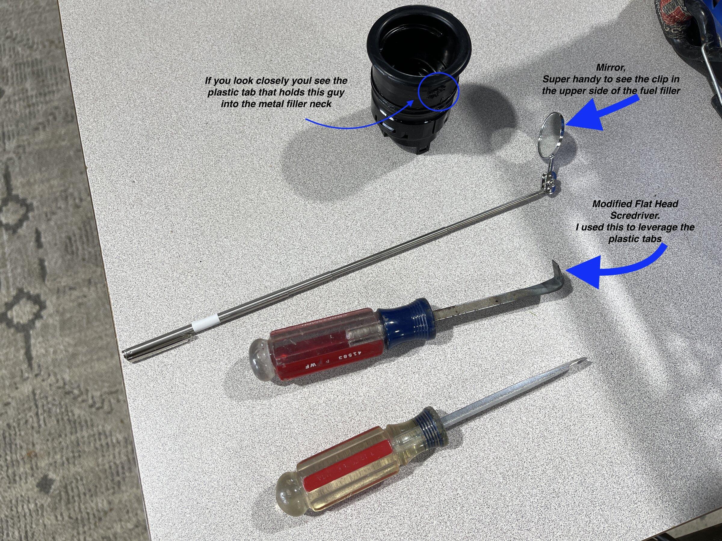

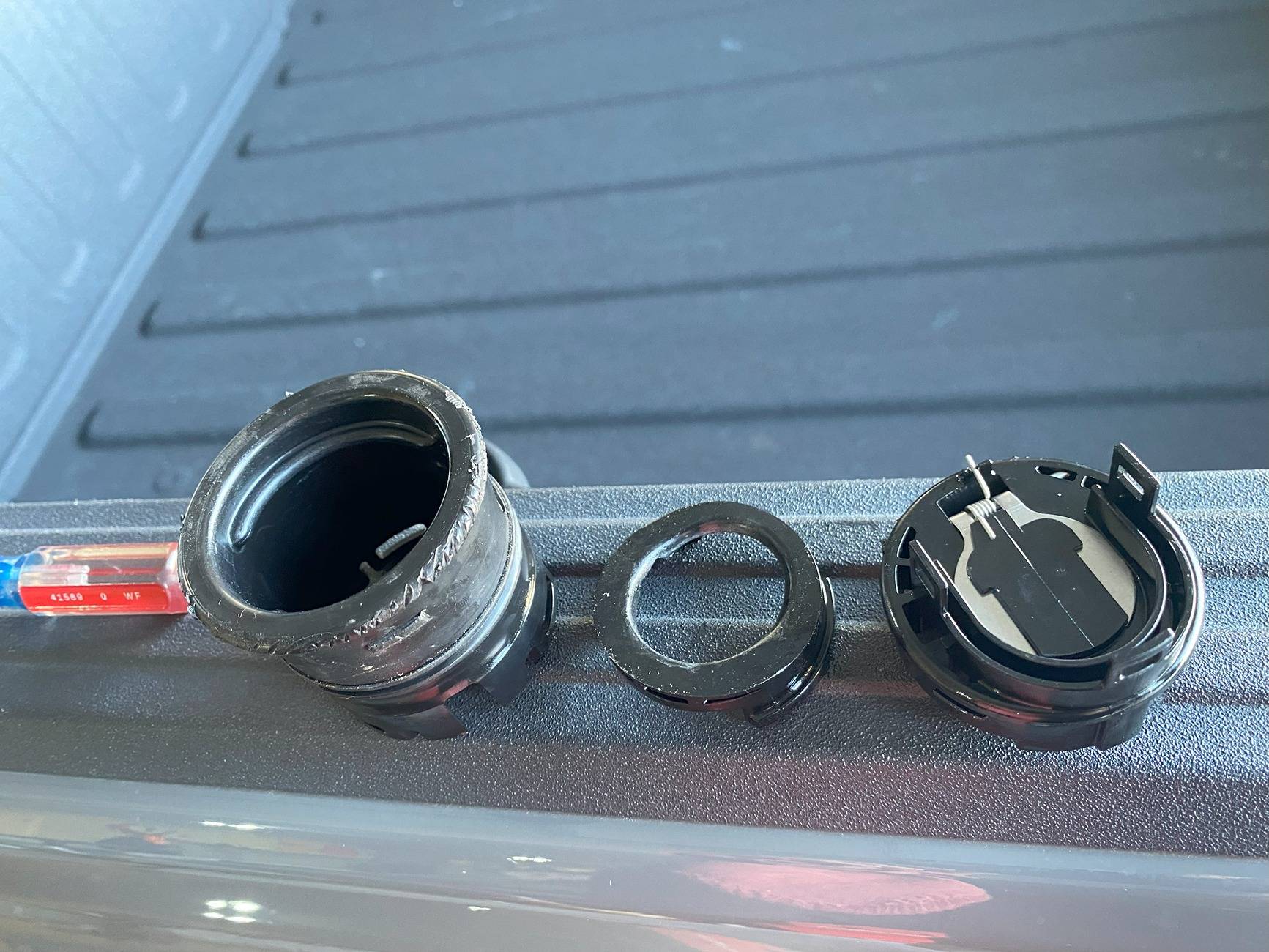

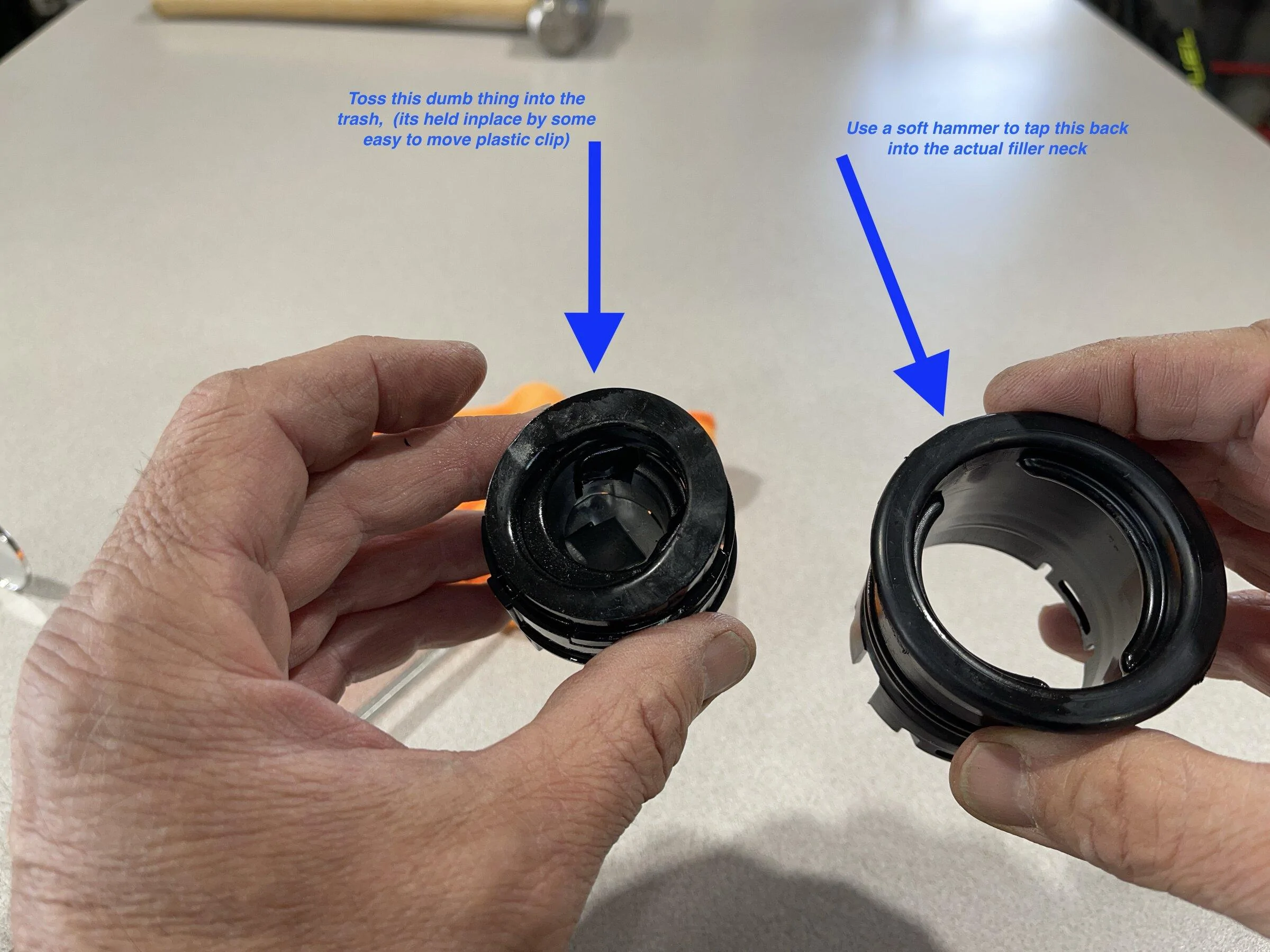

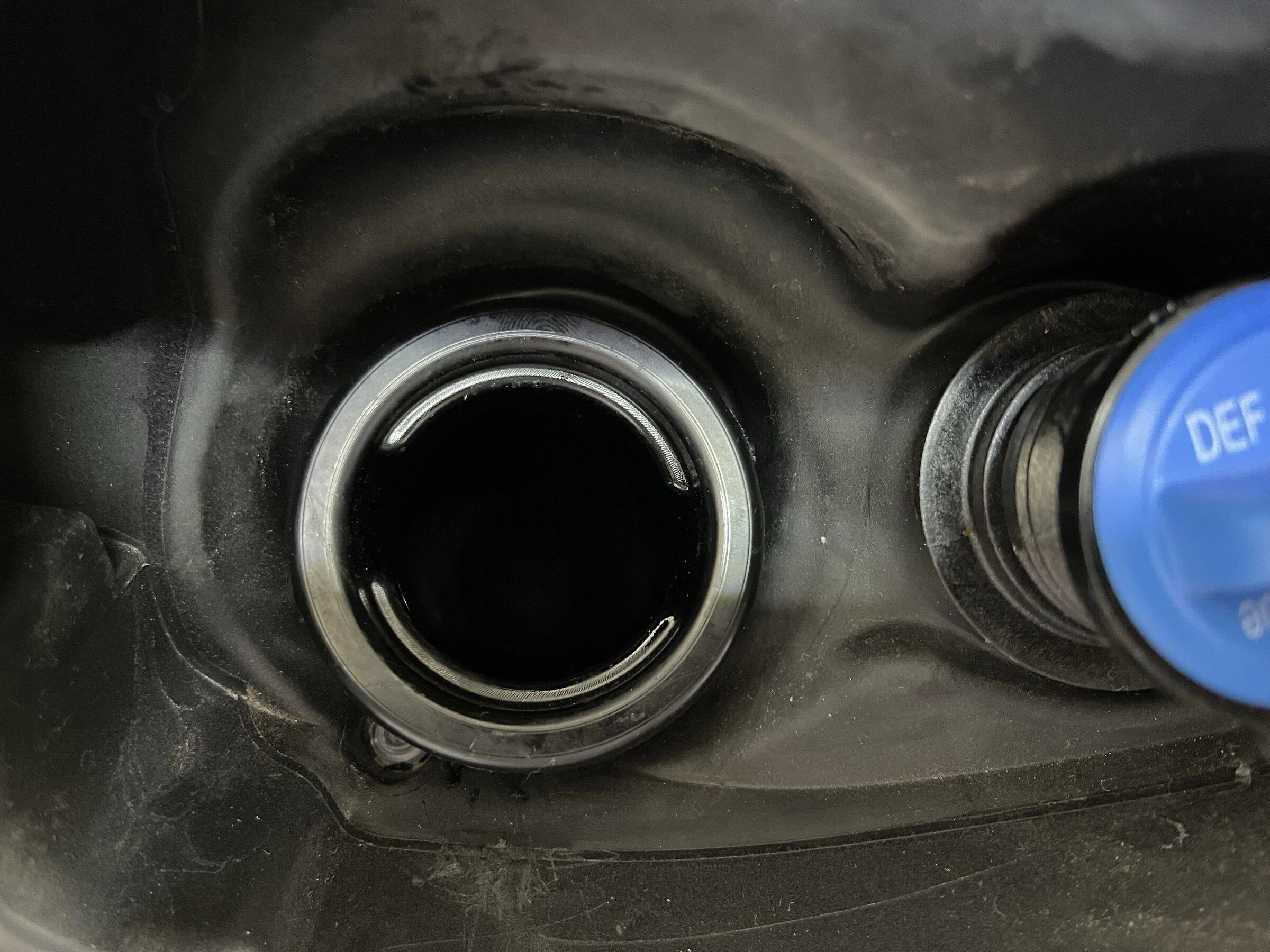

I tried the channel lock method yesterday and broke part of the fuel cap seating area. I chose to just take the whole assembly out and then take it apart. My first diesel was done the same way. Hopefully no issues with this being broke and having check engine lights later.
Jeep Gladiator Fill Neck Mod 20250708_161035
Jeep Gladiator Fill Neck Mod 20250708_161046
Mine has looked the same for 3 years now (tried using a prybar before looking up how the flap was attached). It'll still seal well enough you can fill it all the way up the neck with out it leaking all over the fender.
Also diesel doesn't evaporate, so no evaporative emission system. AKA you can drive around with a rag as a fuel cap and never get a CEL.
