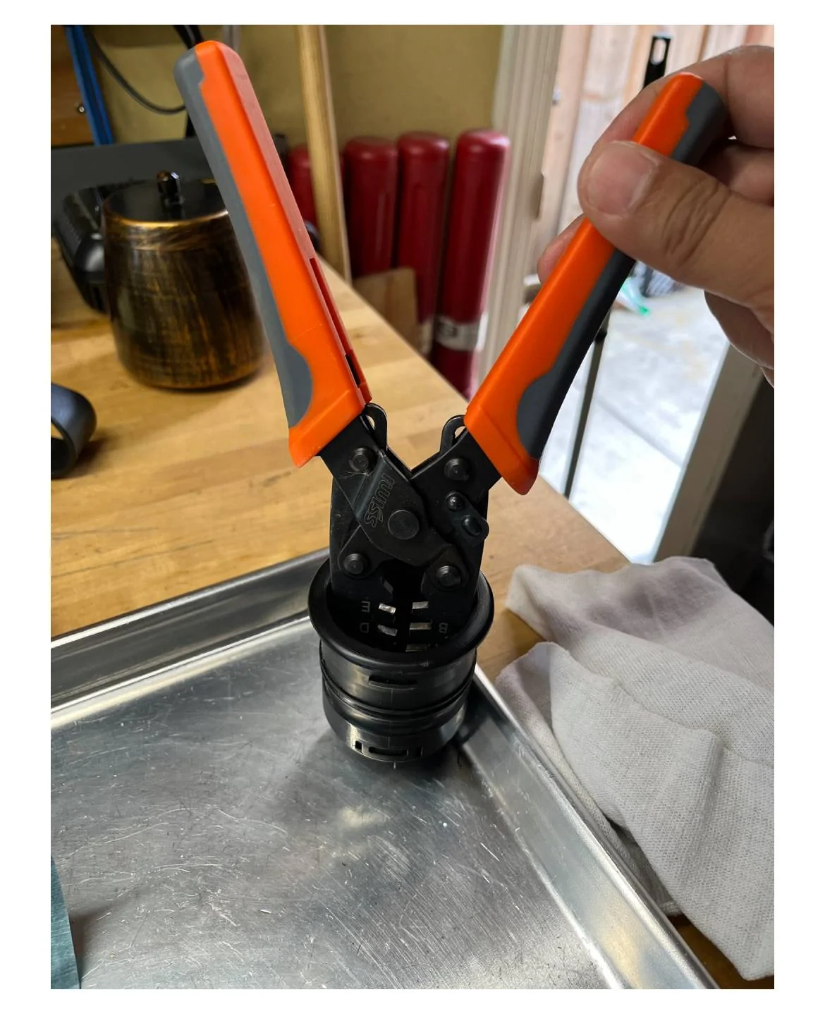

Try this. It's easier without damaging the neck insert. Plier or whatever that fits in the neck. Using the ends of the thread as leverage and turn it counterclockwise.
Edit: Once the tabs break loose. Lightly reinstall the gas cap and pull it out. It might help to beveled the edges of the plastic tabs in counterclockwise direction.
Jeep Gladiator Fill Neck Mod IMG_0444

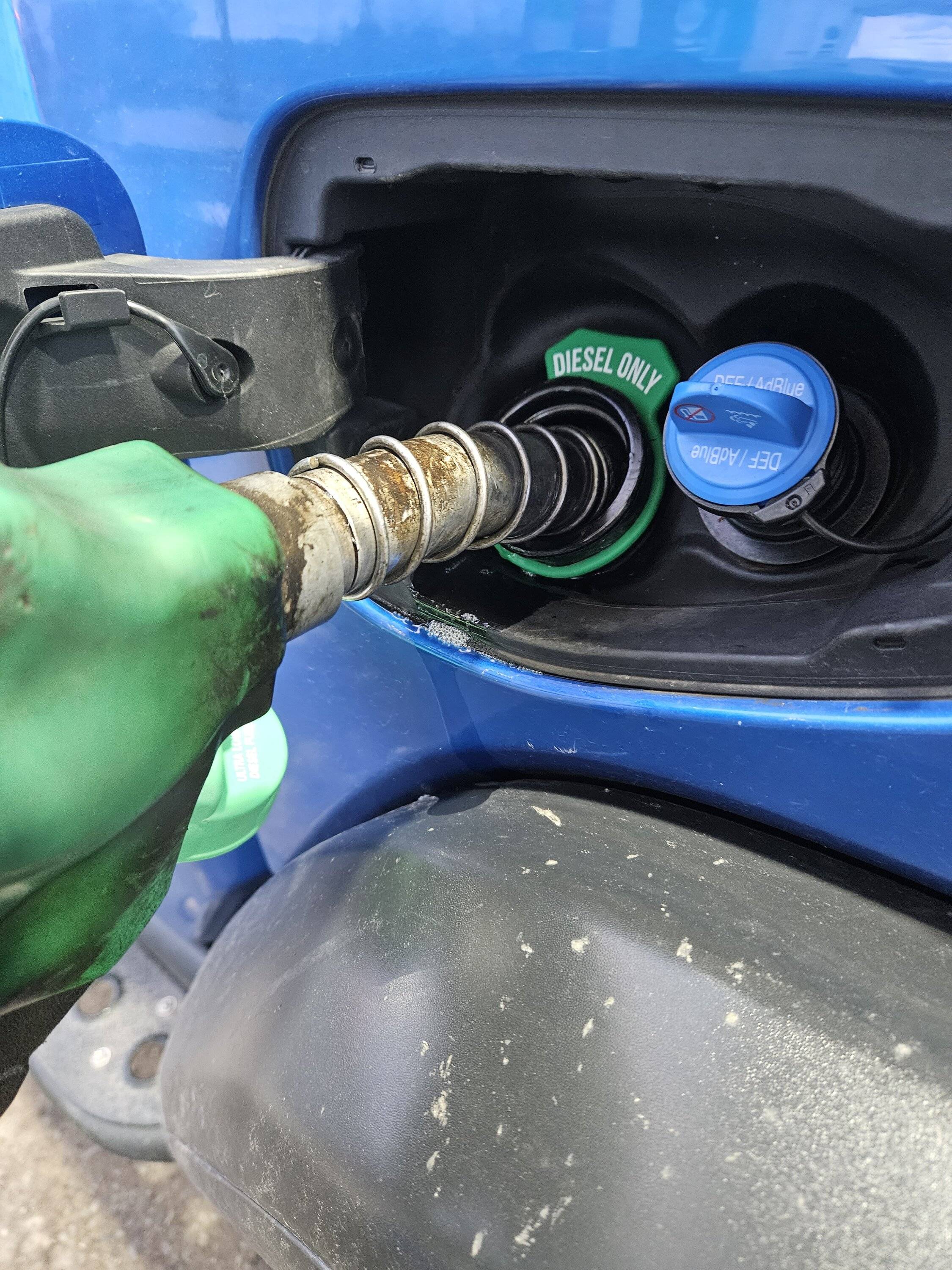

Yesterday, I came across a gas station that had the big rig nozzle on the pump. :facepalm:

Here's a picture of a big rig nozzle on a regular auto fuel pump.
Jeep Gladiator Fill Neck Mod 20231031_180316

Great thread! I did mine today. I used the wire strippers, it rotated easier than I thought it would. I had to rotate it a little more than 1 o'clock. Then I put the gas cap on and pulled it out.
Once on the bench, I used a screw driver on the side of the tab that holds the restrictor in and pried up. Did that to all 3 and reinserted the fill neck back into the JT.
