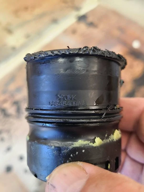

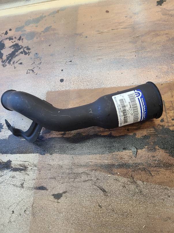

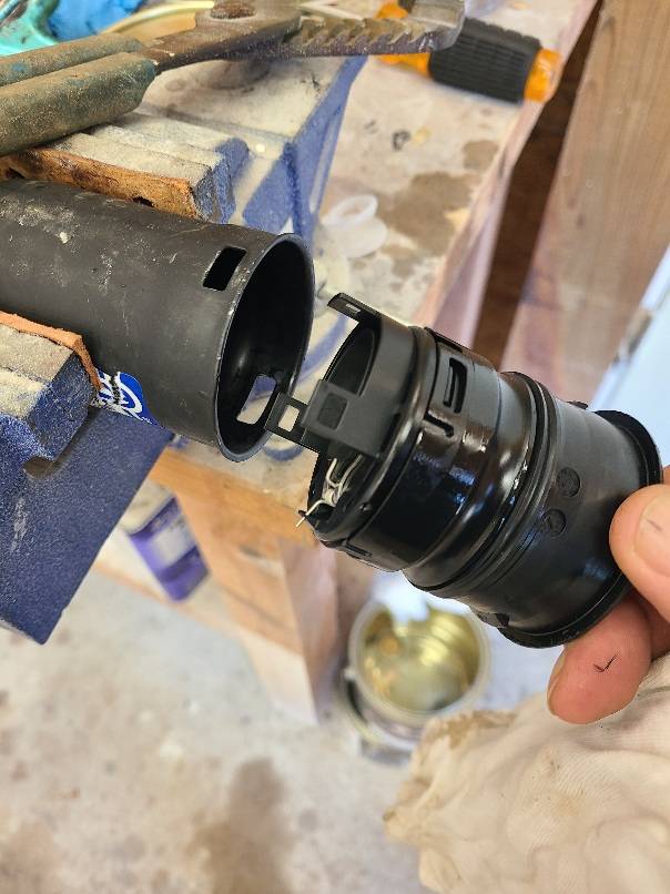

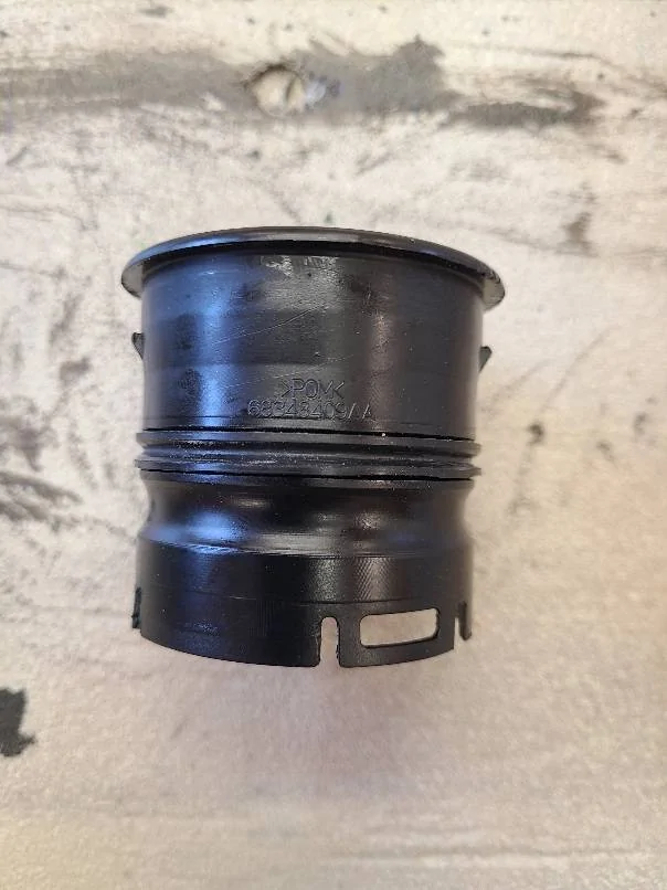

OK, so for you ham fisted folks like me who destroyed their fuel insert trying to get it out, the Wrangler diesel fill tube insert (as posted above) does fit. It sucks that you can't just order the plastic pieces, but at least this part is half the price of the Gladiator part. Pictures included. PS, it's still a pain to get it out, even with it out of the vehicle. Kudos to you guys who did it while on!
Great news! Still waiting on mine from allmoparparts.

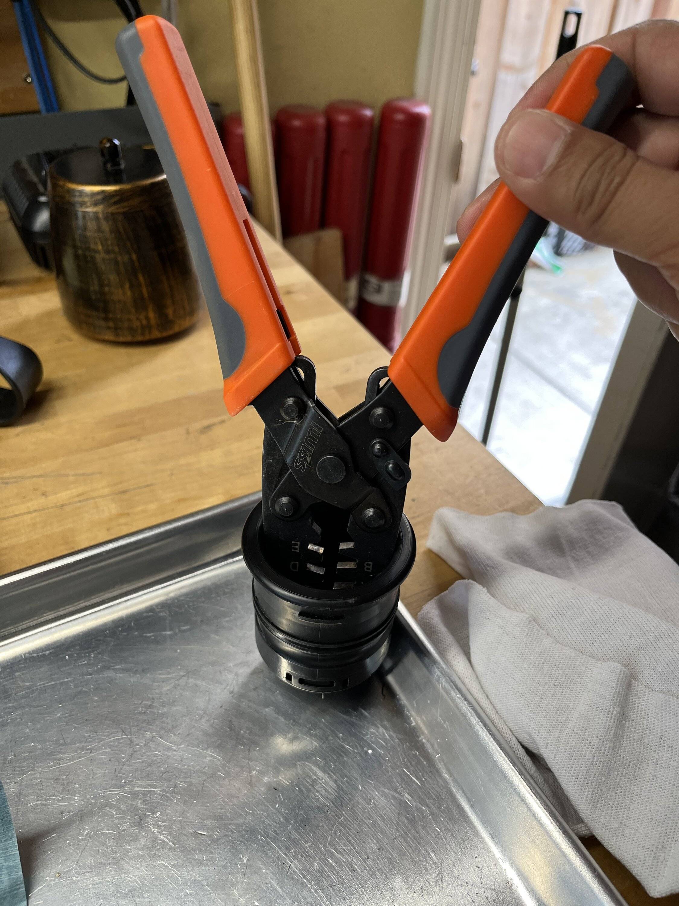

Just pulled my out today. I used the crimper plier technique, it's easier than expected. Also applied a little silicone grease on the oring, and it slipped right back in the tube.
Hold on tell me how you did this??
Vtur
Le
Mar 6, 2021
2,014
2,374
Norcal
JTOD
Electrical Foreman
Using the ends of the thread as leveraging to twist it off the tabs, then put the cap back on and pull it out.

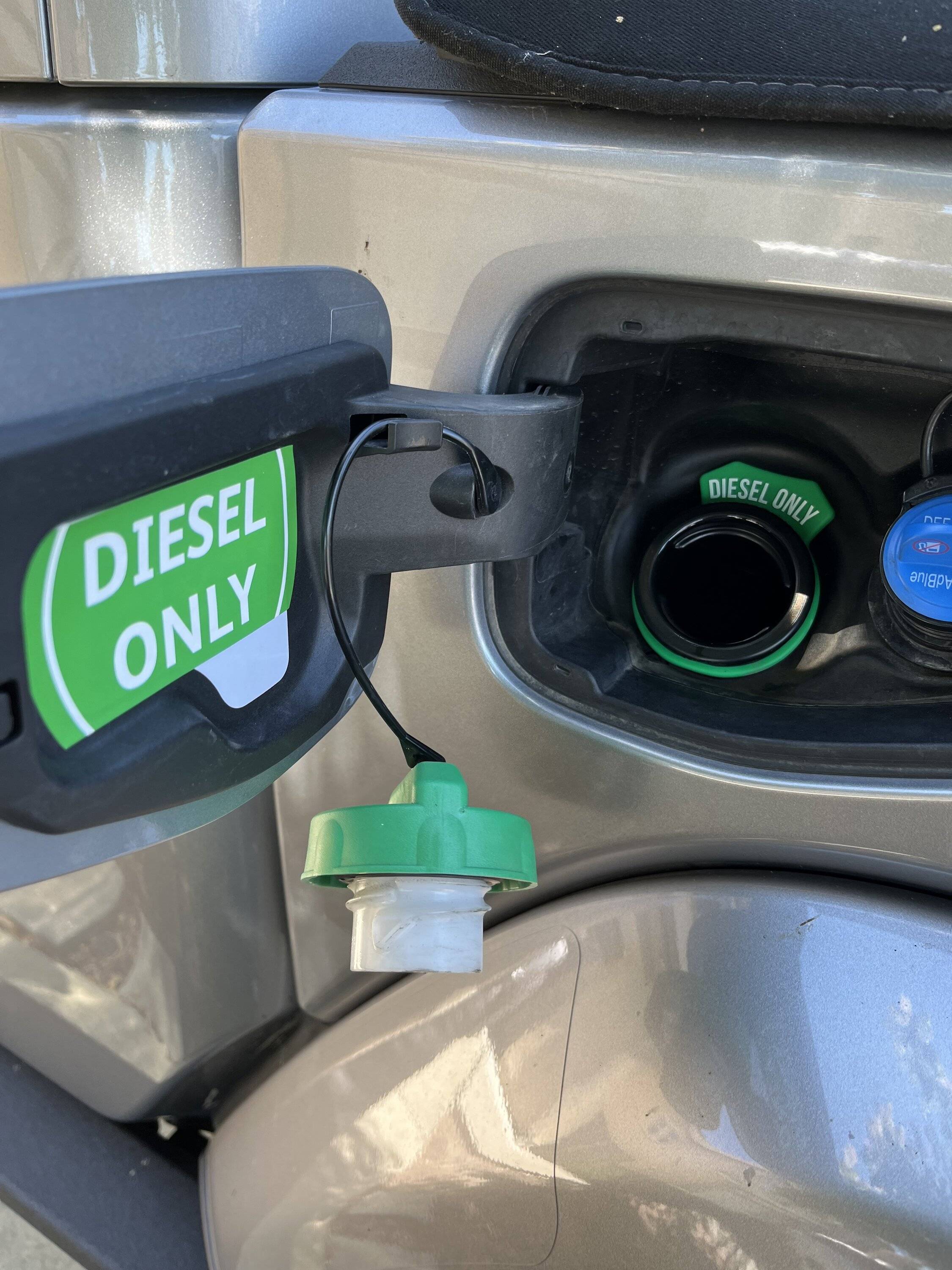

Yea i tried mine, but they were too large.........thats what she said so I ended up using picks and 2 flat heads and channel locks and i still managed to break off an edge of the filler neck. O well. Its off and the stupid flap is off. Hopefully the super glue holds otherwise its gorilla glue.
