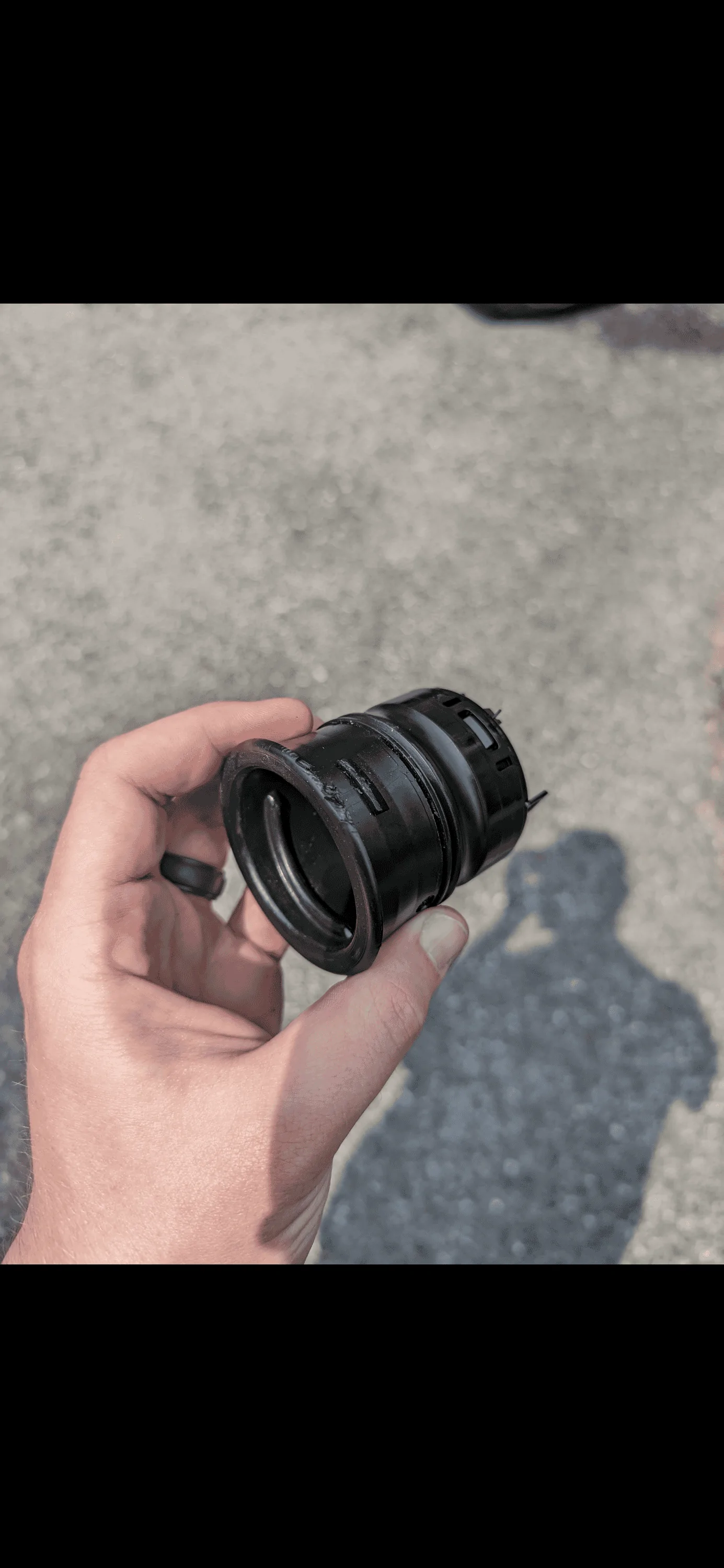

Got it. You gotta pinch just the rim and twist slowly rocking it till the tabs go in then pull out. There is a rubber ring around the piece so you gotta work it out.
I finally got that bastard out. :like: Had to use muscle and a different position with my channel locks to get it out. Once I got it to turn inside the neck. It started to come out. Had to turn it about 90 degrees.
Yea I was surprised at the pressure I had to use to get it out. Glad you did it!
