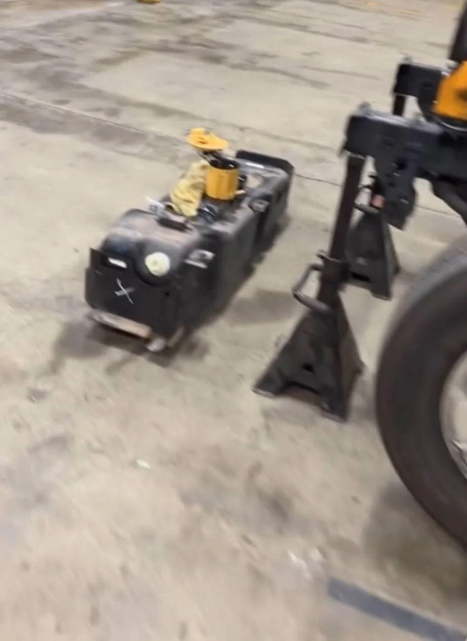

How did you remove the entire assembly from the Jeep?
Take off the rear fender and fender liner for access, there are some fasteners on the back side, it was pretty obvious how to remove it once I could see it.

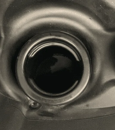

So I finally finished this today....apparently I was grabbing too much of the tube and insert with the large channel locks and broke the lip on the one from the factory 2 weeks ago. I am pretty much all thumbs at times and am a little rough on getting things apart ( I was a Soldier for 30+ years....guaranteed that if someone says it is unbreakable...we can break it).
Ordered the wrangler one listed in here from BAM...got here yesterday. since it is like half the JT price.... used dremel to make the plastic tabs lower thru the slots before removing from tube.

I pried old one out and put new insert in and it looks good. Plus when I went to fuel up the tank the EDT went in the tank vs down the side of the discriminator/sat there and dripped over the edge around the filler like the last few tank fill-ups.

Just did this on my '23 using the wire stripper pliers method. Less than 5 minutes most of which was getting the 2 halves apart

Just to add my 2 cents here - I tried the channel lock method first, made very little headway, and boogered up the rim of the nozzle a bit before giving up. I then tried the wire stripper method, which worked beautifully because you can get leverage with the stripper tool against the tabs that the cap locks into - no slippage, no damage, and it came right out. Afterwards pulling out the discriminator was simple with a flathead screwdriver and the assembly in a vise. I cleaned up the boogered up rim with some sandpaper and reinstalled the neck.
For anyone that hasn't done this yet -- skip the channel lock method and go straight to the wire strippers/internal wrenching method. That's the ticket.
