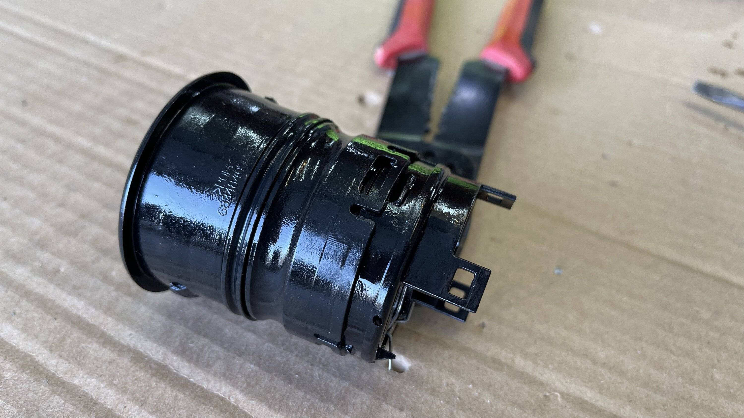

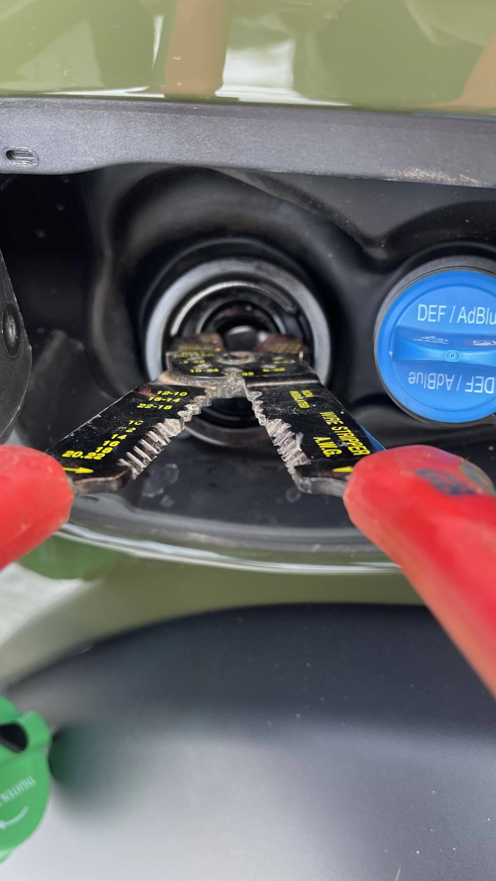

Hey all. Late to the party but new to the Gladiator Ecodiesel. I just pulled the guts out of my fuel fill neck and wanted to share an easy way to do it.
I started by trying to push in the tabs but couldn't access the top one well enough to push it in. So I tried something different.
I found a pair of wire stripper pliers that when opened, would fit between the ribs inside the filler neck. I could get enough leverage on the pliers handles to twist the plastic fill assembly to disengage the 2 tabs. Then the assembly pulled right out.

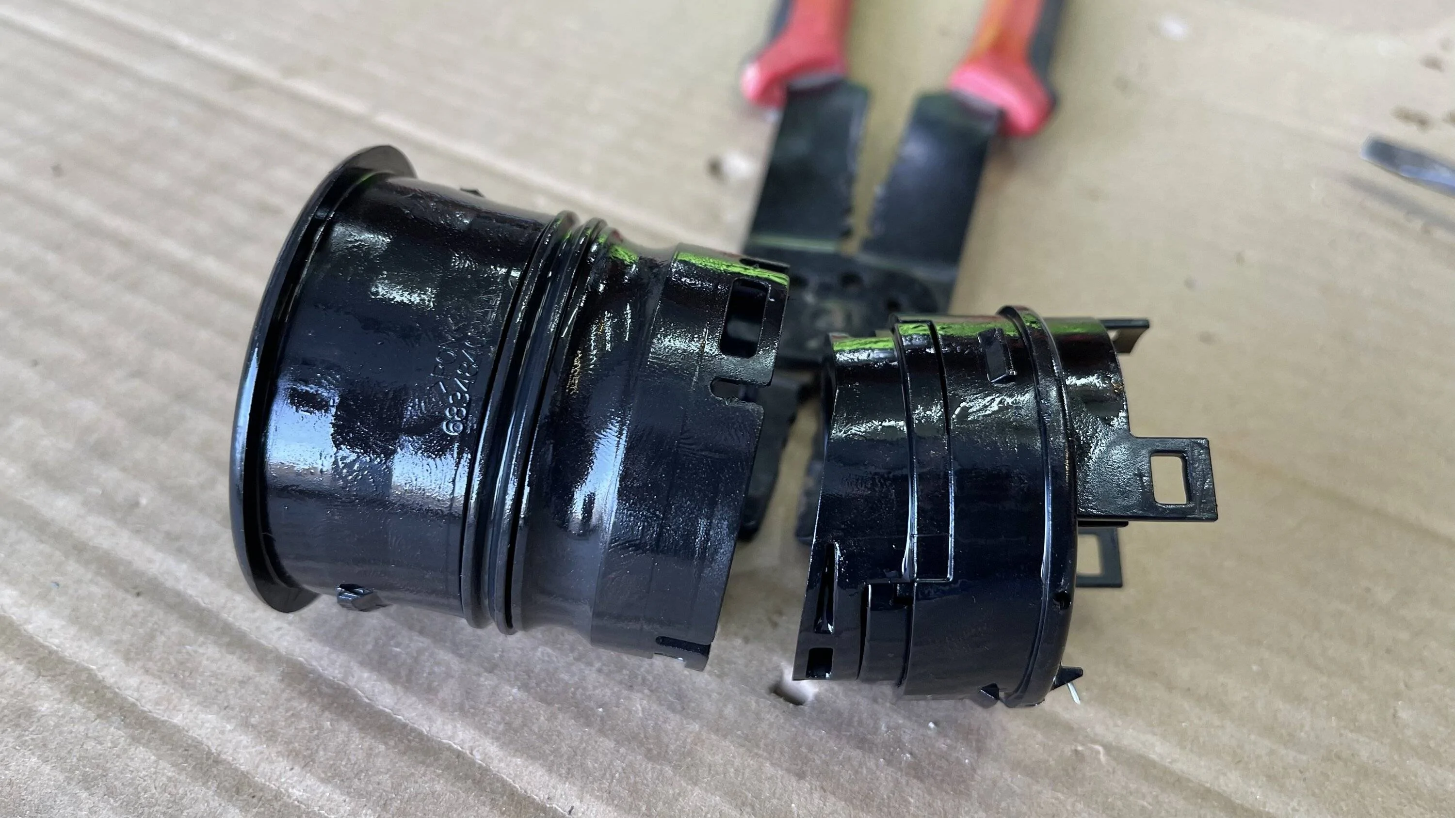

Once out you can access the 3 tabs that hold the trap door assembly on the housing and pop it off the bottom.
Once it's off, pop the top piece back in the metal fill neck and you're done.
This is basically accomplishing the same thing as trying to turn it with channel locks, but less chance of a slip and scratched paint.

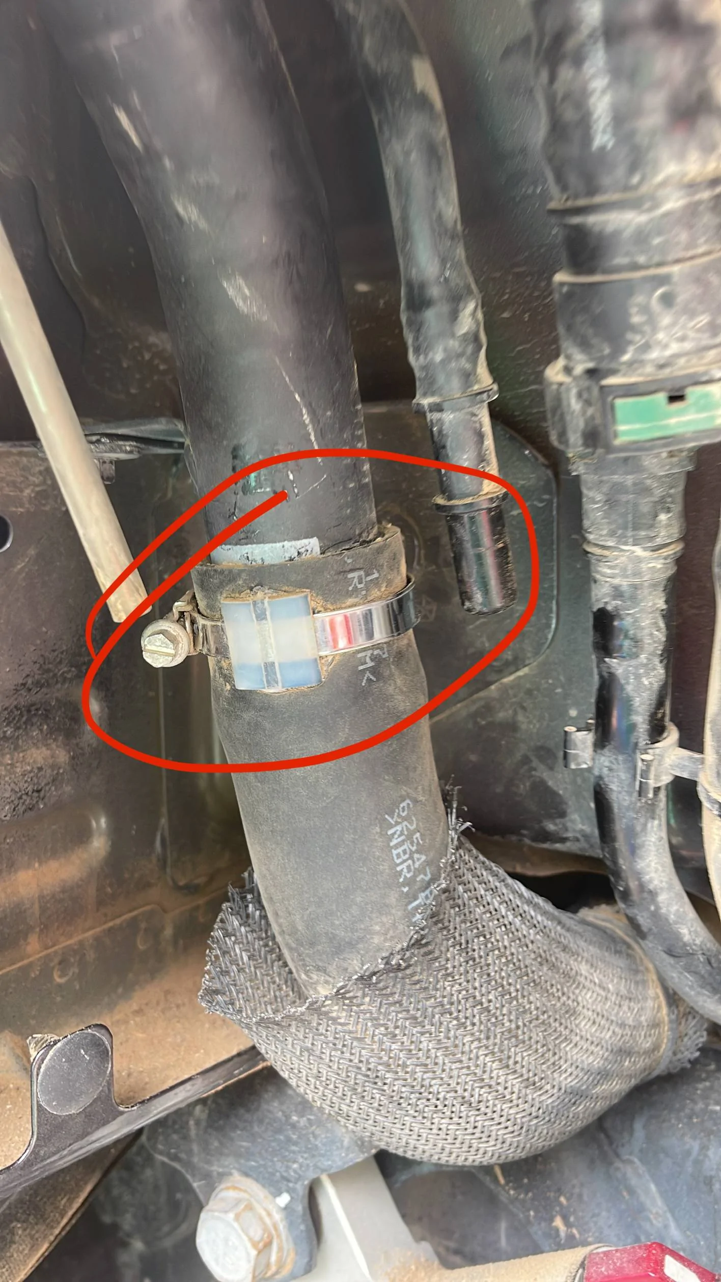

Not sure if there was ever a change in design or sealing of the fill neck to the rubber tube? Im swapping inner fenders and was trying to pull the whole thing to access it (channel lock method did not work) but the rubber won't budge from the fill neck at all. i ran a pick around the top part after loosening the hose clamp. i've tried to twist the rubber off the metal and it won't budge. it's as if it's sealed together.....
not sure if anyone else has ever encountered this?
