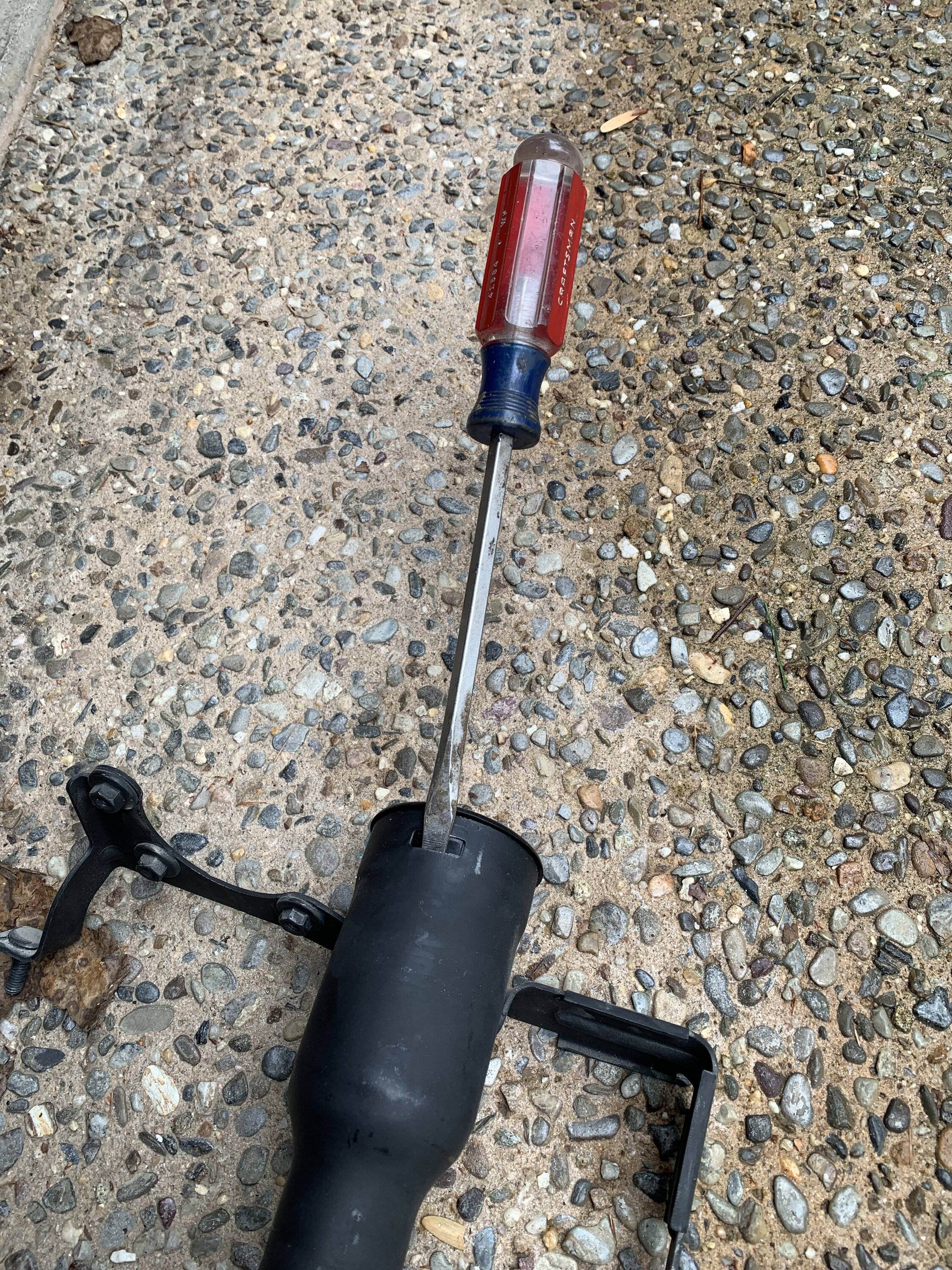

I remove my nozzle excluder a few months ago by removing the entire assembly first. I read all the posts about pushing in the “tabs” to remove the excluder. When I pushed on the “tabs” there was no way they were going to budge. They really are not “tabs”, but rather raised bosses. After almost giving up I tried another technique and used a large screw driver to pry out the nozzle piece, ignoring the “tab” completely. I’ll include a photo to show how I positioned the screw driver. The job was easy once I stopped trying to depress the “tab”,

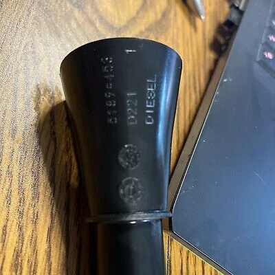

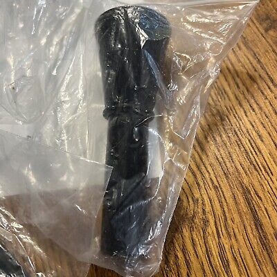

What is this adapter you speak of?
This little funnel comes in the glove box on all EcoDiesel vehicles. It's designed to allow you to use a Jerry can with the discriminator, since it will only open with a properly sized nozzle.
Very interesting. Mine didn't. Haven't had need of it, but only 5K miles in.
Thanks!
Sank
Jul 10, 2020
186
171
05 LJR, 22 JTRD
Thanks!
Check behind the rear seats?
Yeah the little funnel is absolutely not sized for truck stops. I keep seeing people say stuff like that. My jerry can has a diesel-sized flexible spout so the adapter's use is moot for me.
