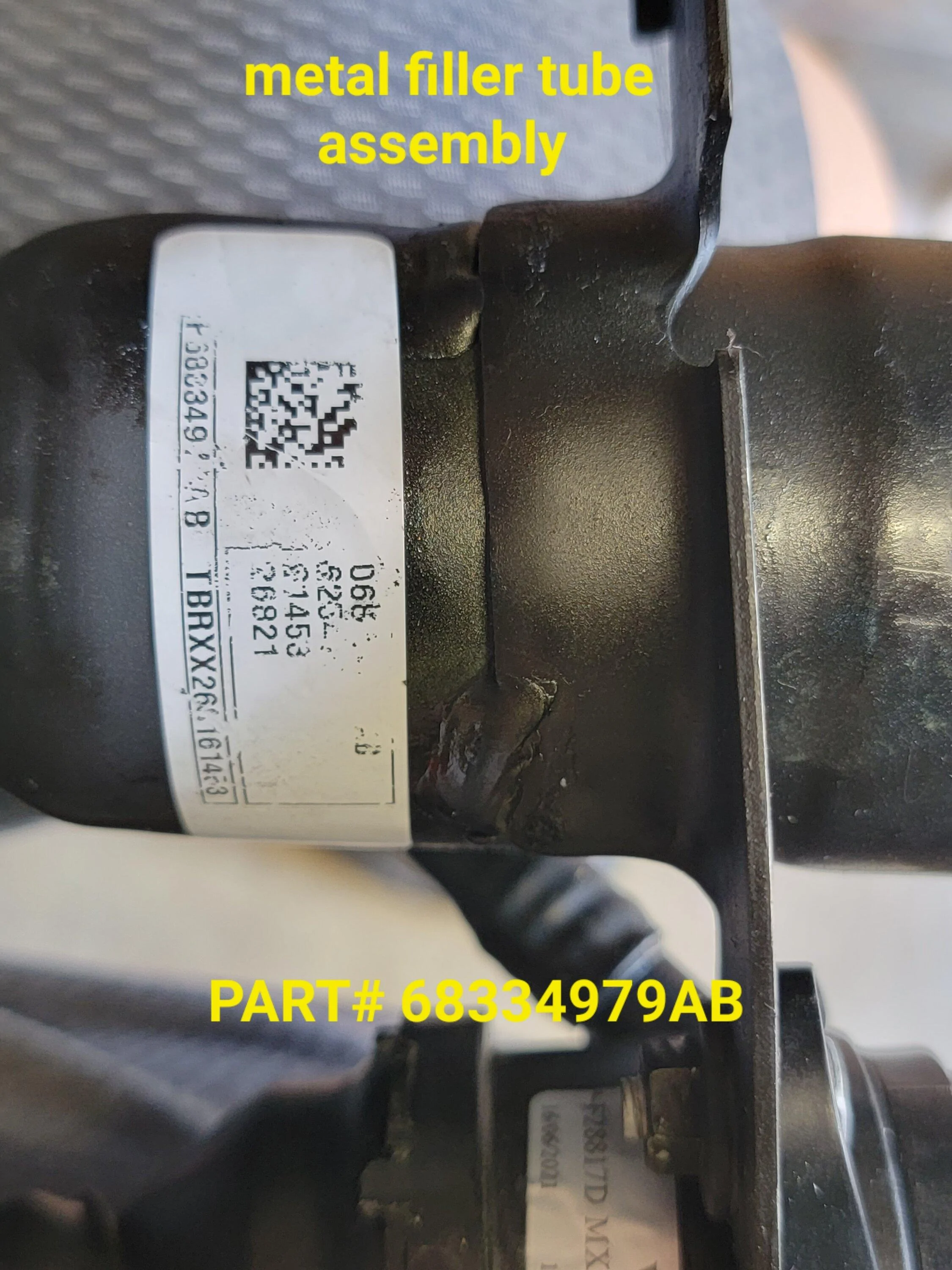

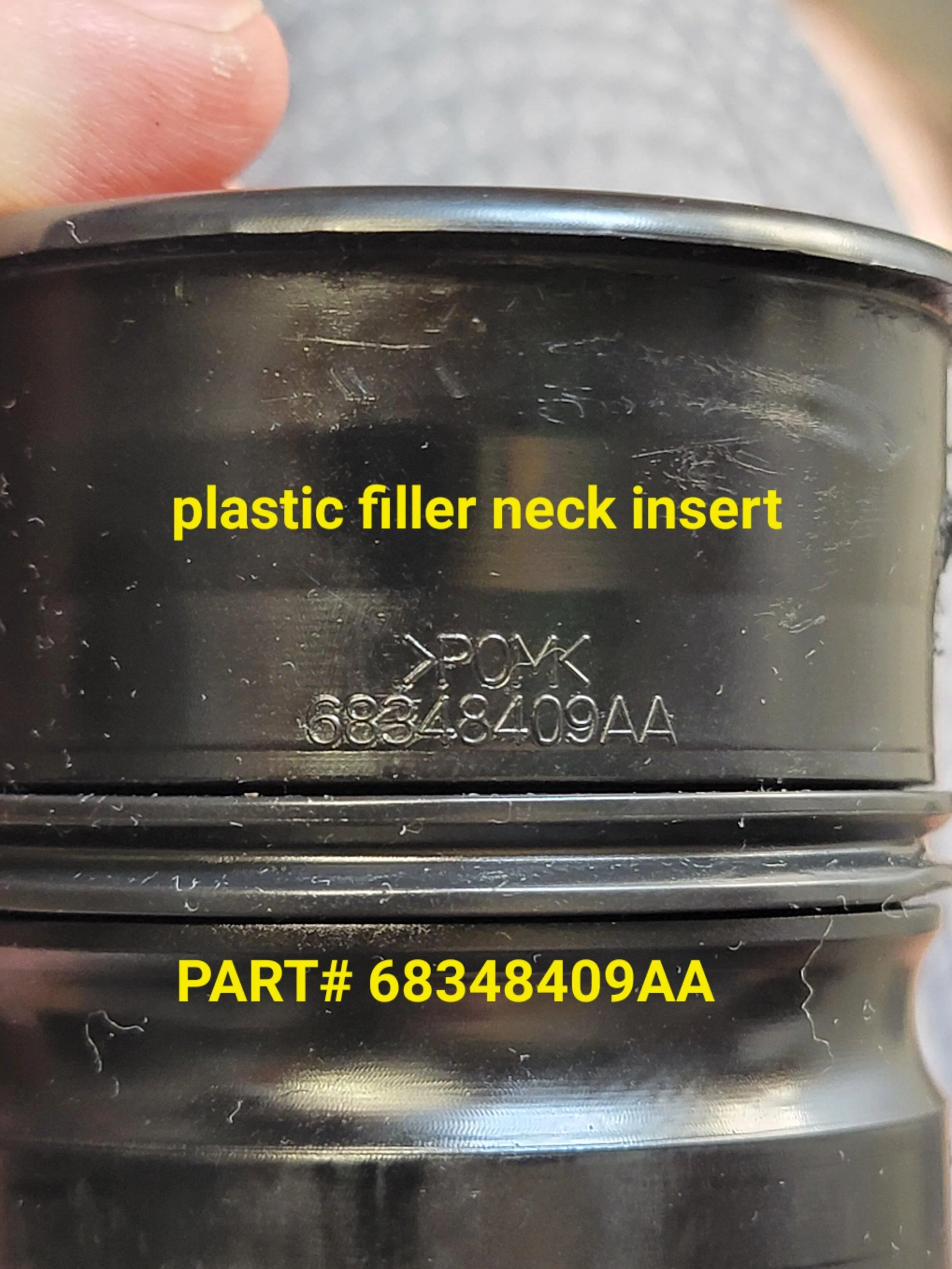

Thank everyone for your help.... abother successful removal here ! My difficulties were ME just being to careful or over cautious.... but I goter done ! Couple part# pics FYI.
Jeep Gladiator Fill Neck Mod 20220731_142918
Jeep Gladiator Fill Neck Mod 20220731_134106
