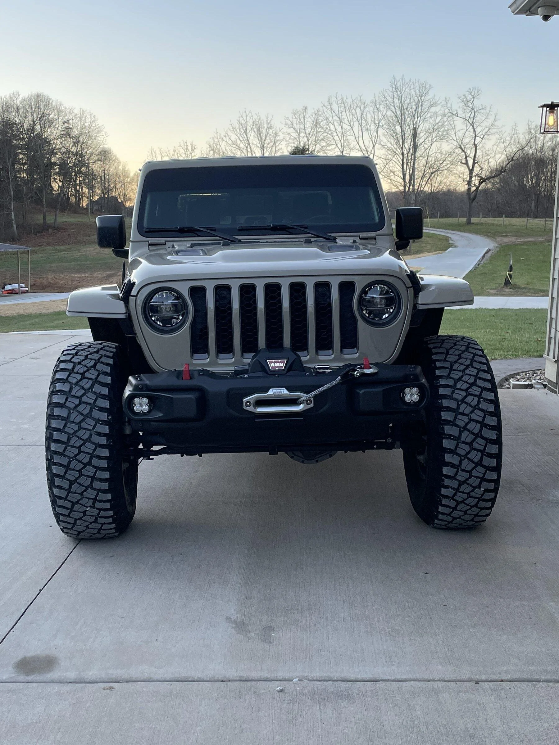

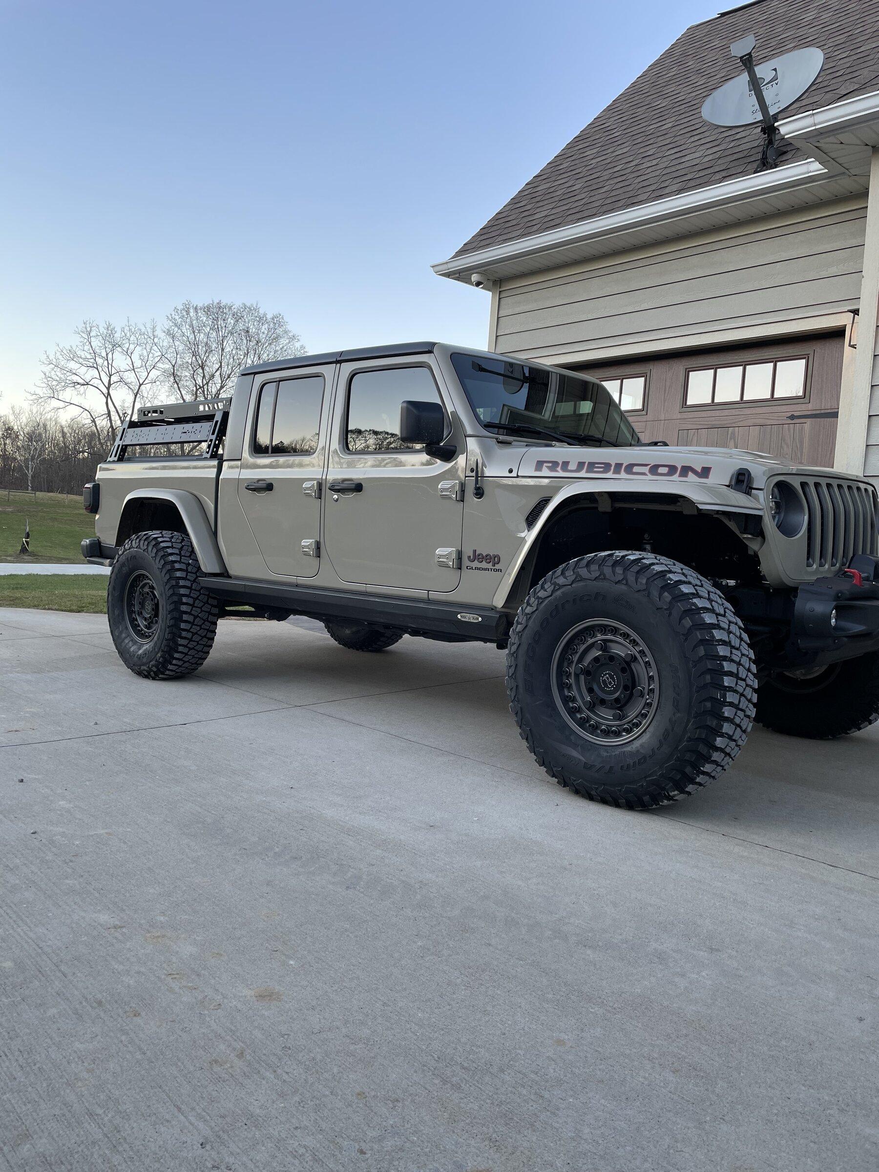

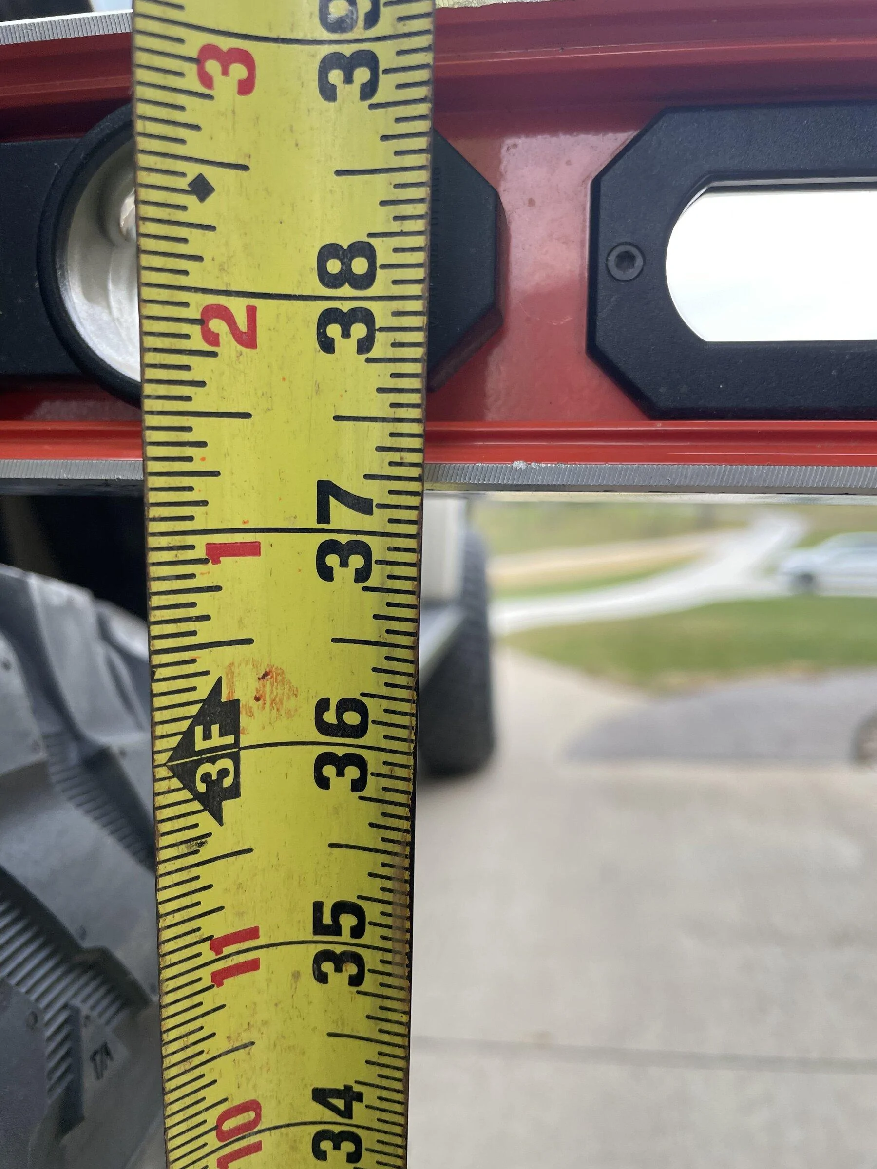

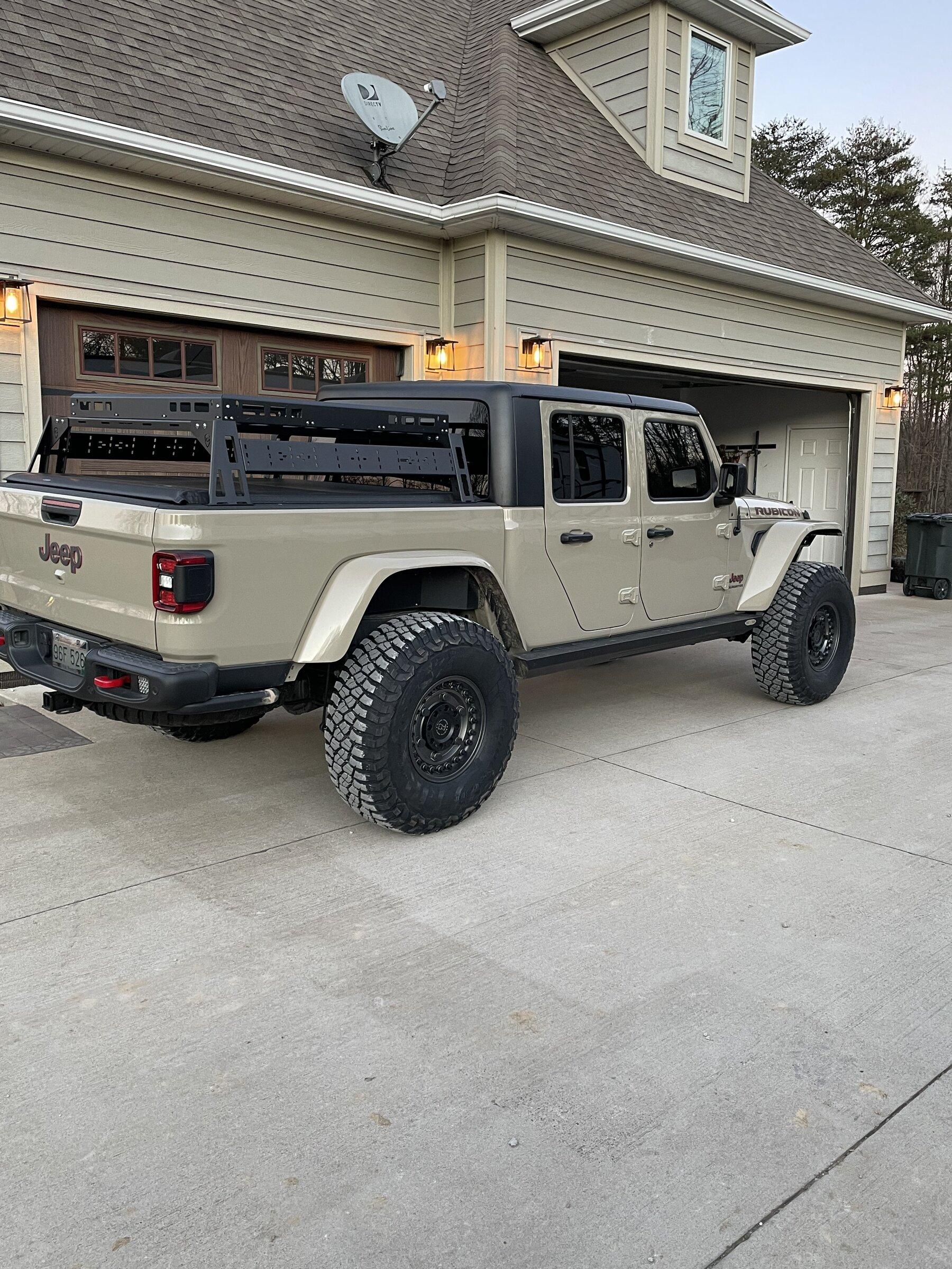

Replaced my 37x12.50 km3’s.
Nice and quiet, ride nice and look great. They seem to work well with 5:13s, and the truck operates in a better rpm range than the 37’s, which really measured 35”. Might as well say the BFG runs about 2” smaller than advertised, lol.

Looks good, how much lift and what system

For now, 2" mopar w/ 1.5" TF spacer in front. Figured with the AAL chopped fenders they would clear aight. Haven't twisted it up yet tho, but I think it will be fine for the mild wheeling we do around here.

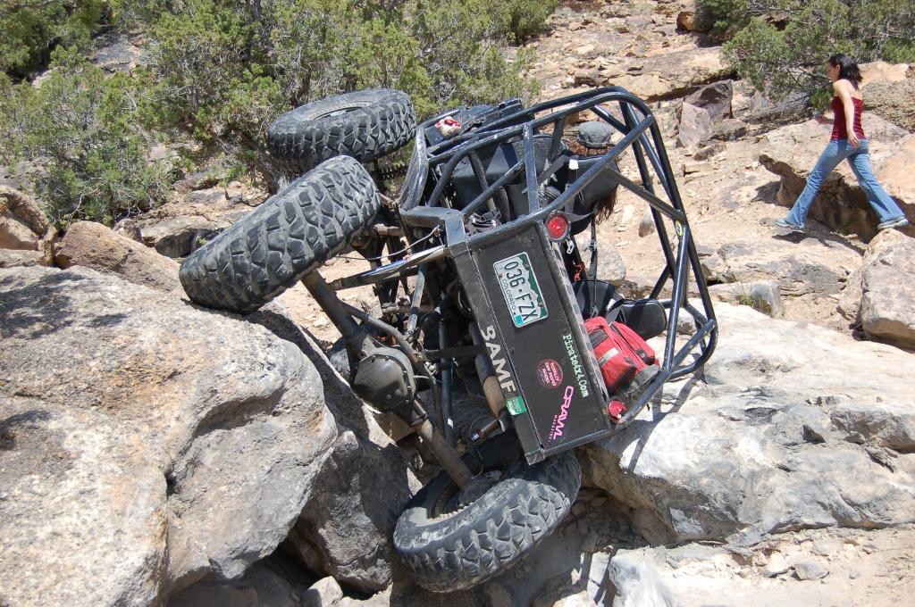

I run a set of either 37's or 39 red lable sticky's on my YJ.
Here's what a set of 39's look like twisted on a YJ. That's my friend Val driving - she ain't skeered of rocks. :giggle:

What are your wheel specs?

That looks absolutely amazing! What’s your plan of attack for the spare situation?

it always amazes me how this truck just swallows tires. 39s on a wrangler look huge, and 37s on a raptor look massive. On a gladiator, those 39s look at home

I have a 37" km3 on matching wheel in the spare. Will be enough to get me somewhere should something happen. Also, carry plug kit, and have on board air.
Black Rhino 17x9 or 9.5, can't recall, -18 offset

Facts! I have terrible proportion distortion. No wonder so many go from 35s to 37s in less than a week. I’m getting ready to re gear and was all set in my mind to just run 35s but sometimes the 35s just look too small in that wheel well.
