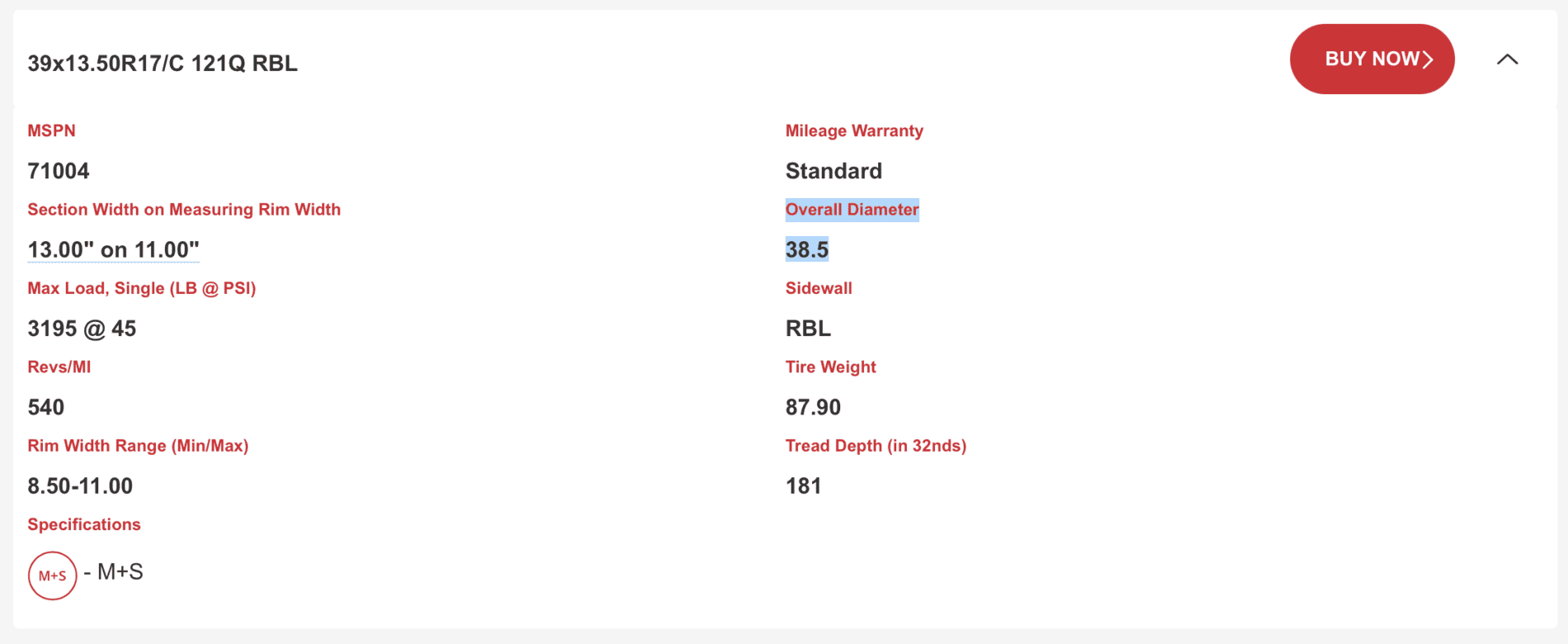

Per BFG site 39" KM3's run at 38.5" overall.

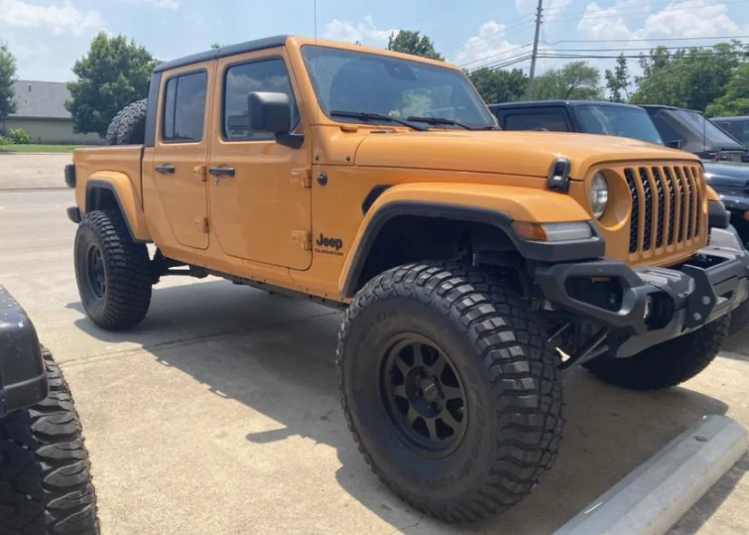

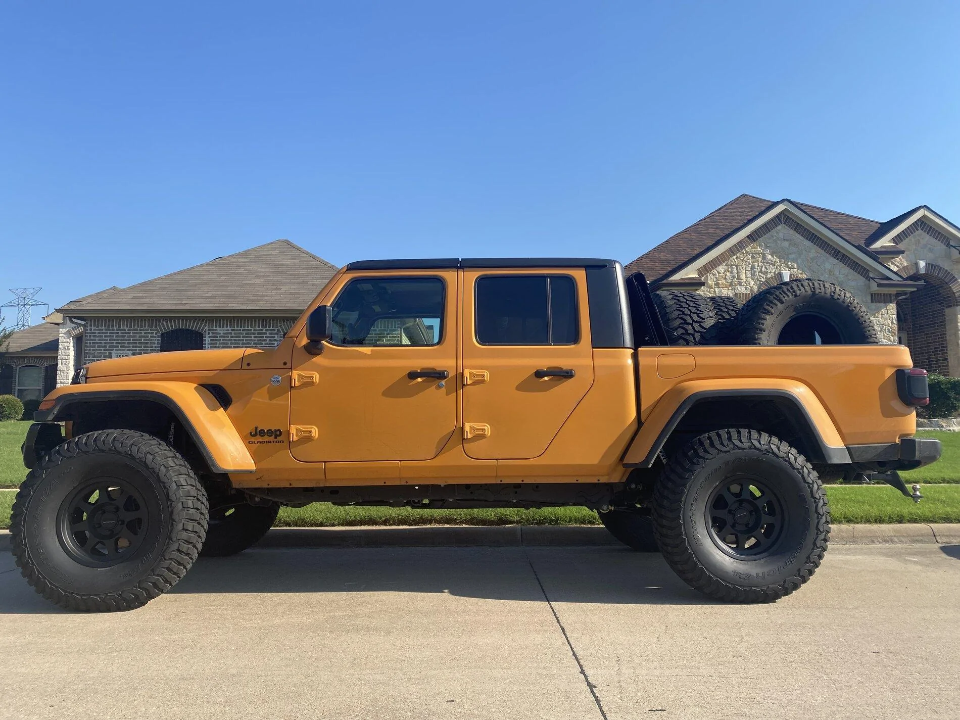

these are method 701s 17x85 0 offset. It was a touch too tight under flex and against the steering stops in reverse so there’s a 1.75” wheel Spacer. These are the sport width axles diesels don’t have a max tow option.

66.5 vs 68inches. So 1.5inches wider
Thanks. I'm wondering if I could get away with running these 39s without needing wheel spacers like the other poster here. I have the same wheel size, offset, and backspacing but he ran a 1.75" spacer.

no. It’ll rub front control arms. If You don’t want to run spacers I’d suggest returning the wheels you got and getting something with a -18 or deeper offset. -12s had issues also. I waited almost 3 months for my wheels or I’d have returned them.
knowing what I know now, I would have got something -12 and chosen the 39/12.50 kanati mud hogs
I do however love the bfgs and i since I’ll be swapping axles this winter I see how reason to throw more money or time at this.
