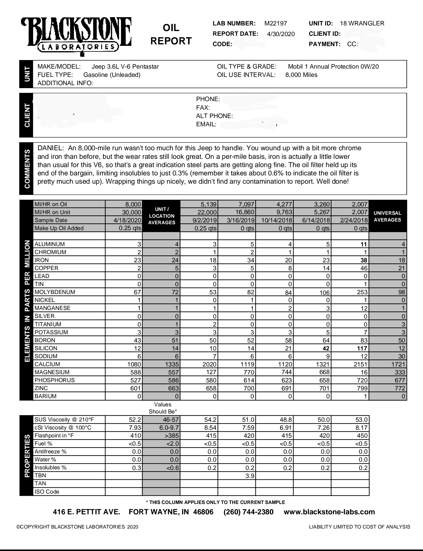

The data from my engine suggests it is not a bad idea to do it sooner. I changed mine at 2k miles and yes, the oil was serviceable and could have gone 7500, but why? Here is the UOA which shows LOTS of shit in there and much of it was present as early as 500 miles.
On my 3.6, wear metals and silicon are FAR greater at 2k than the 4/18/20 sample that ran 8k miles. That right there justifies his reasoning for changing early.
The good news at 2k was that the oil itself was still fine, with a high flash point, no sign of fuel or water and viscosity where it should be. So yep, it could have gone longer. But I didn't feel good with it holding all that crap in suspension and wanted to get it out of there. No harm in that. My 2008 JK 3.8 got its first change at only 500 miles, then at another 1k, then at another 3k, then every 6k since then. Why? It made me feel good. Just like spending money on cigarettes makes another guy feel good. That 3.8 is running like new at 168k miles and counting. So there clearly is no harm at all in getting a little peace of mind while at the same time enjoying maintaining your rig.
