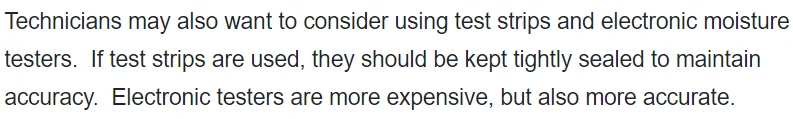

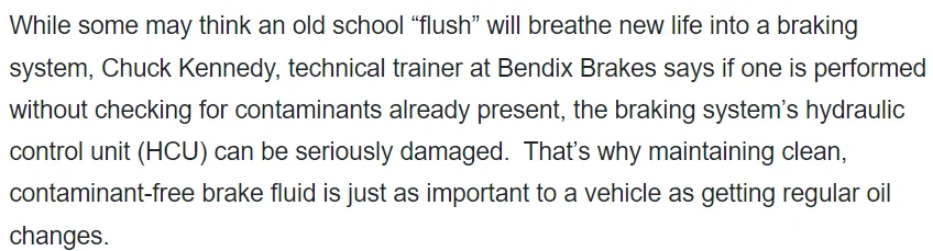

This is from an ASE article - and it's always been true, and is one reason people need to think not only of the moisture situation but the chemistry of brake fluid. It's NOT just a glycol substance - there are other things in it that control viscosity, pH and other factors, including preventing corrosion and so on - so going only by "water content" alone isn't great, either.
Anyway, this from ASE -
What kills rubber parts is when the additive package breaks down. The additive package controls the pH of the fluid and the viscosity. If the brake fluid becomes unable to control the pH or other corrosive elements, the rubber and metal parts will deteriorate over time.
That's a quote from the people who "certify" your mechanics/techs.
