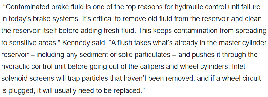

Trained (and some of that factory training) - we were taught (and this came from Bendix, Wagner, and others) that you flush every two years. I took some ASE tests years ago and seem to recall it being mentioned there as well.
Of course, things have gotten more complex, and hopefully, more "sealed" since then, and the use of different materials in cylinders, calipers, pads and so on would help so today they recommend using test strips or an electronic test device.
Just like we were taught in college when it was more of a "1 to 2" years recommendation, before coming down to 2 years and now "test the fluid" - Bendix to this day still says pull all fluid out of the reservoir and wipe it totally clean of all debris before flushing.
More than one tech has ruined parts by simply flushing and ended up pushing debris through the system, locking up parts down the line.
I can tell you from not only college training, but other sources, such as GM and Ford factory training, that yes, they recommend flushing and yes, even to this day - but it's now more a matter of testing than time.
It was never ever about miles when we were trained (I have some training direct from Bendix - although a tad dated these days) It was always about time.
Brake fluid isn't sensitive to how many miles you've driven, it breaks down over time and absorbs moisture over time - thus, the time factor "every 2 years".
This is from an article, the fellow - Kennedy - is a technical trainer from Bendix Corp. -

Don't just pop the pressure adapter onto the master cylinder reservoir - use something like a turkey baster to get the old fluid out and clean the reservoir.
