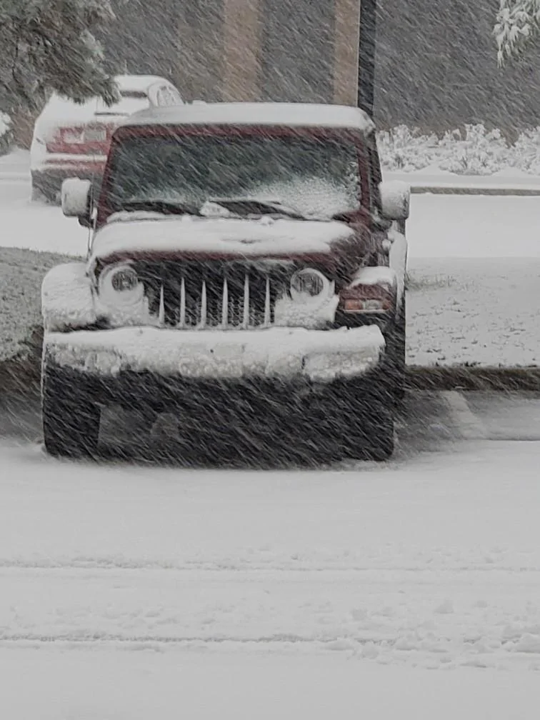

I've been watching this thread closely. I like the looks and function of the heated oculus, but have waited on ordering to see what comes of the burning elements. When Oracle figures out the solution to the problem, I'll consider ordering in hopes of solving this:
Jeep Gladiator Forum Exclusive Groupbuy from ORACLE Lighting: Heated Oculus 20220103_091439
