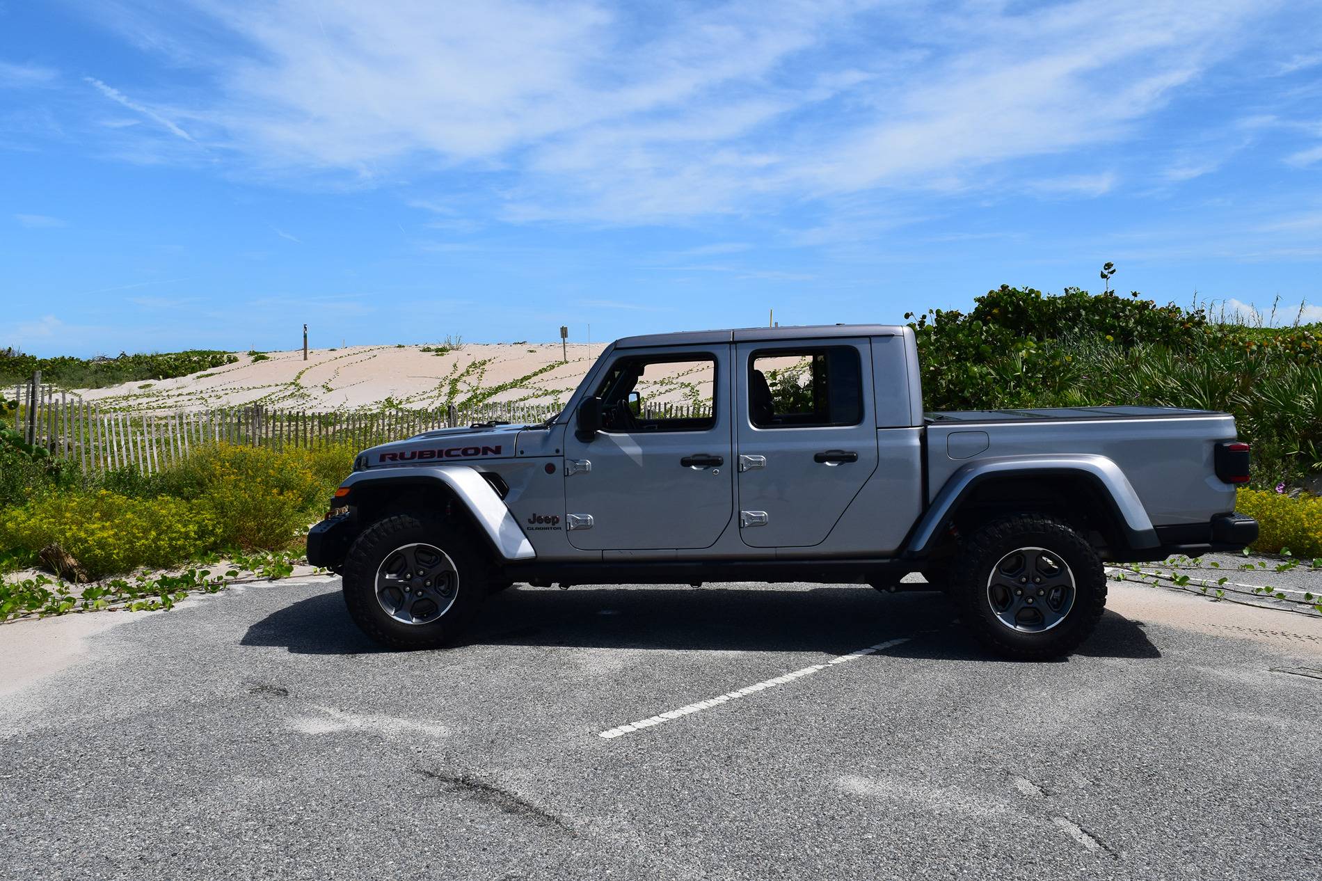

Hi all, I just got me a sweet 2020 Gladiator Rubicon that's pretty well optioned out with the exception of the forward trail cam, I'm wondering if this can be added without too much hassle. Thanks and here's a picture of my new (to me), Gladiator.
Welcome to the obsession!!!! OlllllllO
I went with the Zautomotive front camera. Works pretty well
