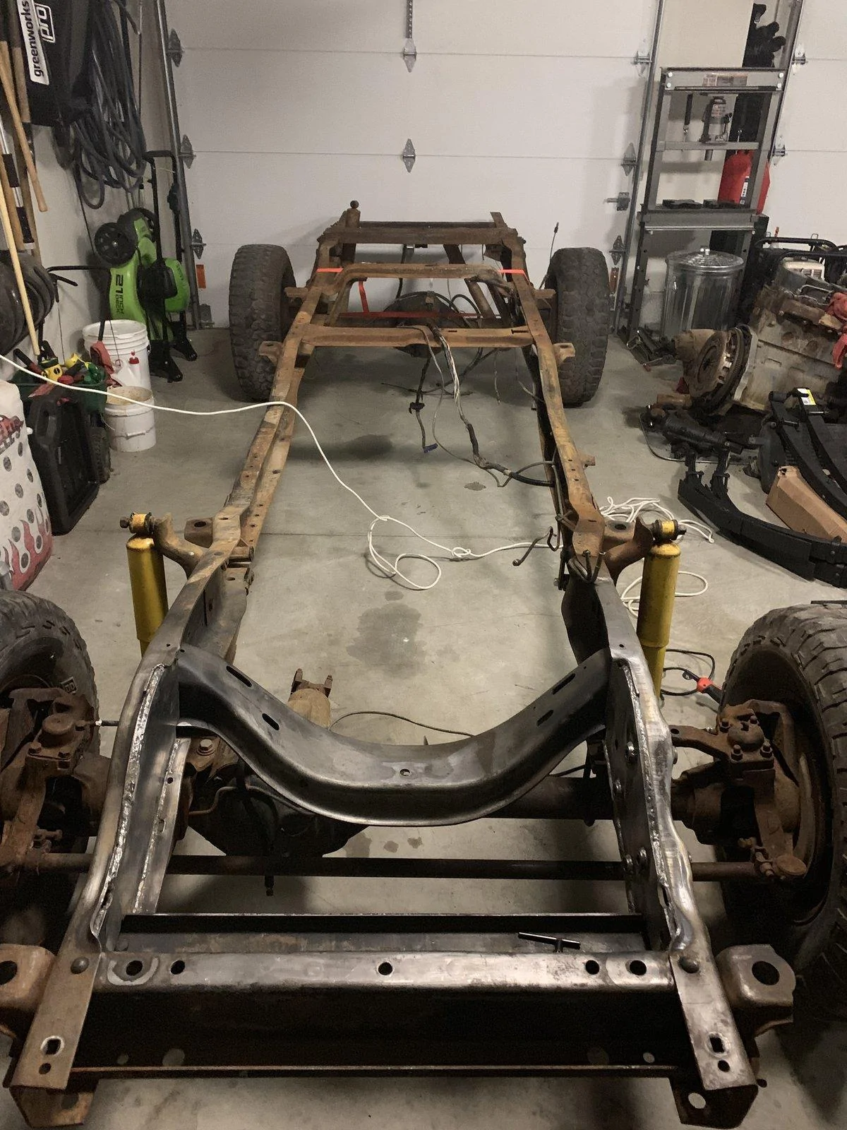

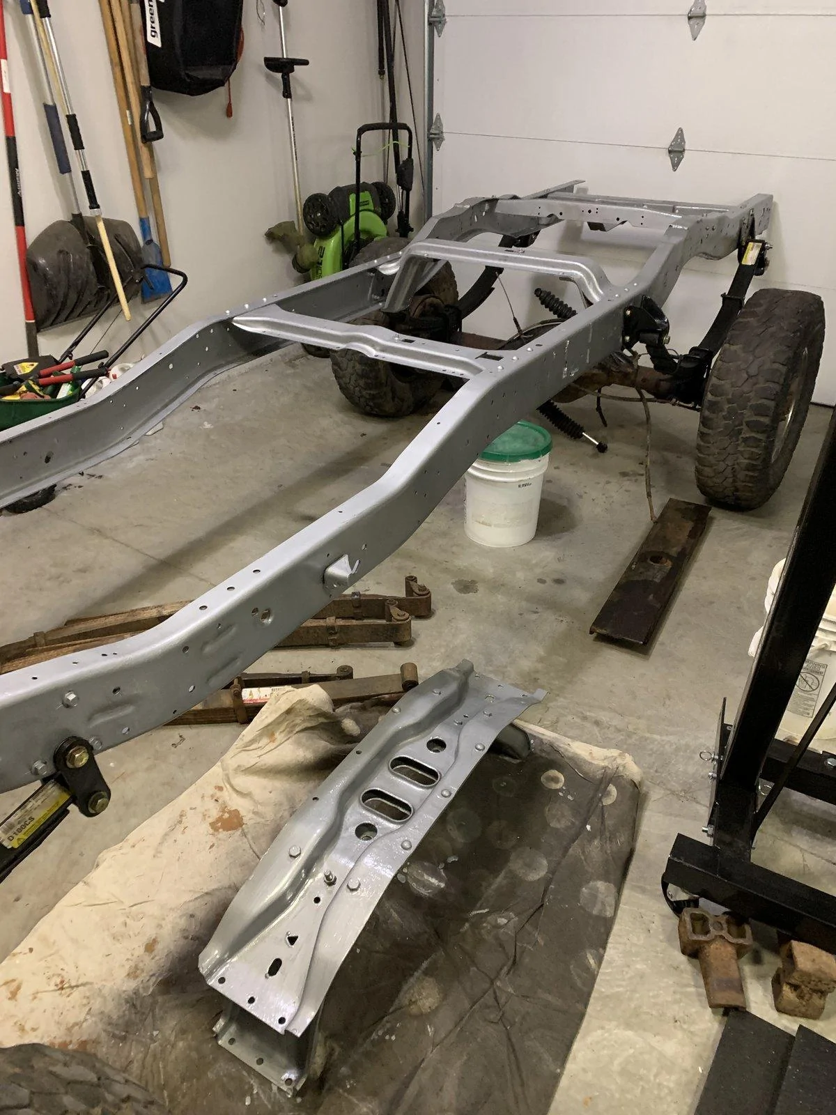

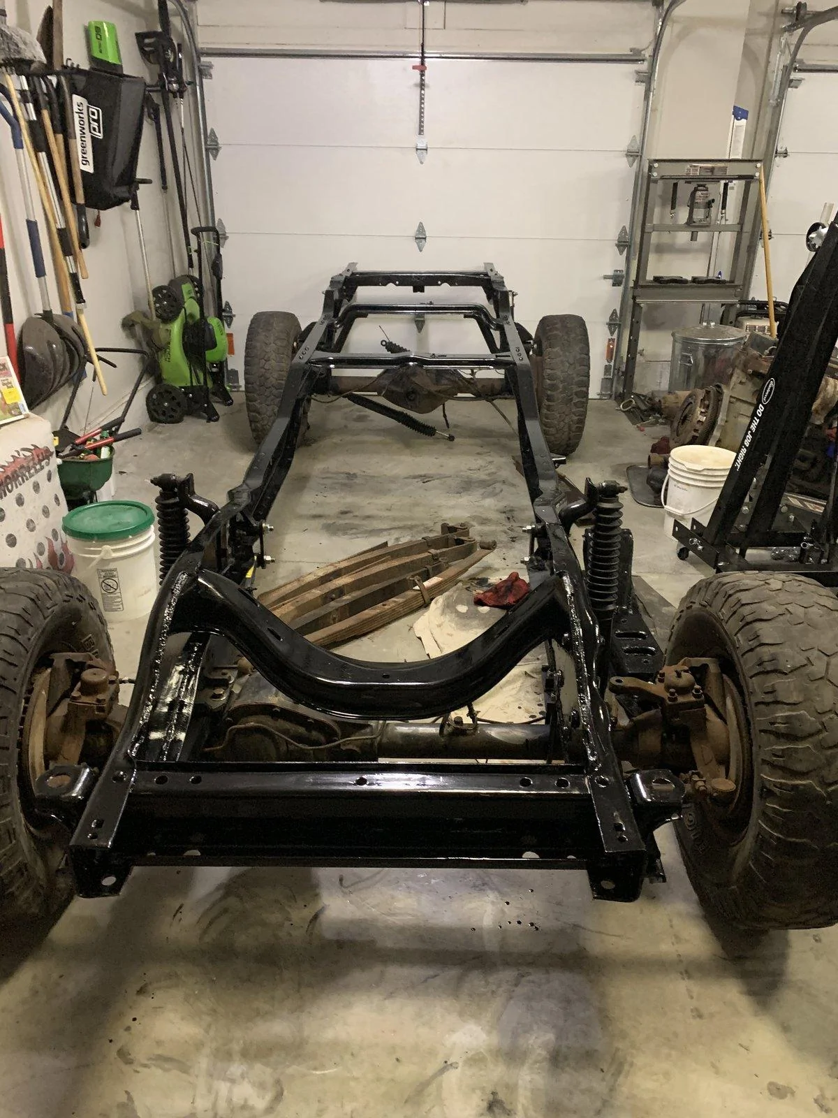

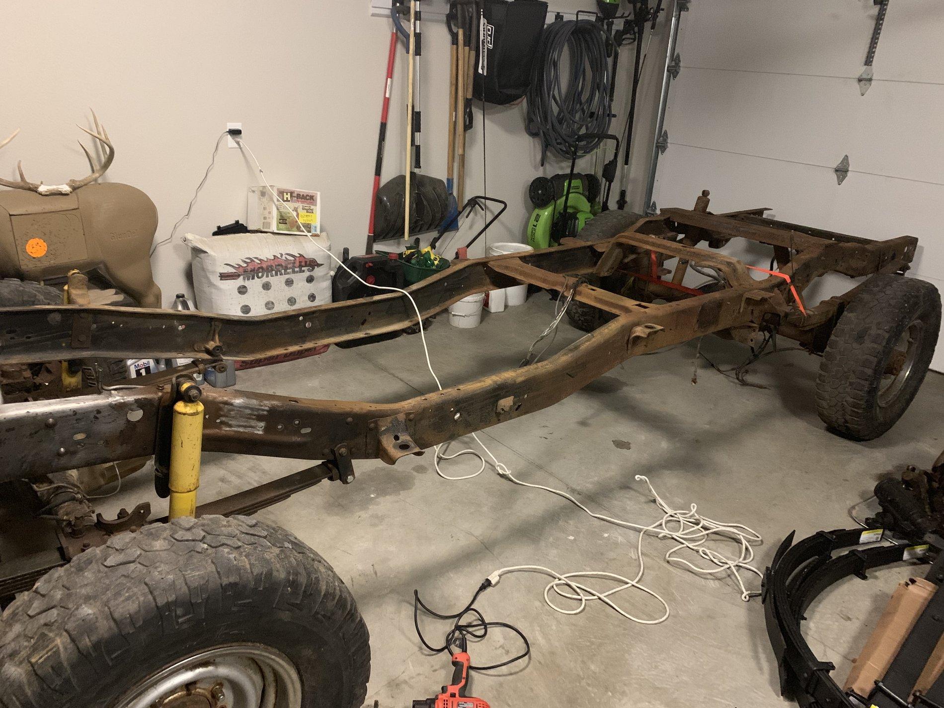

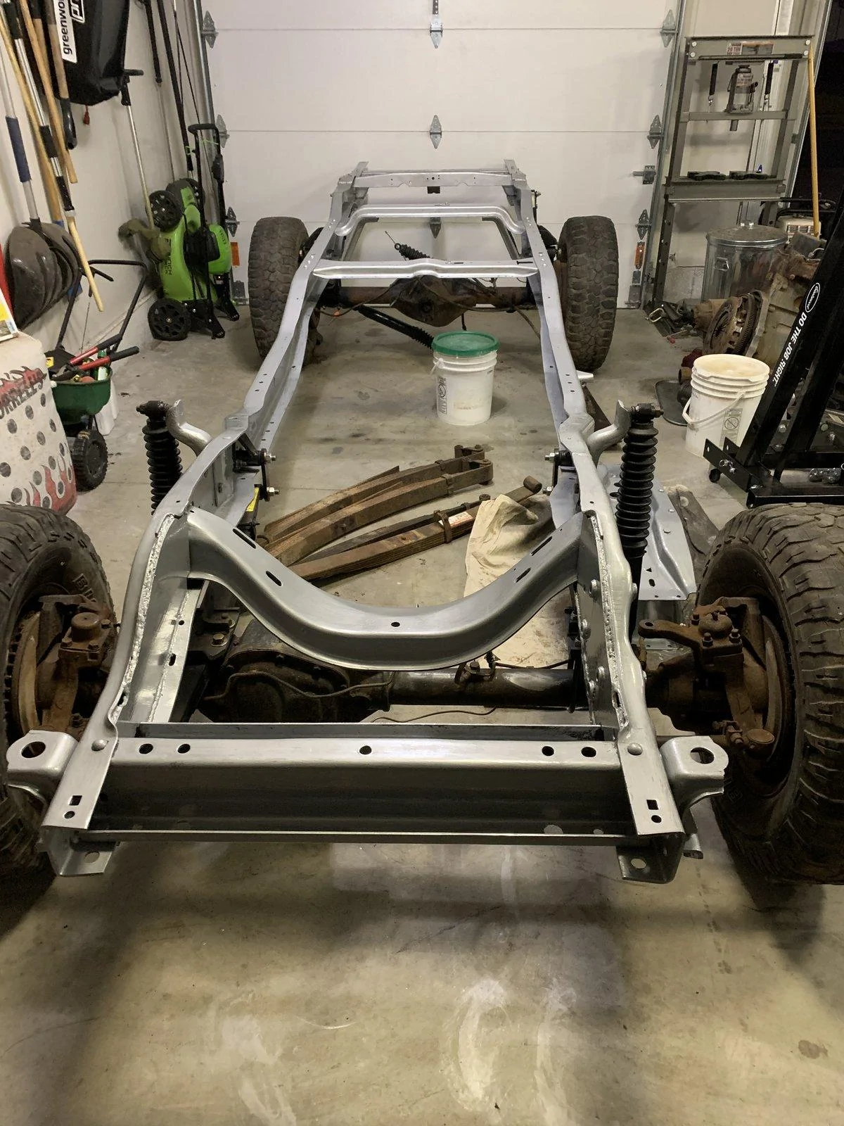

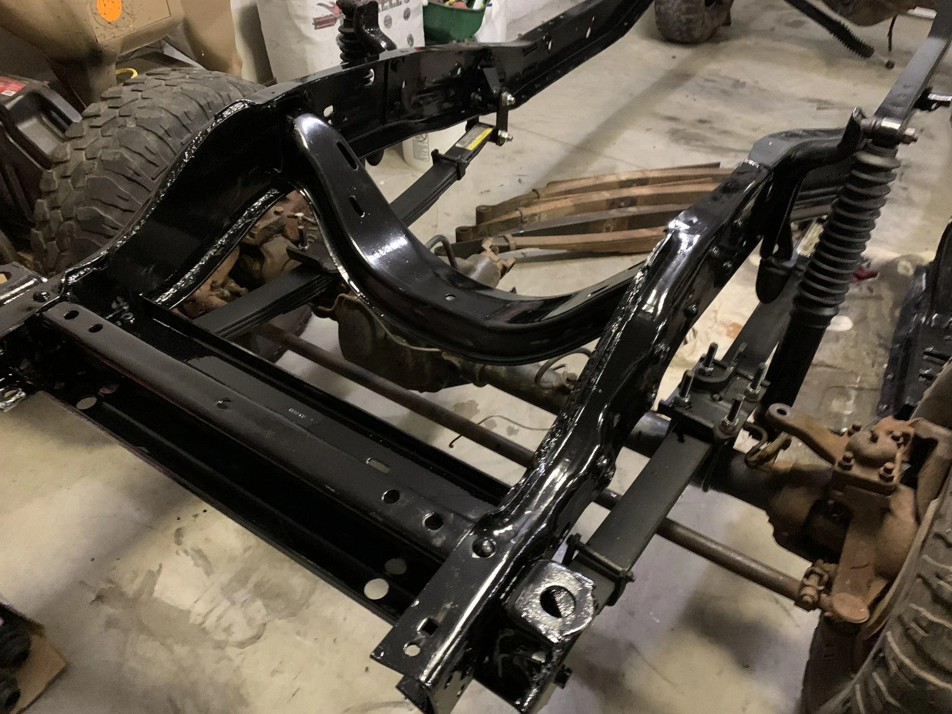

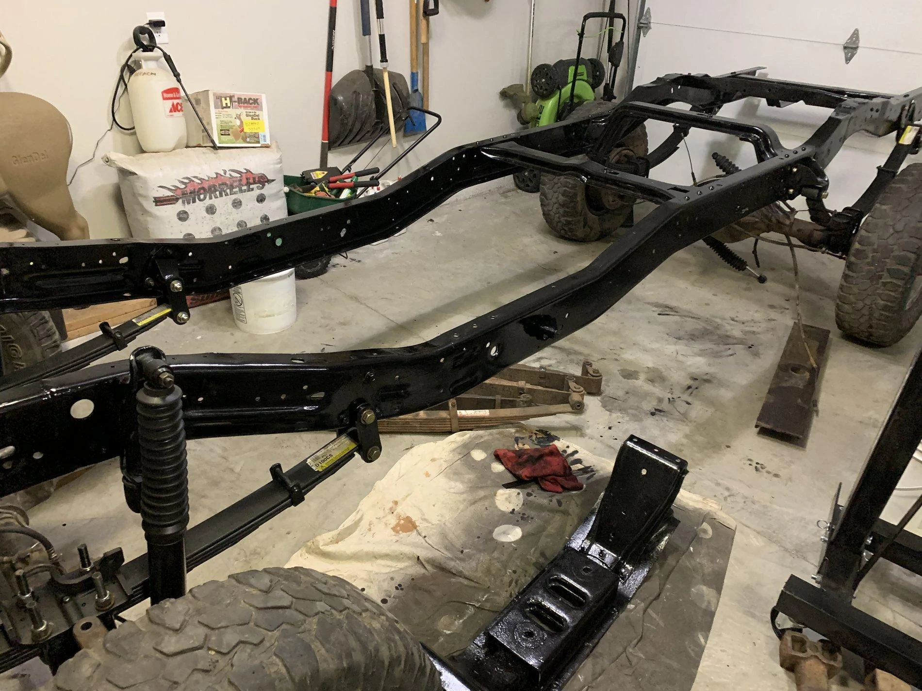

I love Eastwood Rust converter. I was restoring a 1962 International harvester Travelette crew cab truck and used Eastwood rust converter on the entire frame and it was night and day difference. Firm believer and recommend it. Here is some before and after and this was all rolled/brushed on:
well now I am considering Eastwood
So Por/Eastwood then Woolwax

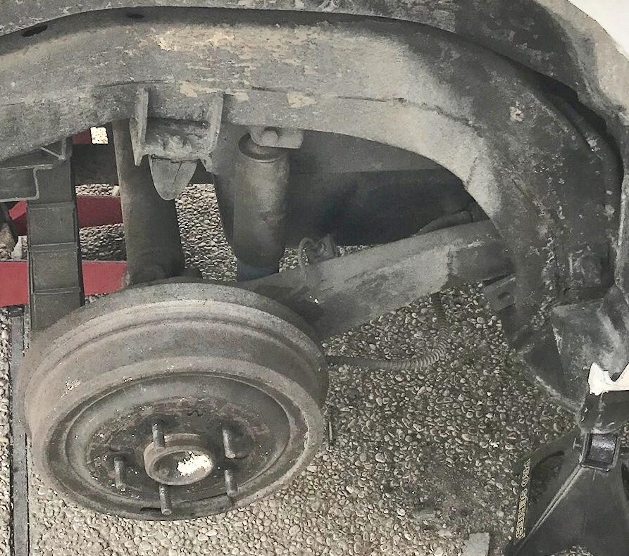

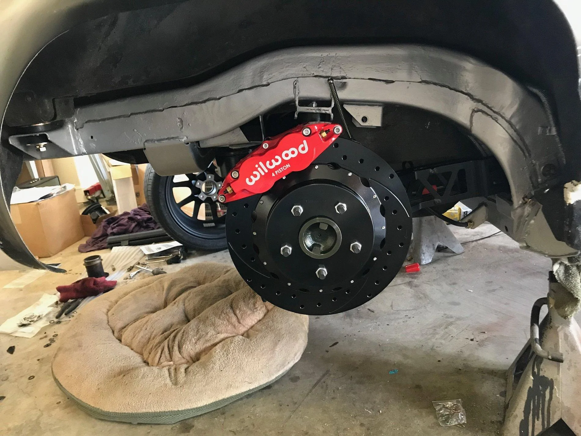

Some people swear by POR15, perhaps swayed by marketing. I’ve used Eastwood products since the 80’s when they had their little store in Fraser, PA and have never been disappointed. You will find negative reviews for both with the most common being “flaking off in large pieces”. In my opinion that is improper surface prep. Both extremes, failure to remove loose and crumbling rust and failure to provide enough surface bite for the converter to adhere are common problems as are failure to remove 100% of oil and grease.
I used the newer Eastwood Platinum rust converter on the frame of my 1964 Corvette and it has been awesome. Here is a before and after picture. I jacked up one side of the body and then the other.

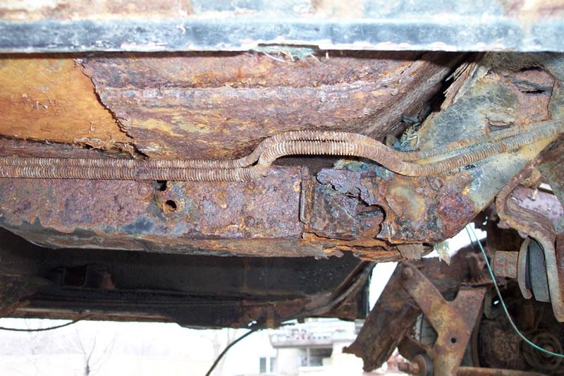

I'm a bit concerned about how to deal with this frame rust, though............

Lol, yeah that one requires replacement.
