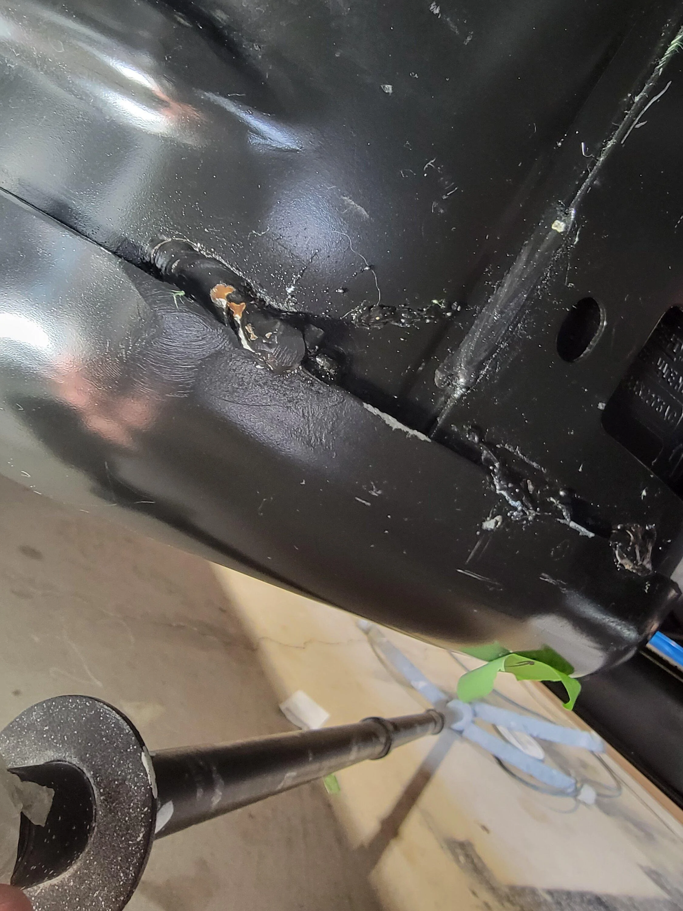

Hey guys I do understand that it’s not frame damage in the sense that it should be a write-off. To me it’s damage that should have been at least disclosed to me as there was an inspection done upon receiving the vehicle at the dealership, if this is missed, what else was missed. I live in Manitoba so no there will be no wknd trips to Moab, I just expect to receive what I paid for is all. Also I have been instructed by the dealer not to apply the fluid film at this point until they can inspect it, unfortunately we have just received our winters first snow storm.

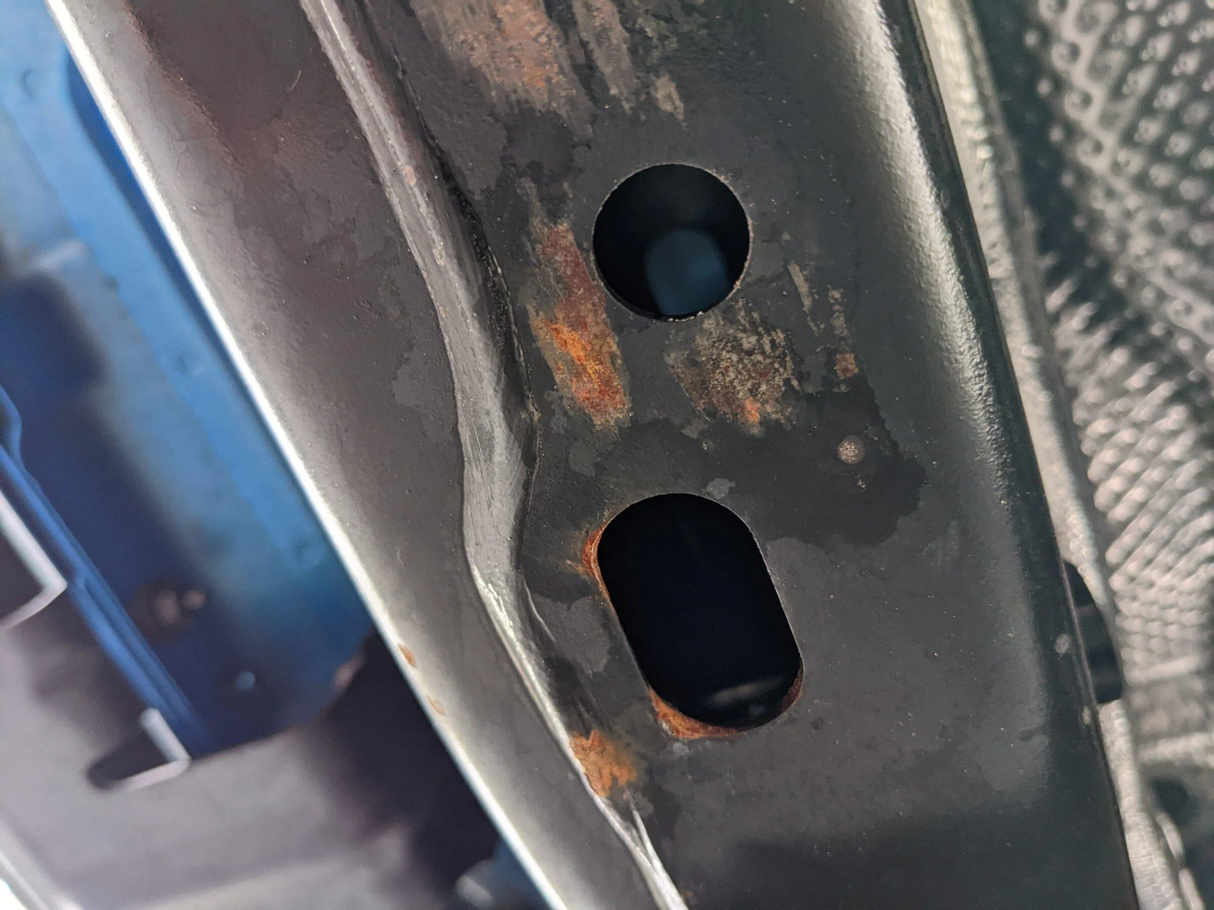

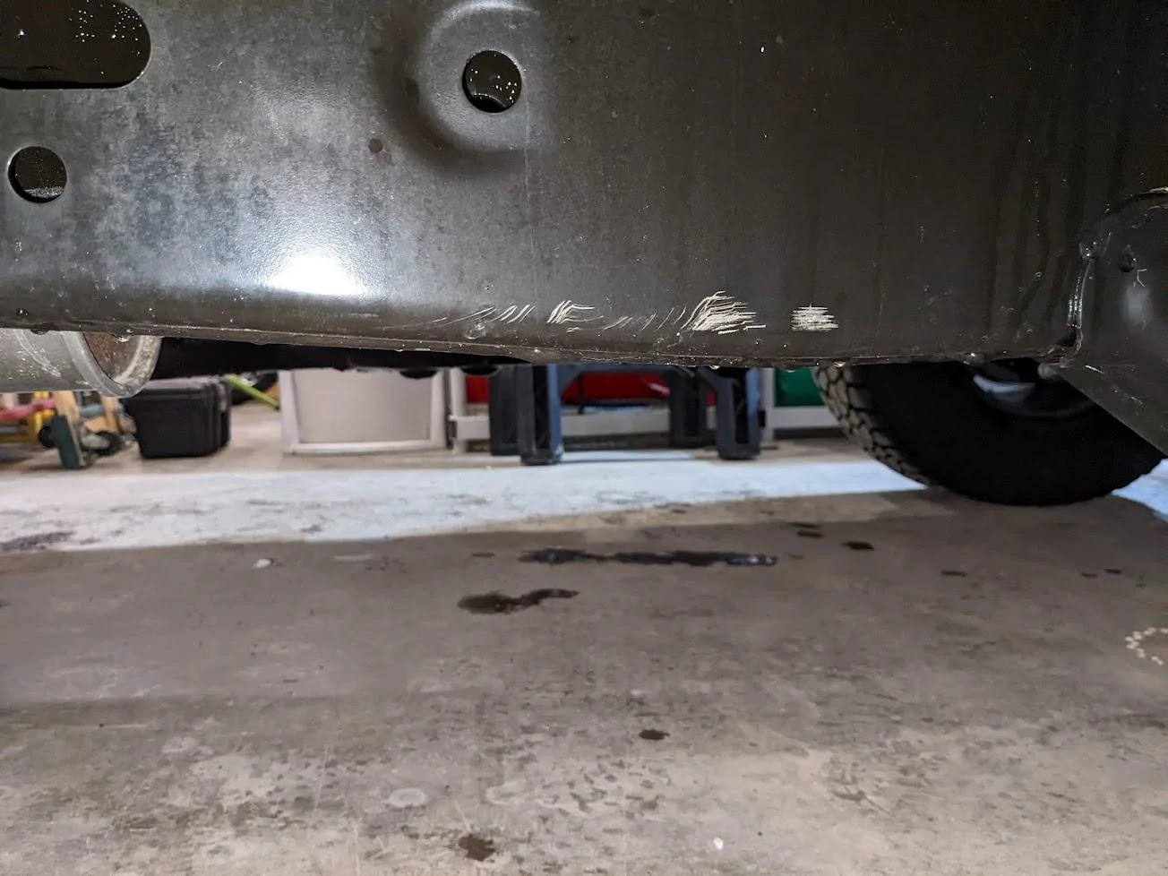

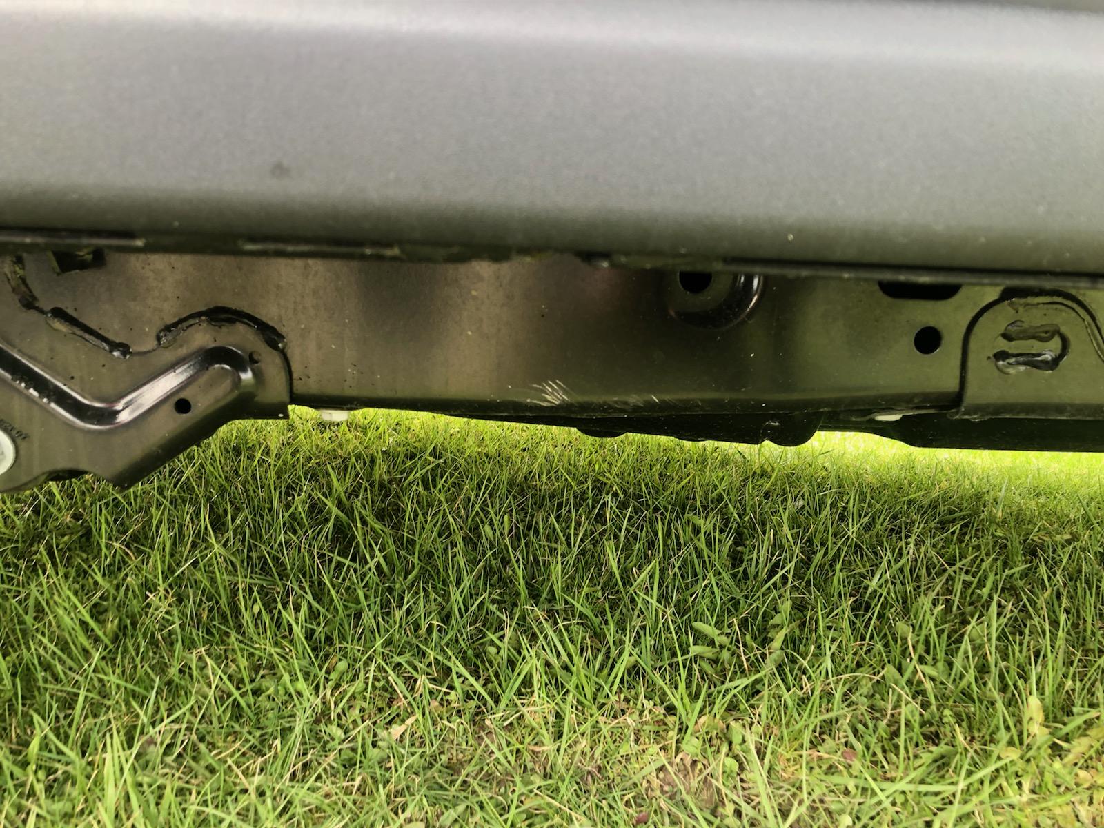

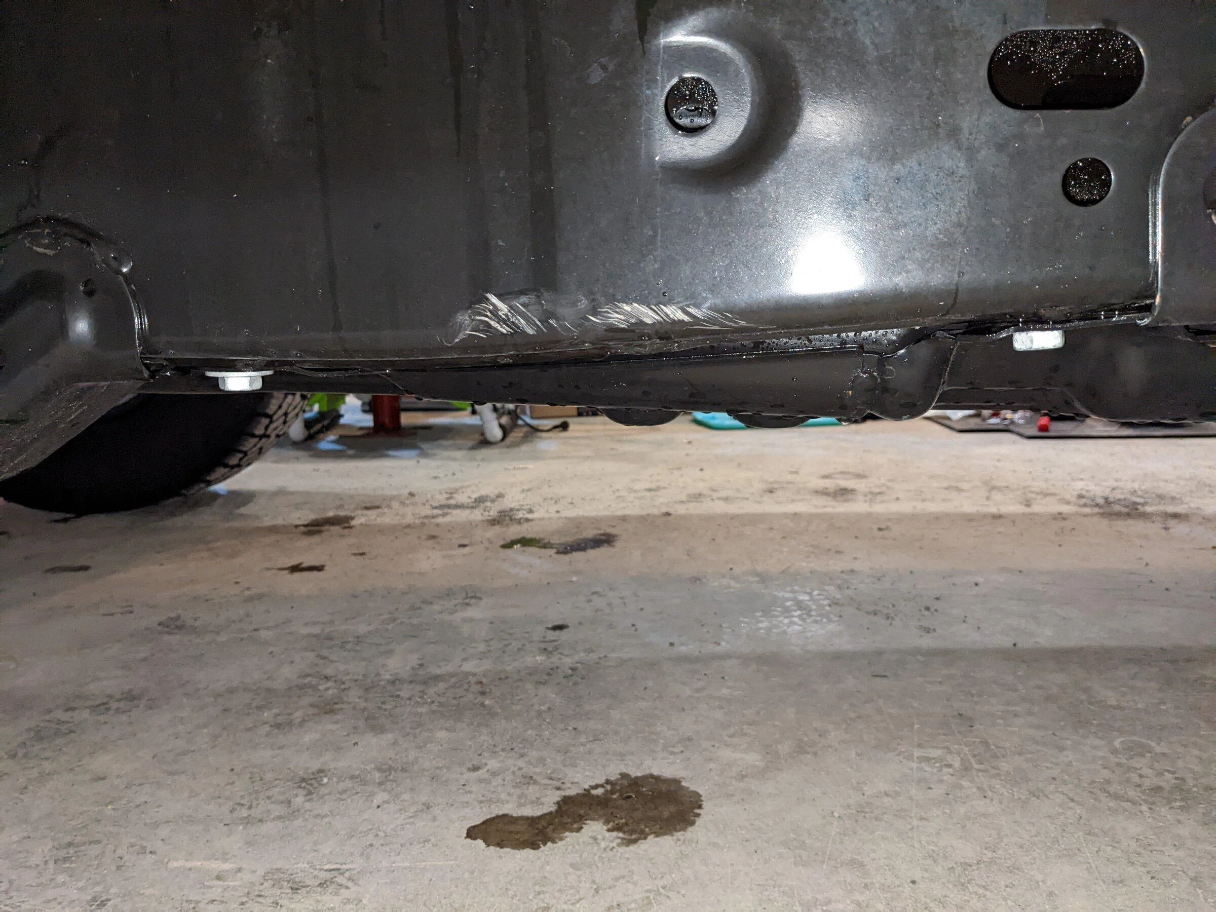

For example here are mine:
Jeep Gladiator Frame Damage on Newly Purchased Gladiator PXL_20220410_023902872
Jeep Gladiator Frame Damage on Newly Purchased Gladiator PXL_20220410_023924865
(freshly washed - ignore the drips)
And a picture the dealer sent me of another one on the lot:

Yea or some rubber bumpers really need to be put on the rigs that hold the frames.
mine had thesame thing. I was pretty angry. But Painted it and hoping for the best. Im still pissed to be honest. But at least its not a bent frame from a bad transport tie down like I have seen others find out

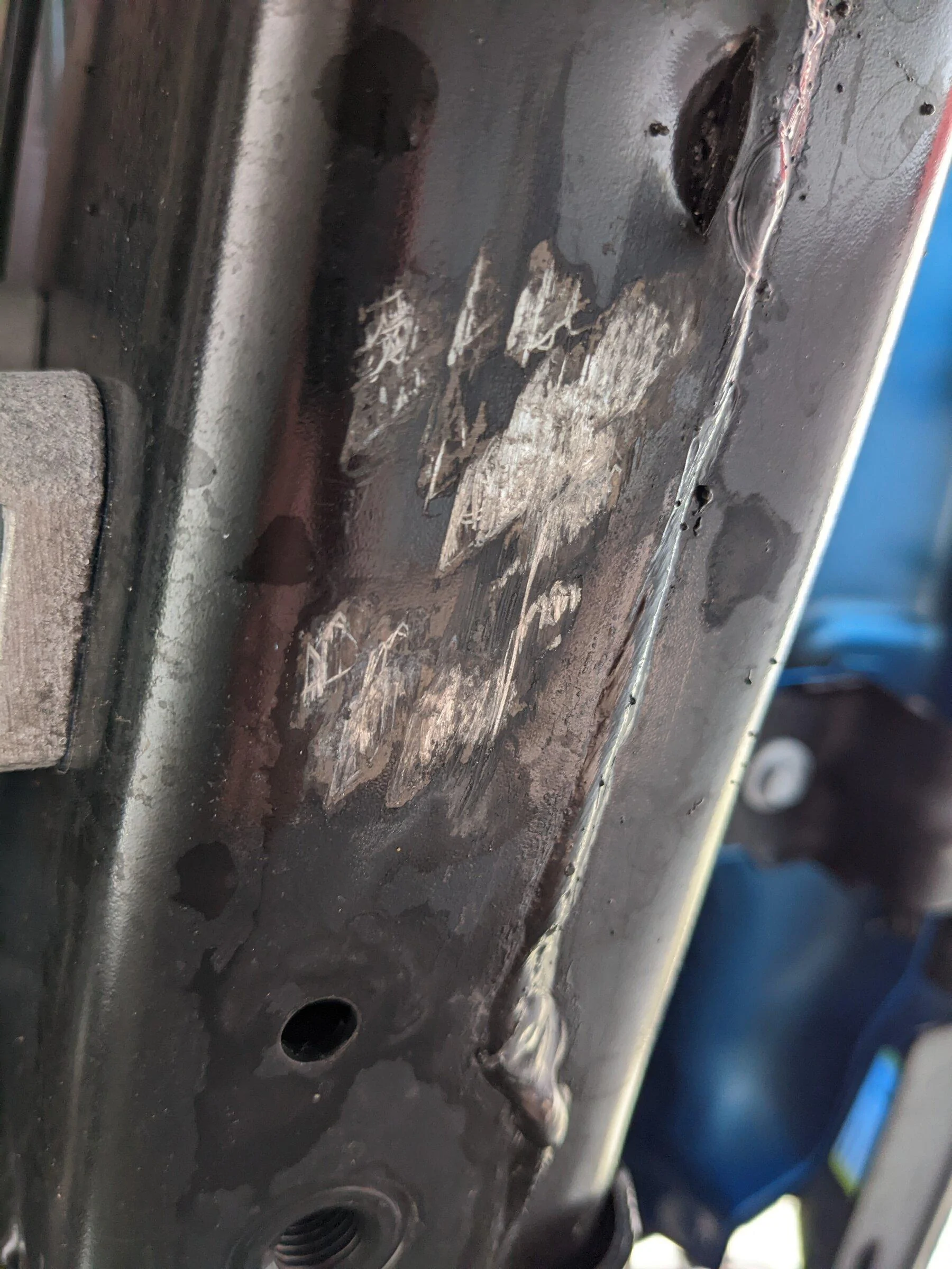

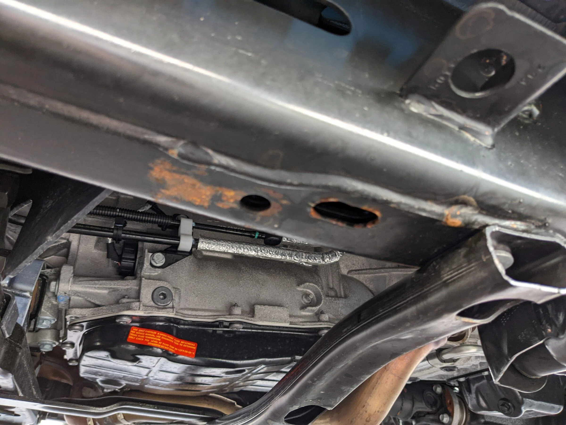

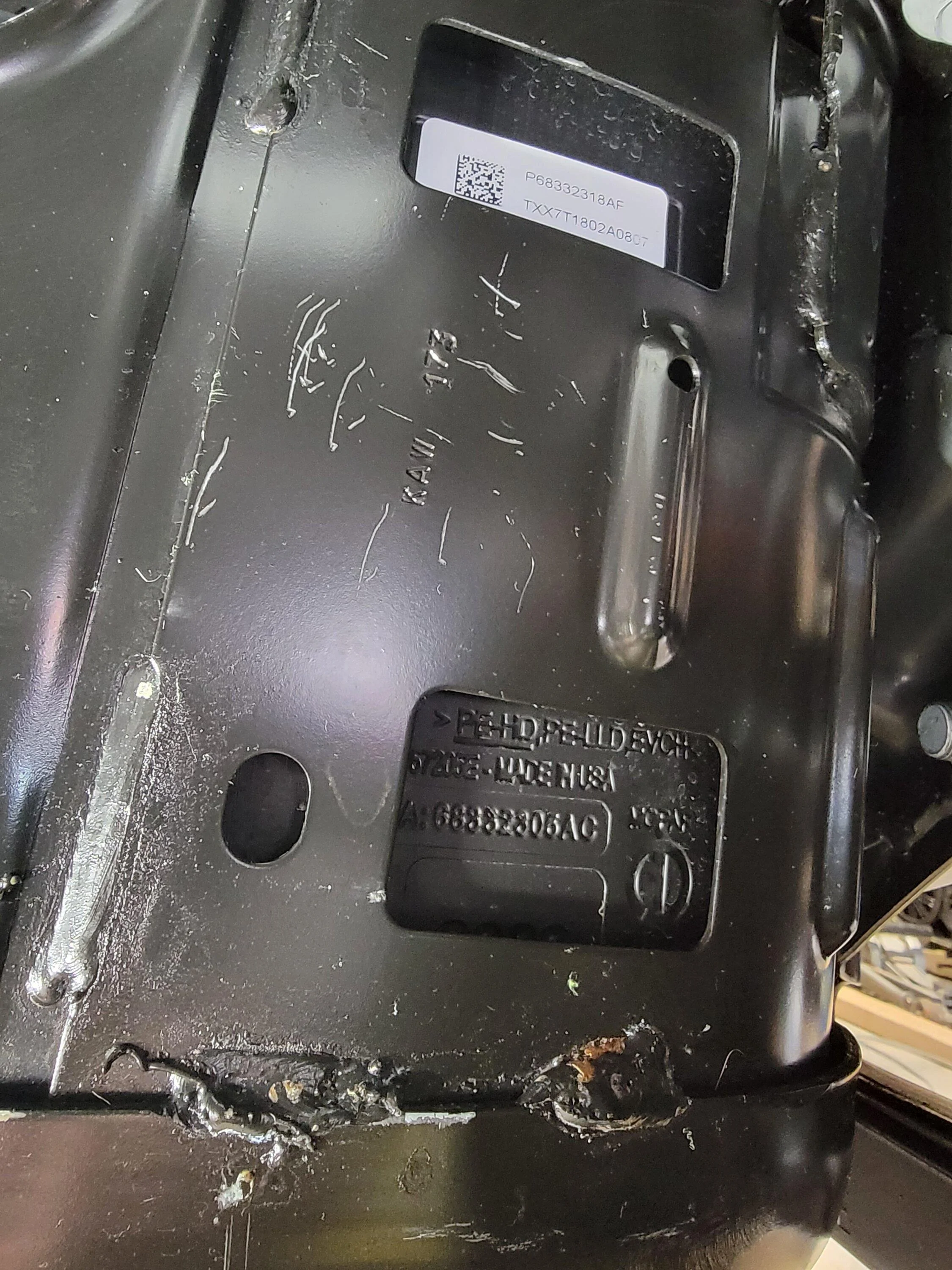

Found a few more crawling under today - they look identical to other folks.
Jeep Gladiator Frame Damage on Newly Purchased Gladiator PXL_20220413_213208511.MP
Jeep Gladiator Frame Damage on Newly Purchased Gladiator PXL_20220413_213138589
Jeep Gladiator Frame Damage on Newly Purchased Gladiator PXL_20220413_213343656

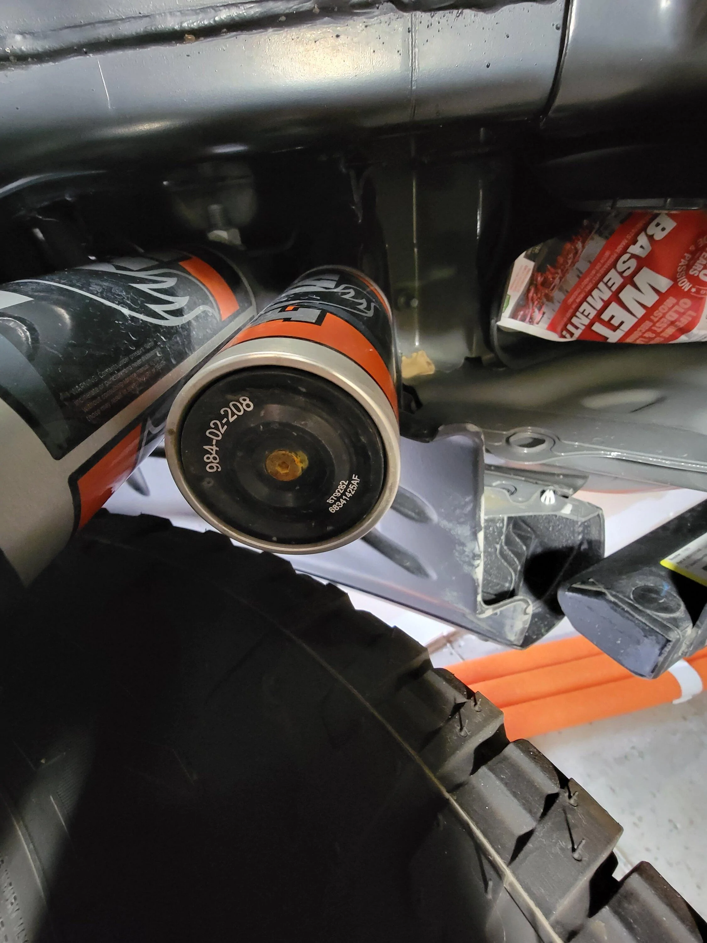

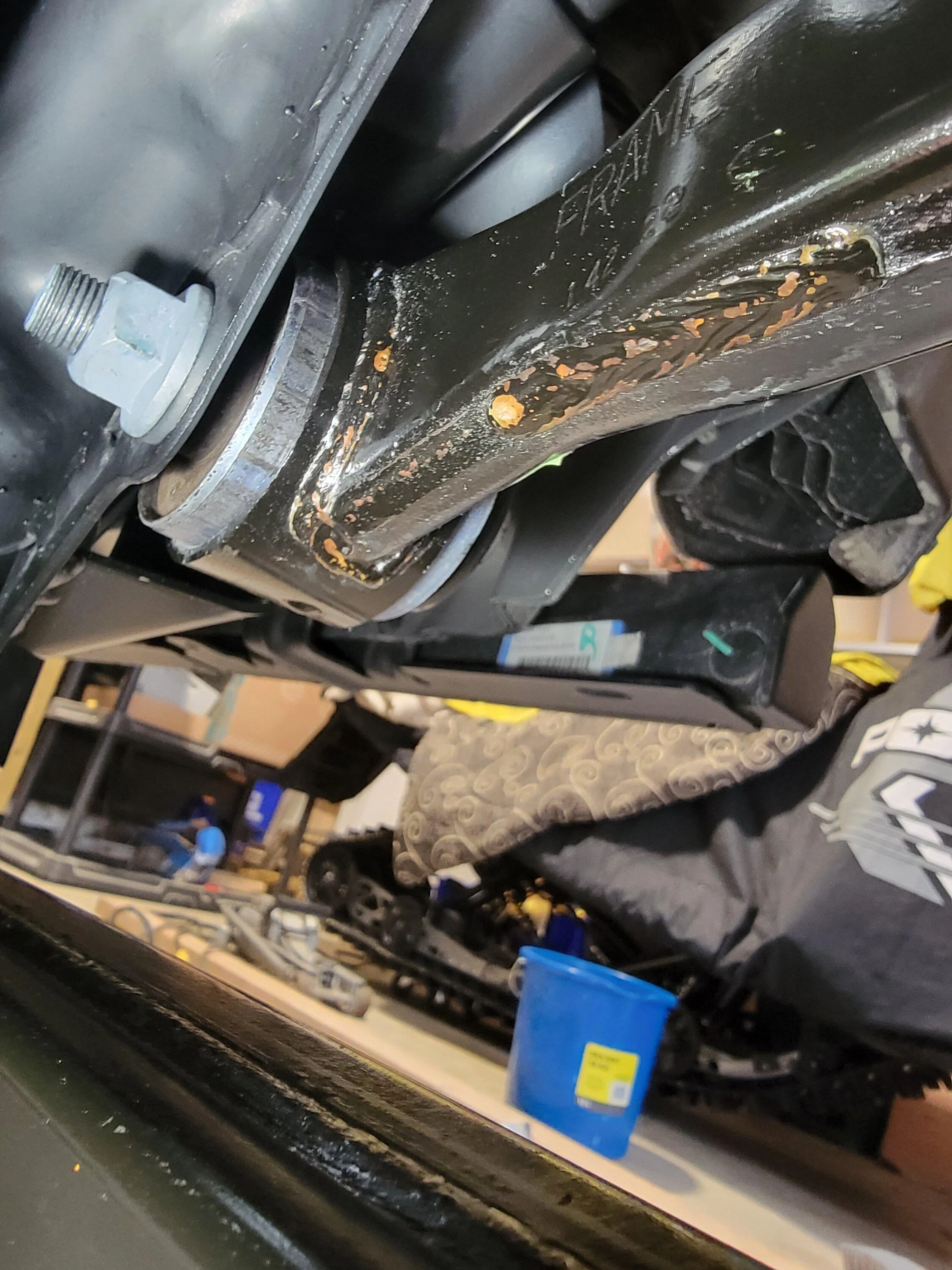

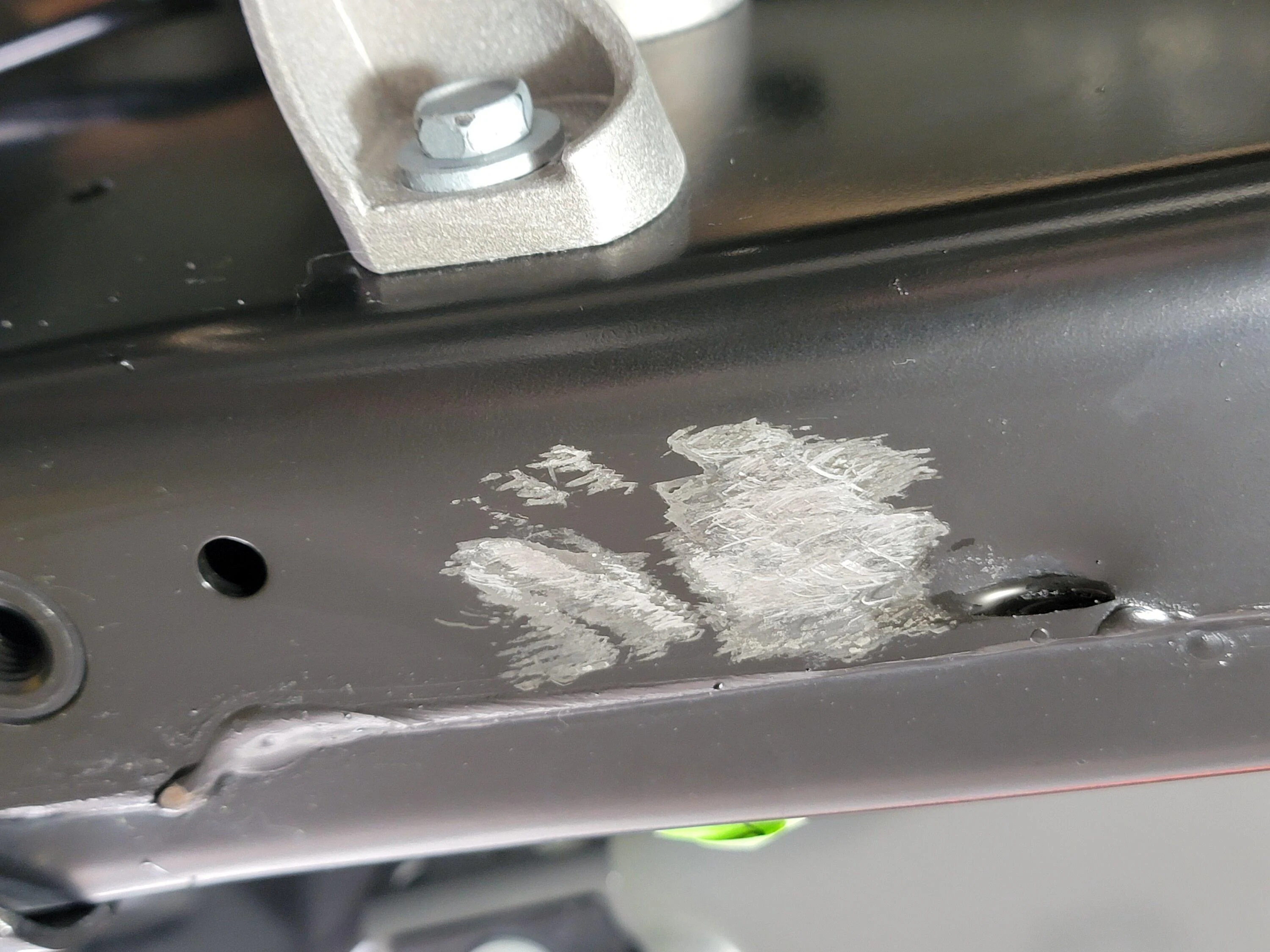

I know it's old threat but wanted to jump in. Went under to prepare my month old mojave to find the same scrapes on mine. I'm more passed about all the rust and scrapes all over and most of my welds have paint flaking off. The welds on the inner side if my gas tank look like a kid too their grade one paint and slapped it on. Paid over 75,000 Canadian and have to spend a weekend prepping and painting. I also noticed my fox shock rusting already. I feel my jeep was thrown together with used parts. Anyone else have these issues?

That's not damage. It's purely cosmetic and would get worse if you actually drove it around where I live.
The fix -Extend rust converter on the rust spots on the frame, wait 24 hours, then spray with VHT epoxy black or Eastwood chassis paint.
It's a truck and frame scrapes will happen loading and unloading and then - take a look under most of the JTs owned by forum members after 1 month and see just how scraped up they are even if not crawling over boulders.
At least it's not actually damaged. You won't find many new vehicle much better unless in the luxury class. It's a truck.
