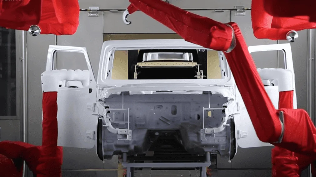

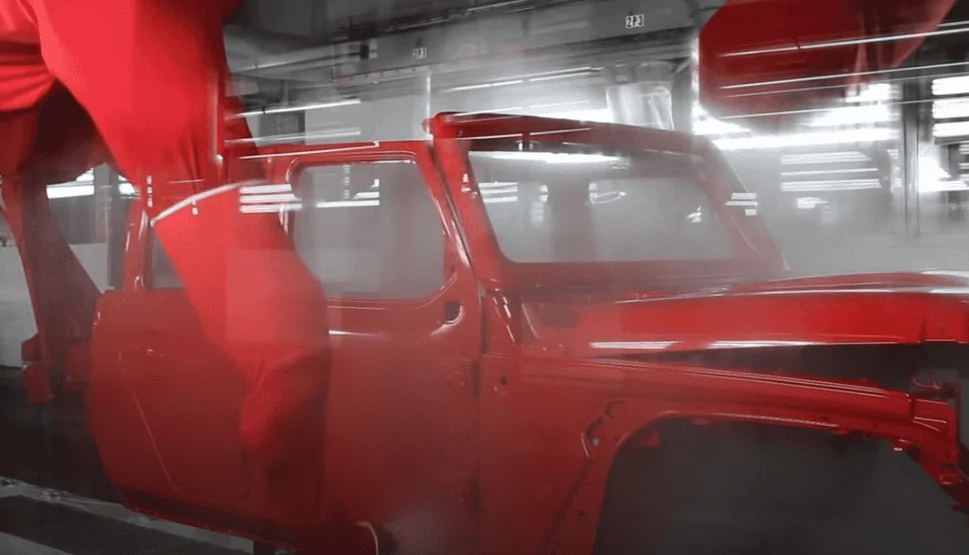

I don’t think it’s that serious. The door looks perfect when closed, but it grinds pretty heavily on the striker, which tweaks the door into alignment. Gaps look great when closed. Close the door and crack the bolts loose on the hinges and tighten back up is all that’s needed. And touch up the bolt heads that will inevitably have chips
It should close silently, the striker pretty much centered in the latch.
That there would bug me, wondering why the striker is what's pulling it into alignment. If the hinges need to be adjusted, that tells me - something was pushed out of alignment after the factory built it. I'd bet that bar had some pressure on it that tweaked the door frame, I'd almost bet on it.
Since these are painted doors-on, I wonder how adjusting the door that much will affect the paint on the door.........
Jeep Gladiator Roll bar damage from the factory 1707328944238
Jeep Gladiator Roll bar damage from the factory 1707329033820

Unless I missed something, if the OP had disclosed upfront the doors and the top being cracked along with the bar damage, this discussion could have been way different earlier.
I think one event caused everything, the bar, doors and cracked top. Somewhere along the line, a half ass job was attempted to band aid fix this and kick the can down the road. I would not put it past the dealership being culpable but I do not know that for a fact but it still is in play in my opinion.
Like I mentioned, the paint thickness testing would let someone know if it was damaged prior to paint or repainted after the fact and with the top and doors being damaged, that puts it either way down the factory line to almost completion or in the transport stage and dealership delivery.
If me, I would be looking at this as a fraudulent defect vehicle sale and if pressing on the dealership does nothing to move the needle, I would be looking and inquiring with either a lawyer and/or state consumer protection department that handles such things. IMHO, there is more heat to bring to this situation before having to eat a shit sandwich over it.
I would also put the money out for a few hundred if needed to get a independent body shop to look at it and measure the paint and give a professional opinion if the dealership is not willing to take this up any further.
