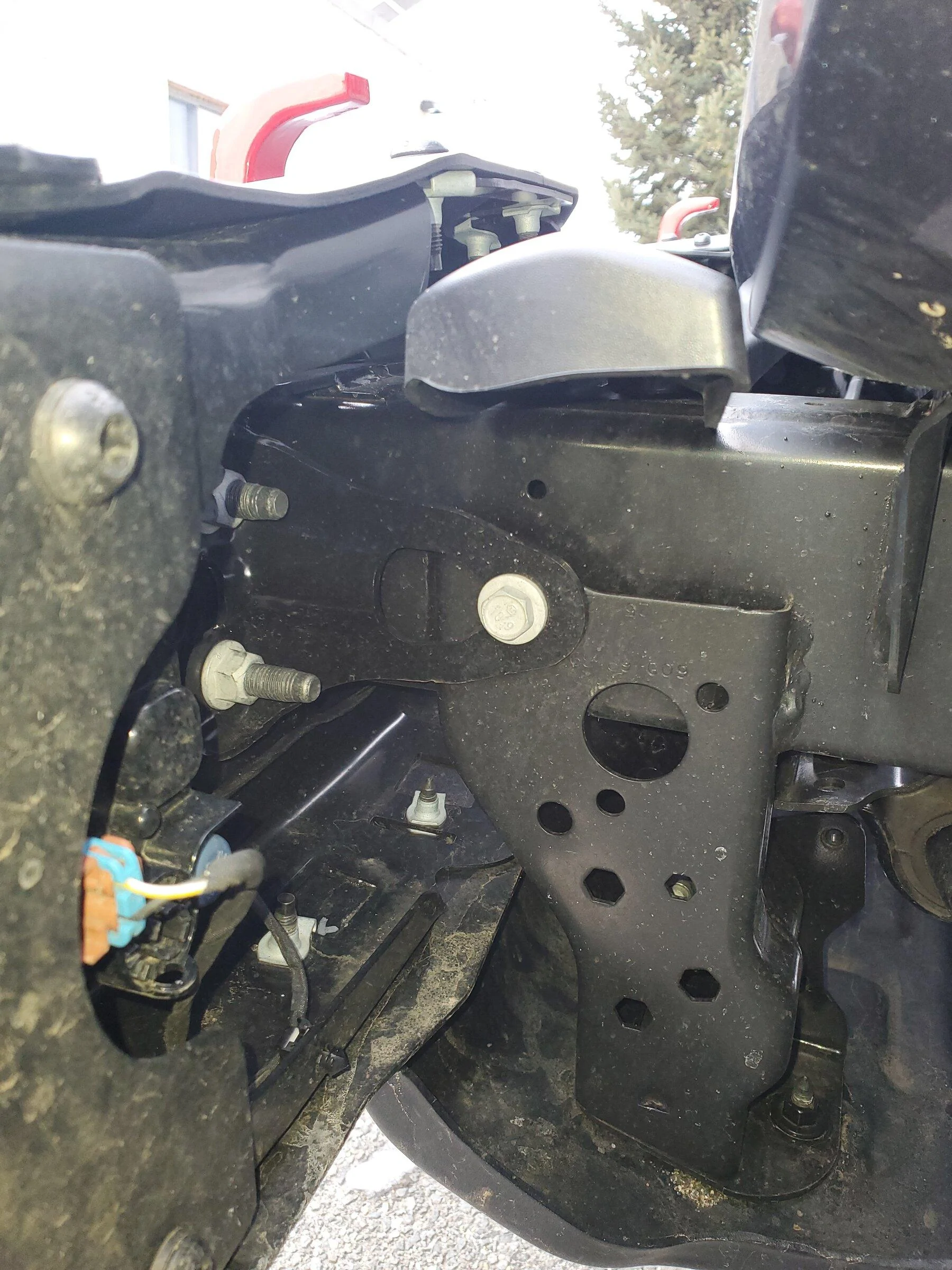

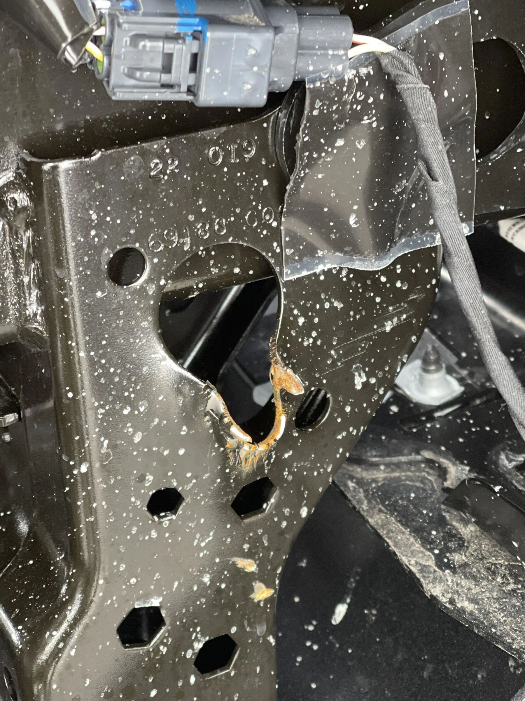

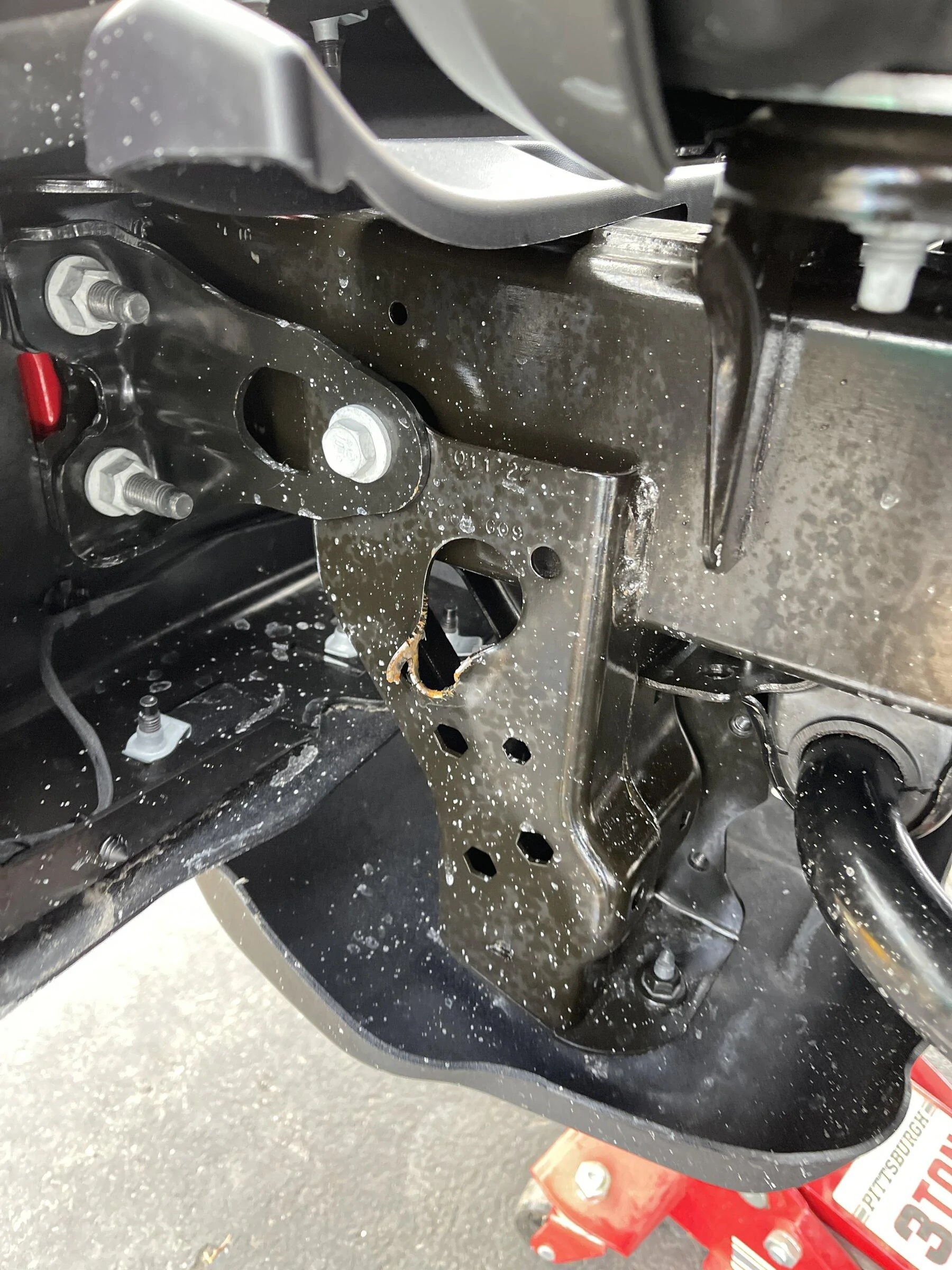

What should I do here? Was installing my lift this morning on my 2022 Gladiator that I picked up yesterday and noticed this.. Both sides.. This truck is Brand New!!
Here is what it should look like for reference.

It’s annoying but IMO it is not affecting anything structural, I would just use a hammer and dolly to straighten it out then spray some paint on the exposed metal. I would bring it to the dealers attention but wouldn’t waste the time to have them work on it and possibly make it worse or screw something else up.

I wouldn't consider that frame damage. That's just a crash/submarine bar that also serves as a lower mount for the front Skid. It's actually cut off by a lot of people for the installation of certain front bumpers. The fact that it tore like that would lead me to think the actual frame is fine. That right there is the weak point, it failed, likely saving the actual frame from any tweaks.
I agreed. Crumble zone when bottoming out the skid plate.

... I would just use a hammer and dolly to straighten it out then spray some paint on the exposed metal....
I would take it a step further.
After the hammer & dolly work, here's what I would do for each side:
1) Clean everything thoroughly.
2) Use 2 hardened steel washers with a Grade 8 bolt & stover lock nut to clamp everything flat while covering the damage. This hardware will go in the smaller hole.
3) Before installing the above hardware, slather everything with JB Weld to 'bed' it in and seal everything against moisture.
4) After hardware installation, wipe off all excess epoxy.
5) After epoxy dries, paint with your choice of black paint.

To me it looks like the dealership did a half ass inspection and set up for the customer. These pieces are visible when checking the tires---not hidden away between the frame rails. Not unexpected as new mechanics are often assigned the PDI [PreDeliveryInspection] on new vehicles.
While I know there are many clueless personnel at dealerships, I would bet 90+% of the leadership in the service departments know that the most risky part of transport of a new car to the dealership are the car carriers. The stress on the suspension is huge even when they are properly tied down. Thus the person responsible for the acceptance of the vehicles as they get unloaded should have seen this. Common issue is that person has "better things to do" and doesn't or barely watches the unloading and then blanket accepts the vehicles.

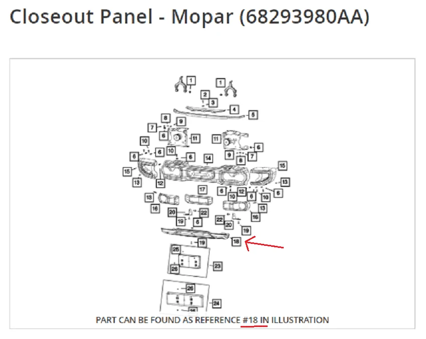

"... when bottoming out the skid plate."
So, I am not the only one calling it for what it is and not what it is not-air dam. It is plastic, made to deform to absorb hits and protect the components underneath.
40,503
54,023
Pretty sure they are referring to Rubicons with a steel skid plate.
That piece of plastic won't protect crap.
I've busted pieces like that before ... on hard snow.
It's called a close-out panel on Overland.
Skid plate is the steel piece. They are even different in the parts listings.
(There's nothing up there to protect on an Overland anyway, not really.)
That thing has really cheap tin pieces that hold it on the rear and plastic push pins hold it on the front to the bumper. It can easily be ripped off, mangled.
Skid plate = steel and can protect.
Close-out panel = plastic, I can grip one and rip it off with my hands. It's held on with plastic pins and sheet metal screws to sheet metal brackets on the rear of it.
It does pretty much nothing but cover the underside, like the engine cover does before they got rid of it.
Anyone thinking that cheap $25 piece of plastic is going to protect anything will get a big surprise.
I've had both on my truck and have having ripped similar panels off other vehicles in our snow, I opted for a real skid plate, which Jeep does call a skid plate.
Skid plates protect
Closeout panels make things look finished and pretty
