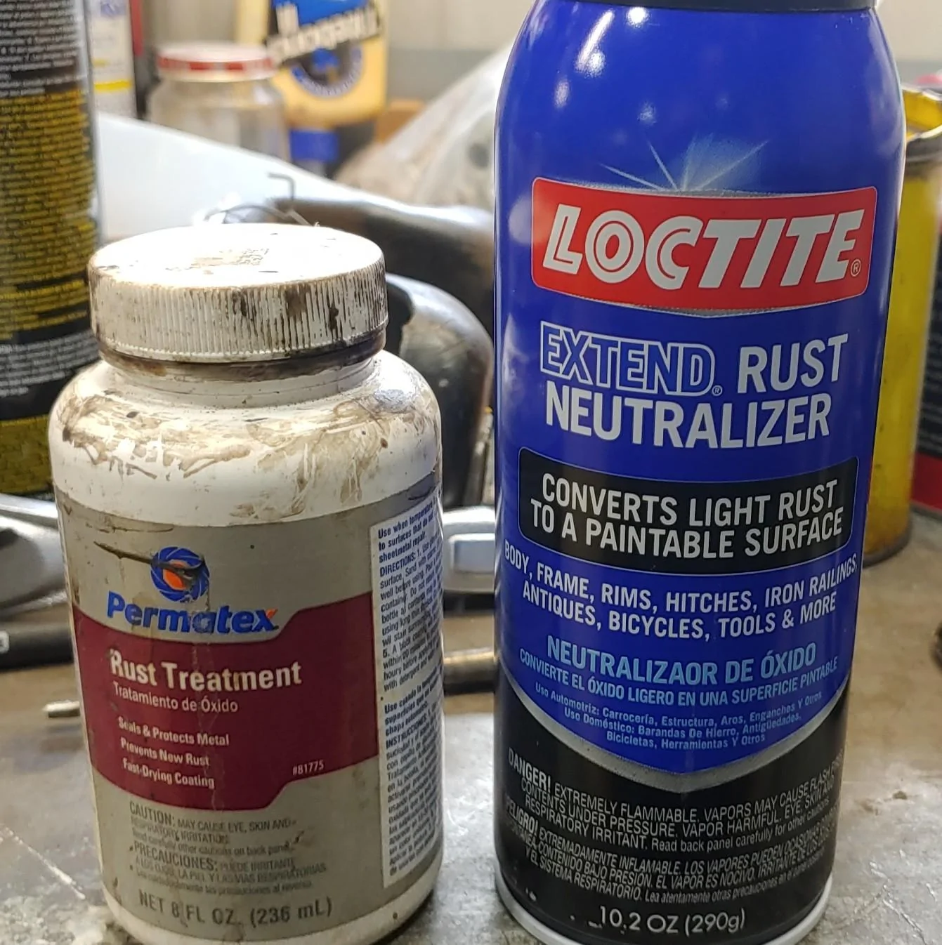

Can convertors just be picked up in a normal store / auto parts store?
Yes. Either in spray form or in a bottle you brush on.
I aim for the Extend but the permatex is basically the same, works the same.
I think I even found some at Fleet Farm at one time. O'Reilly's should have it.

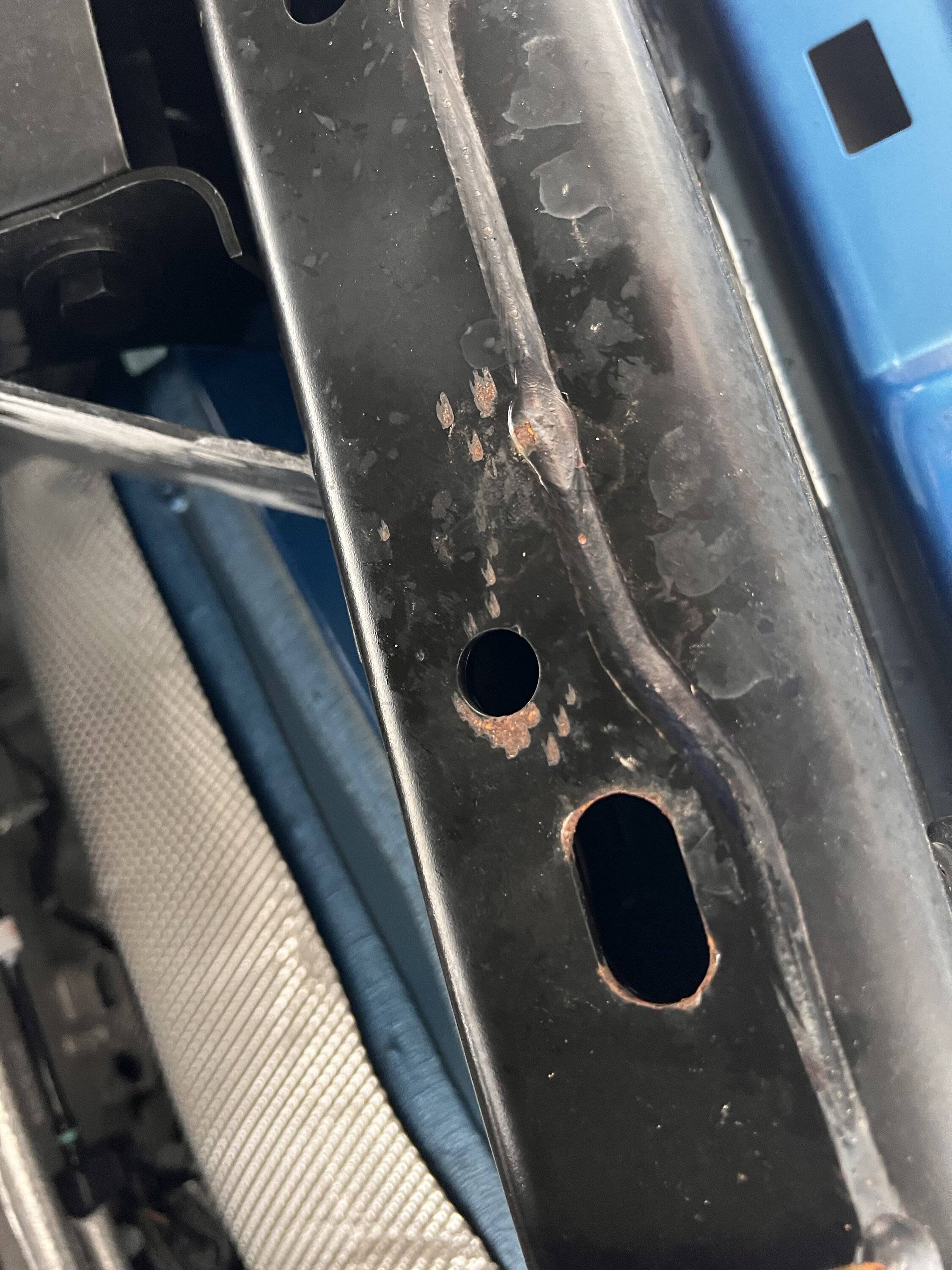

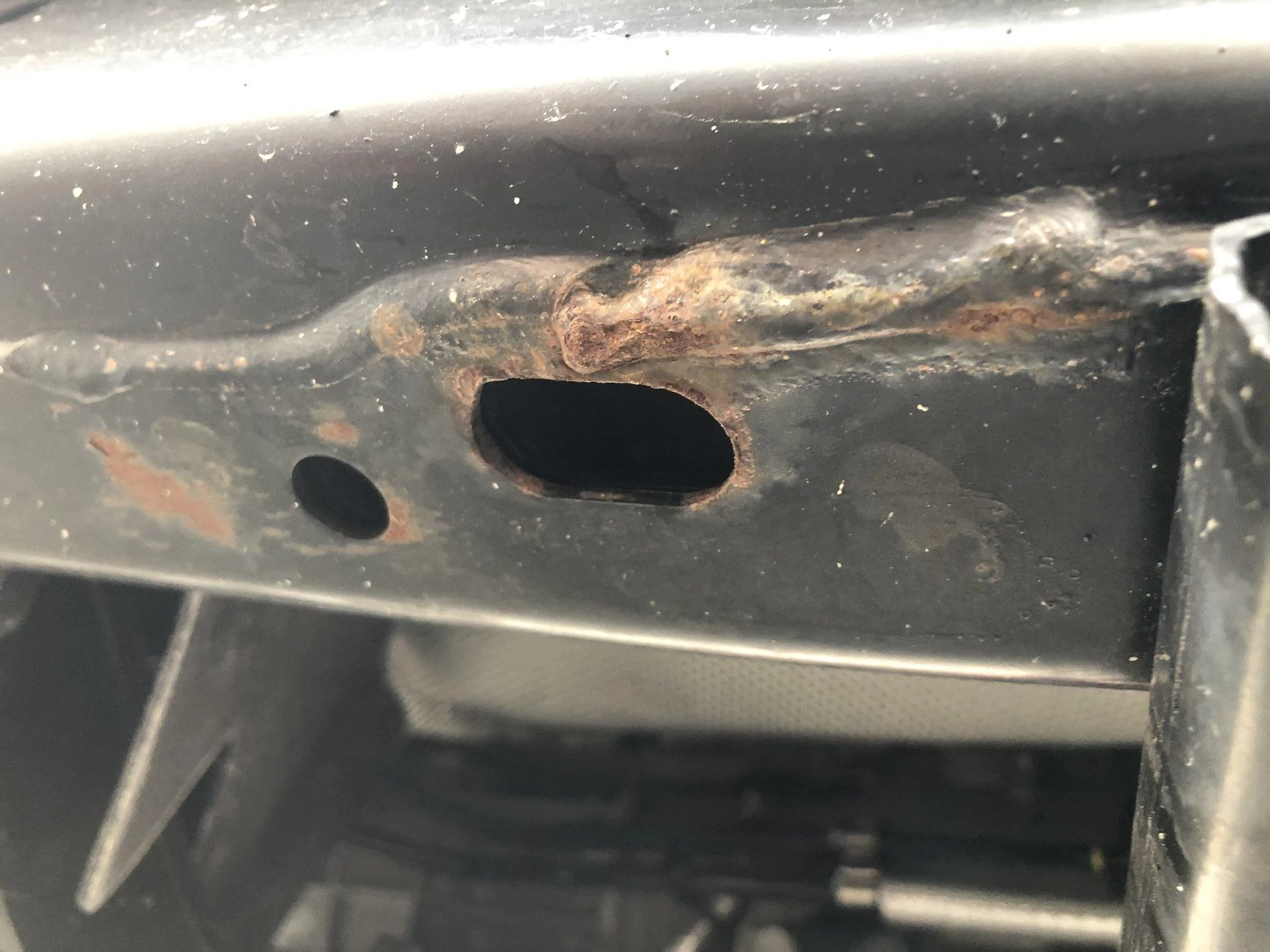

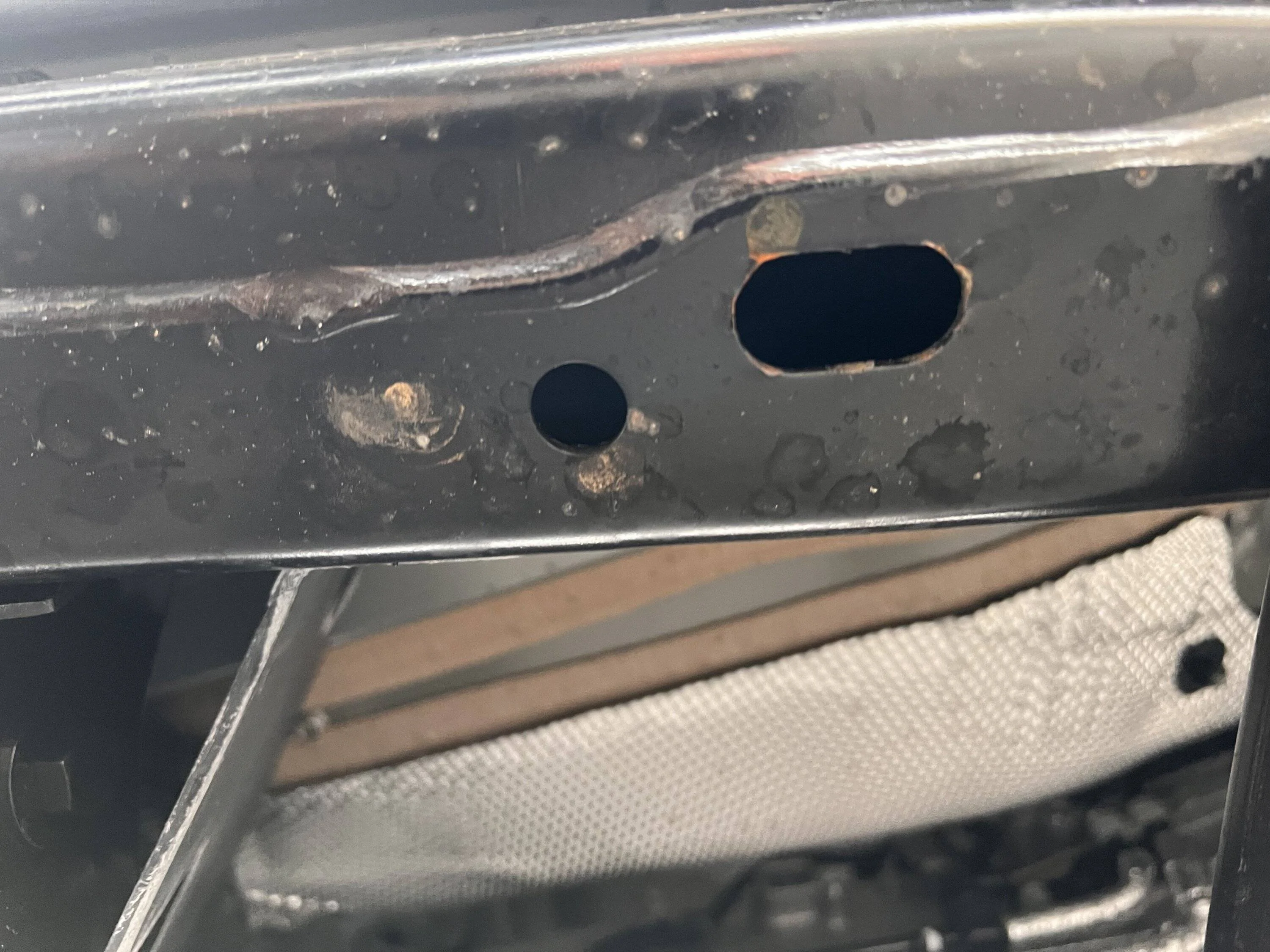

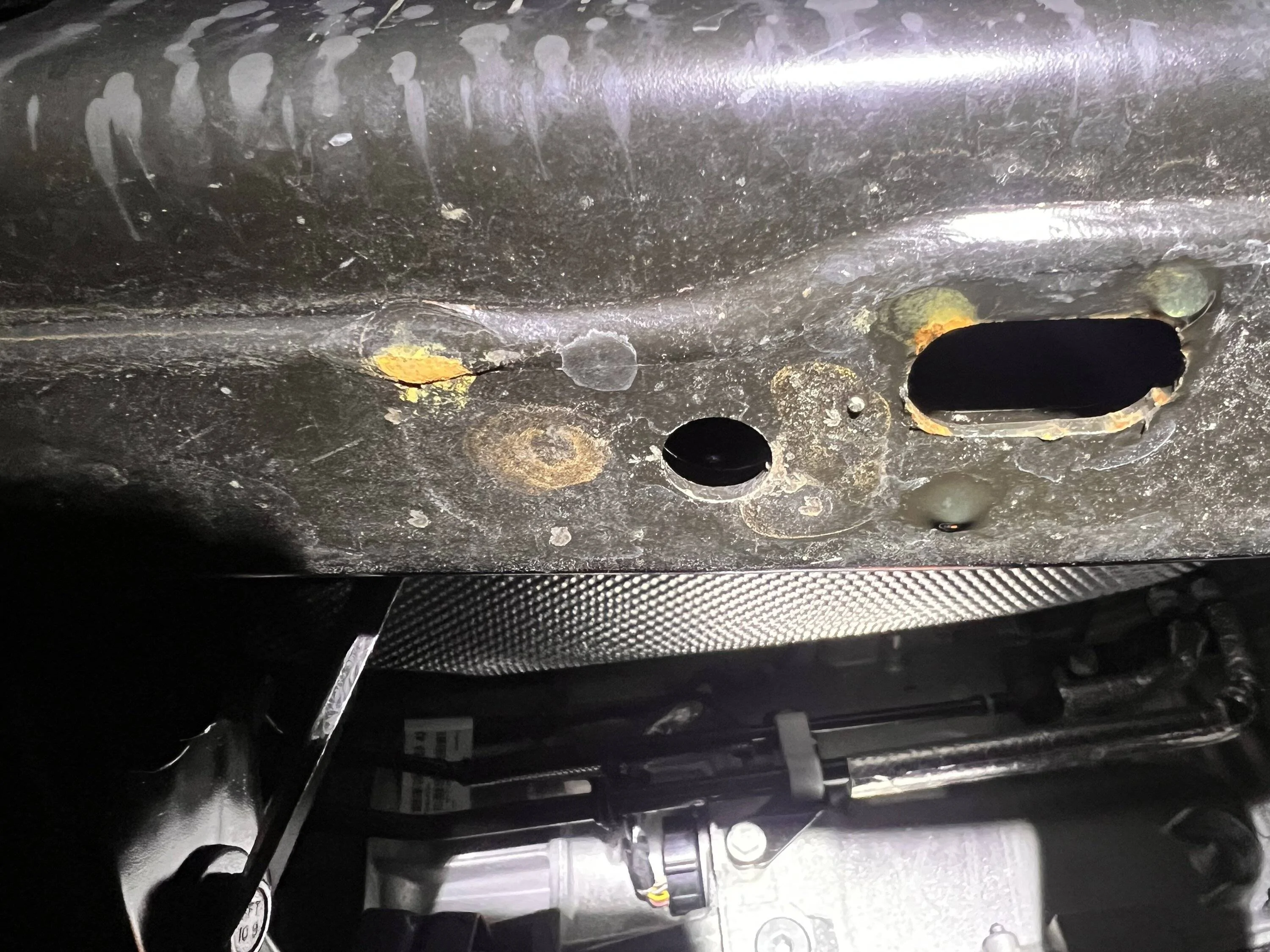

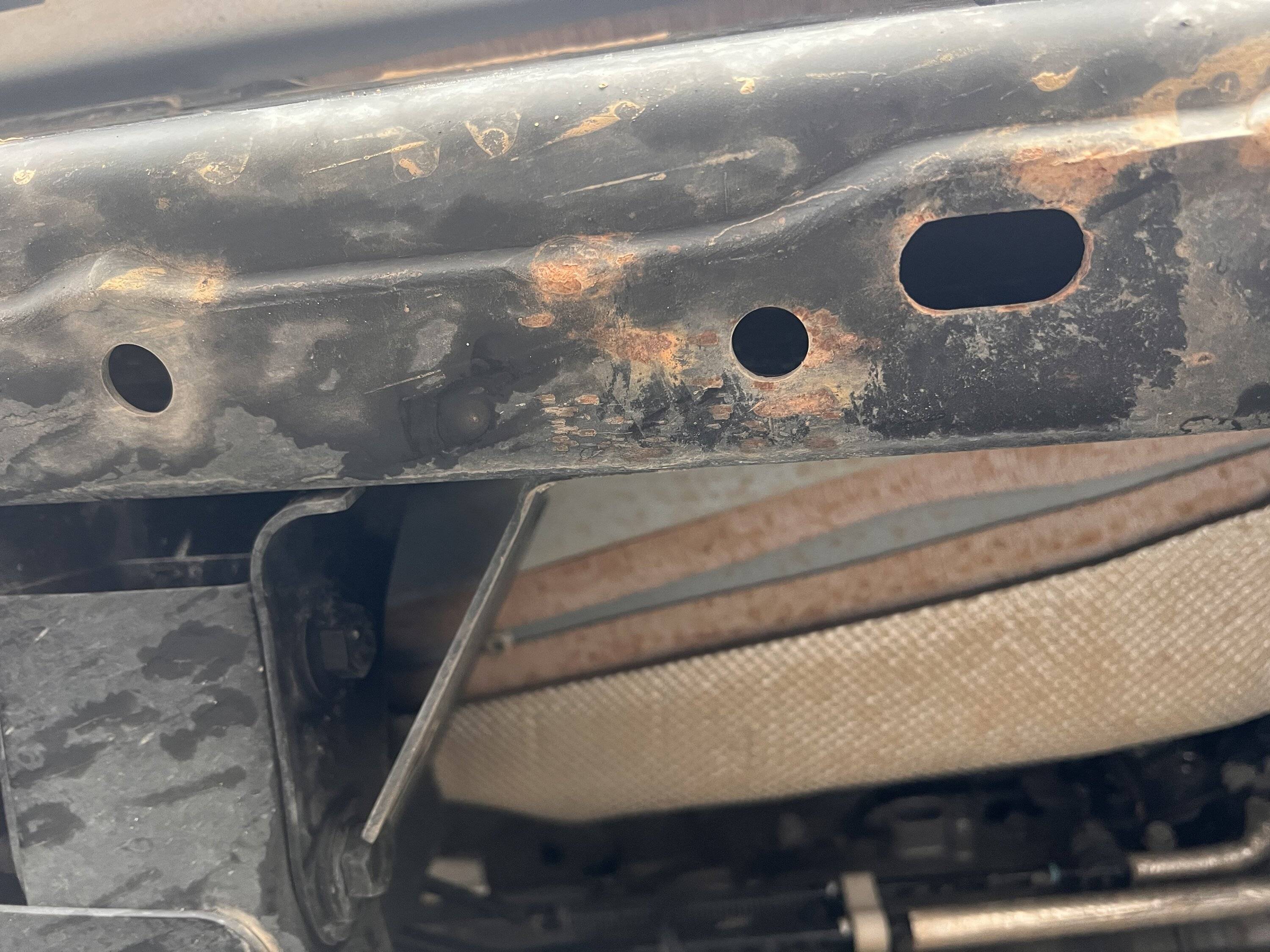

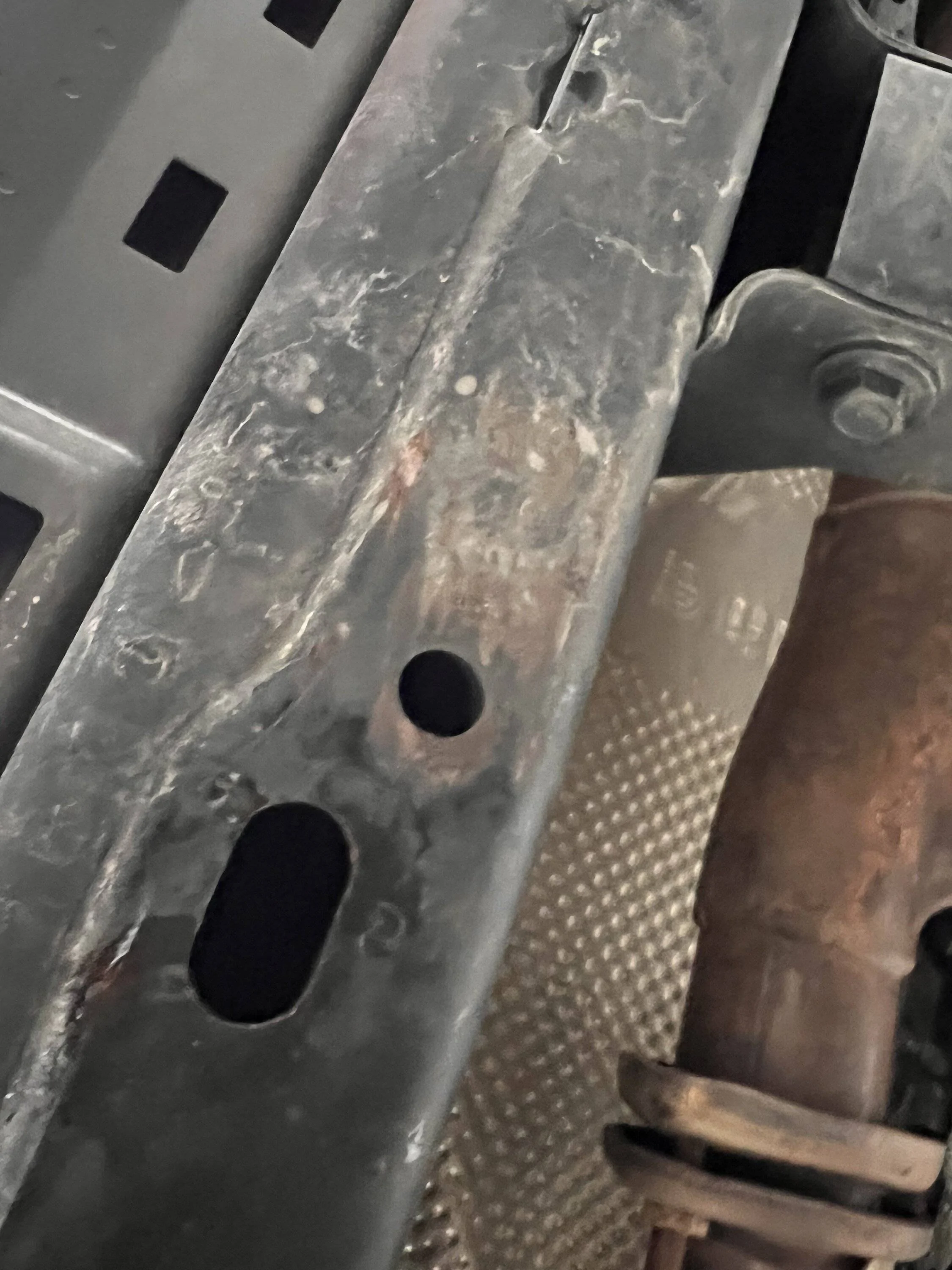

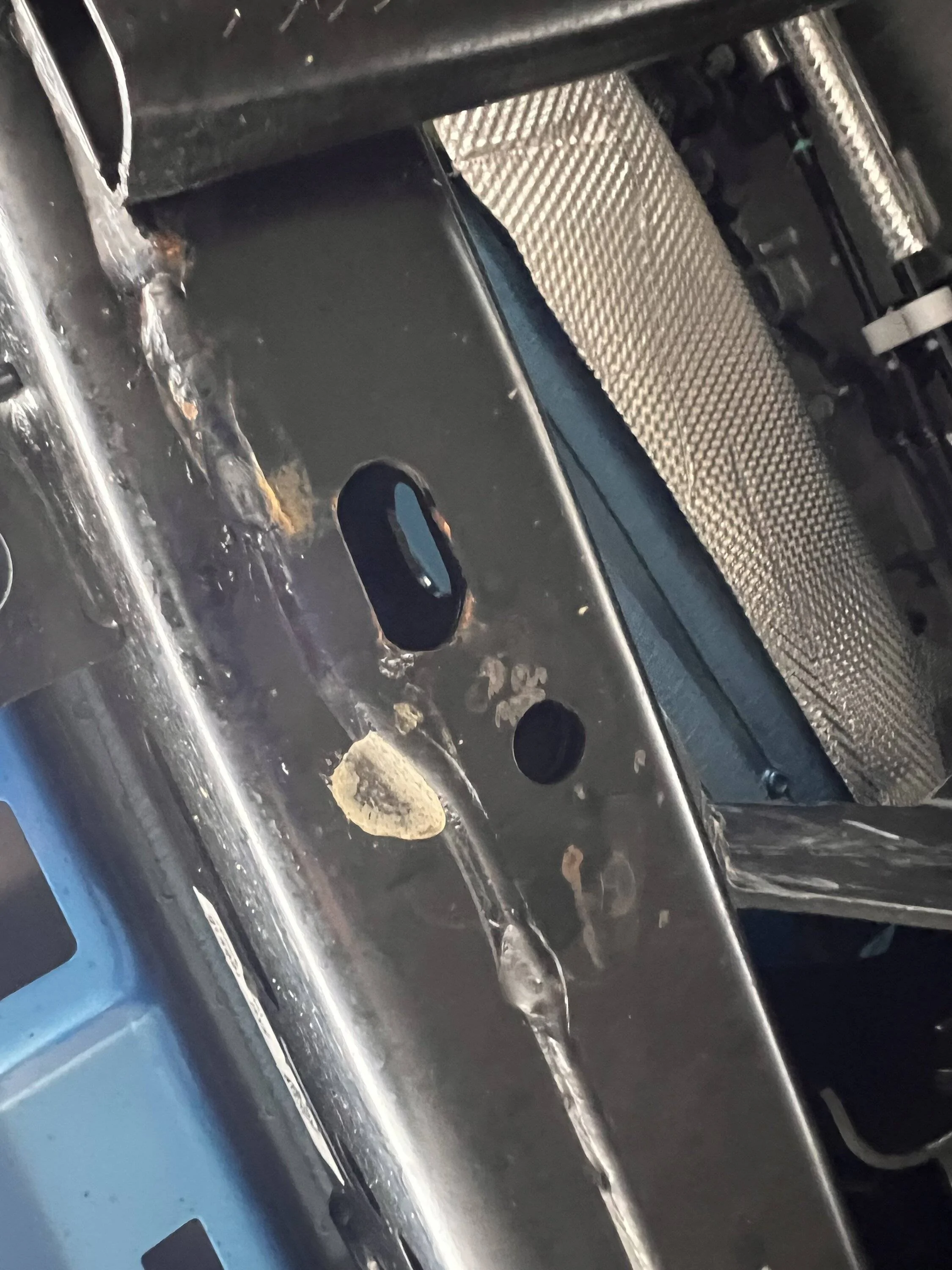

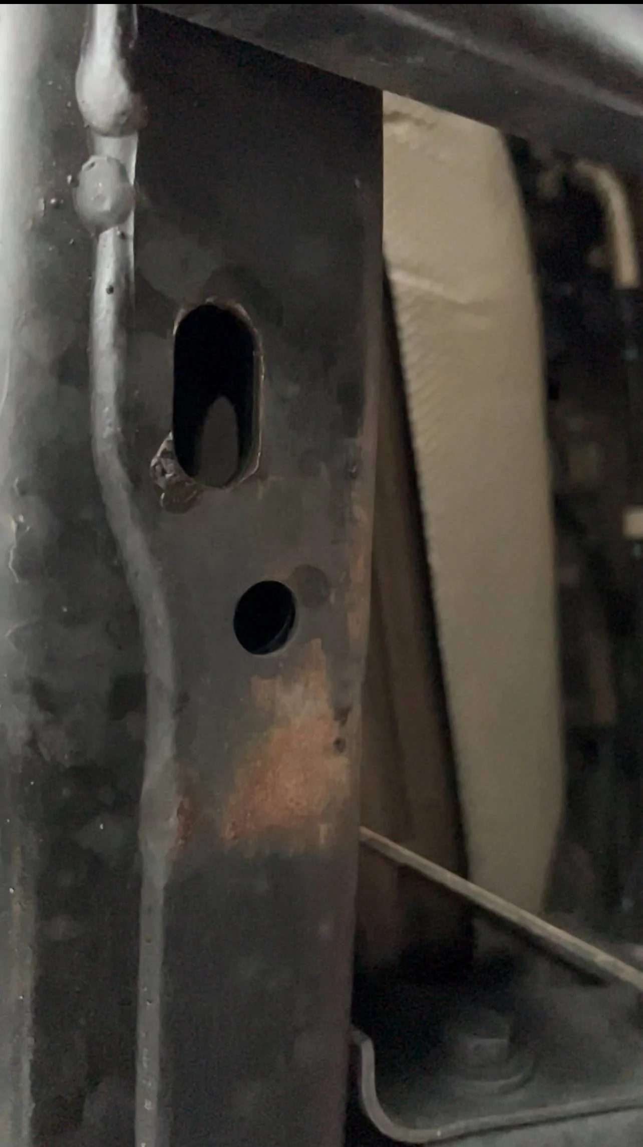

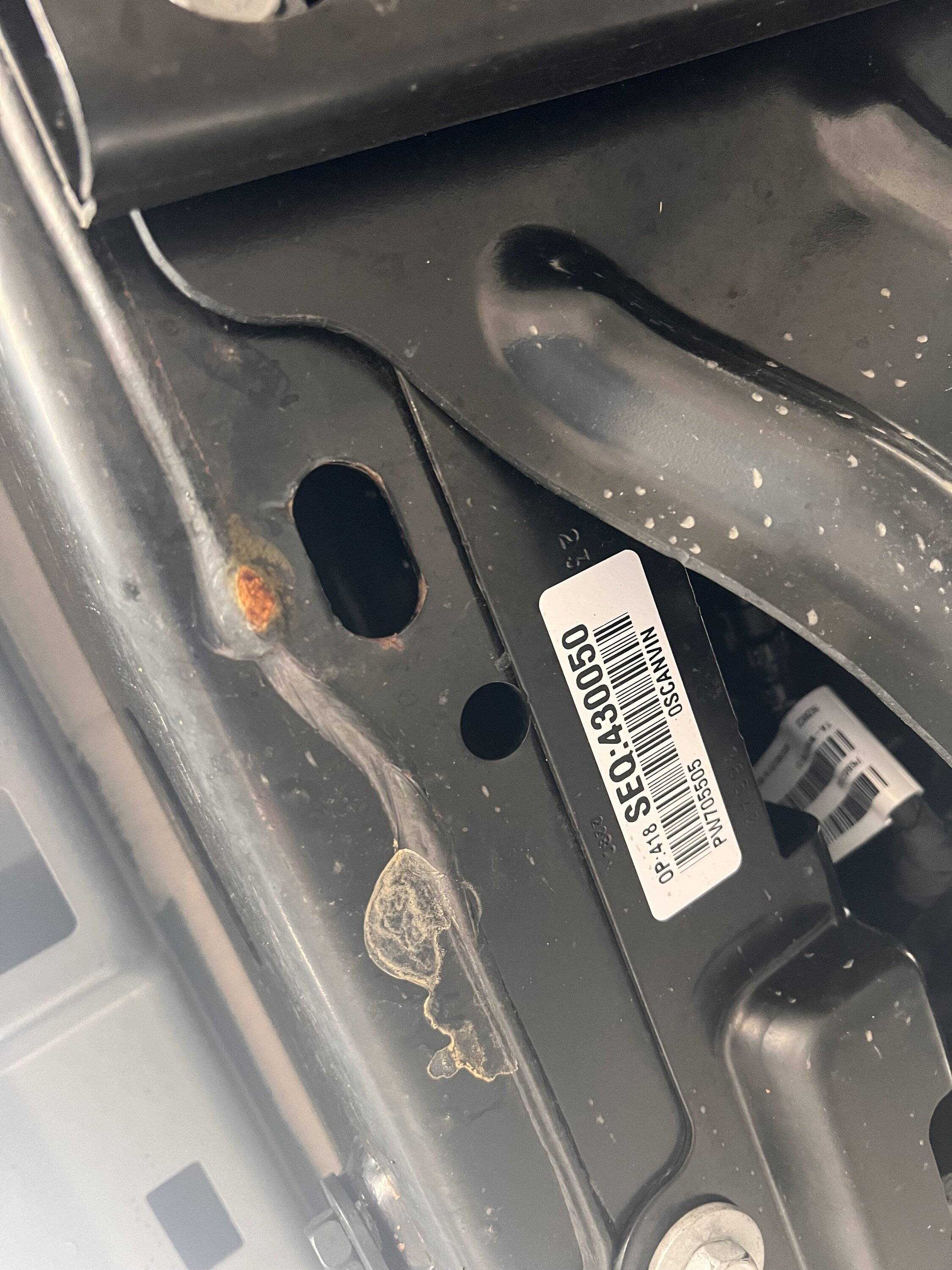

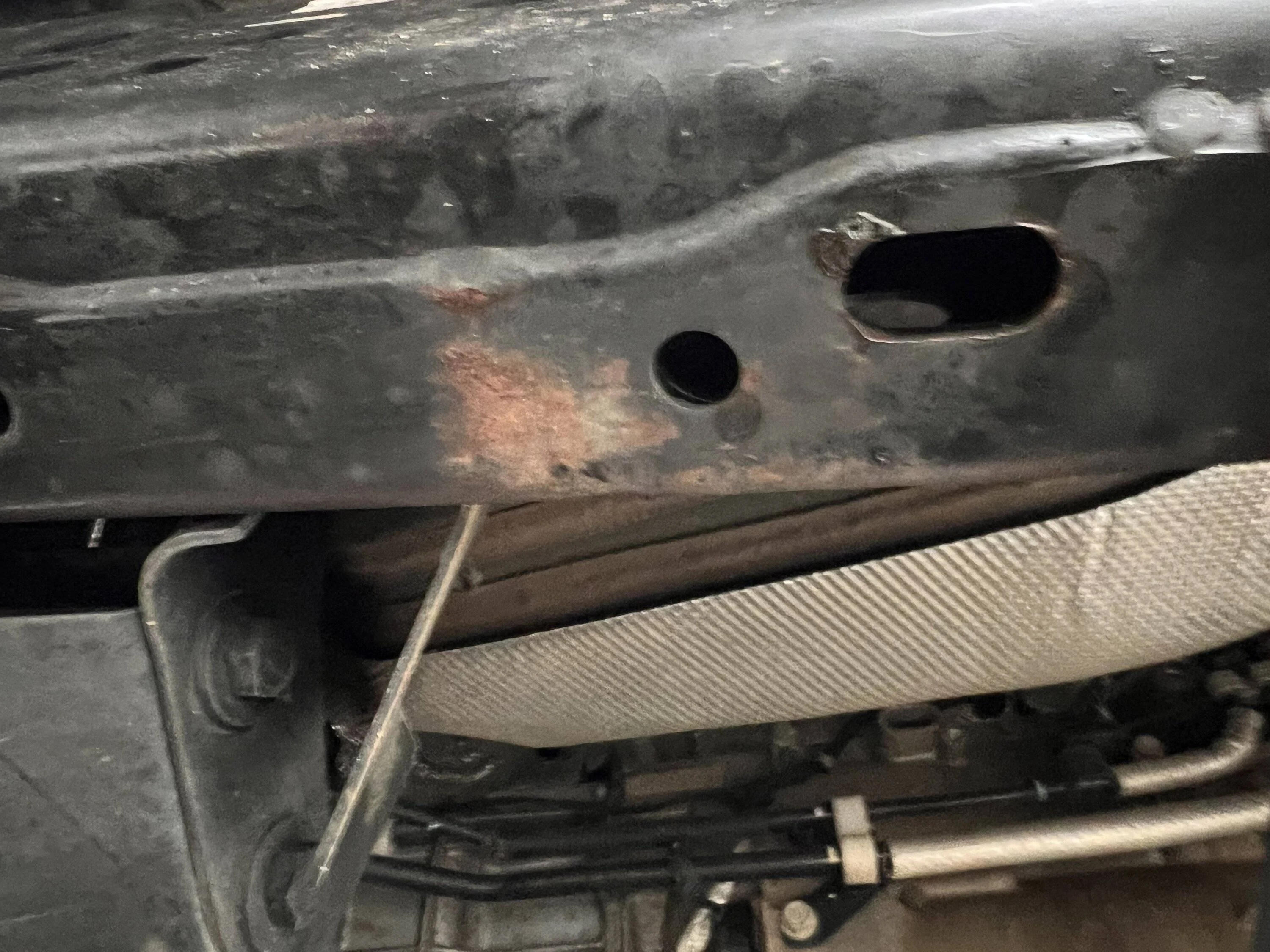

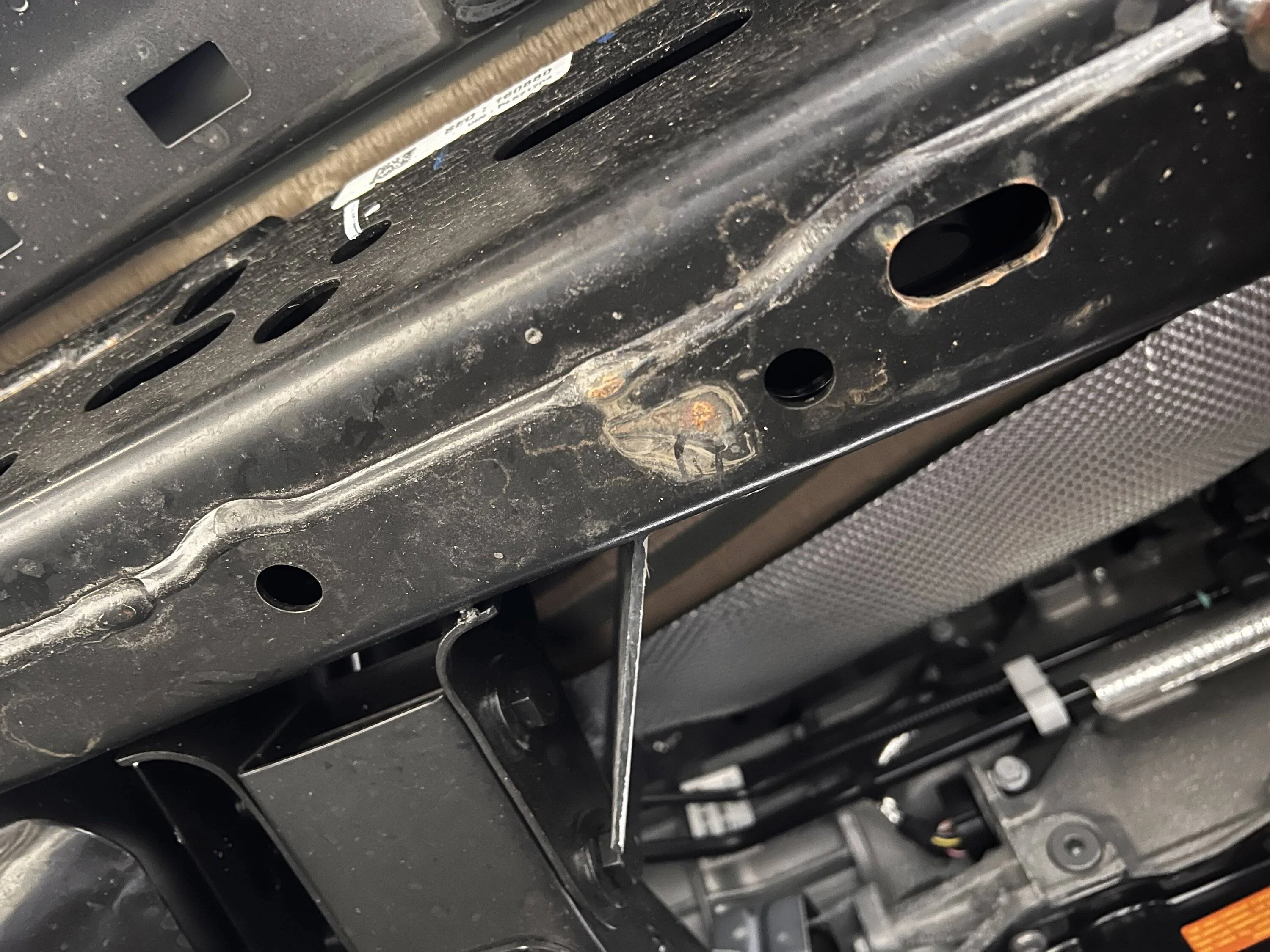

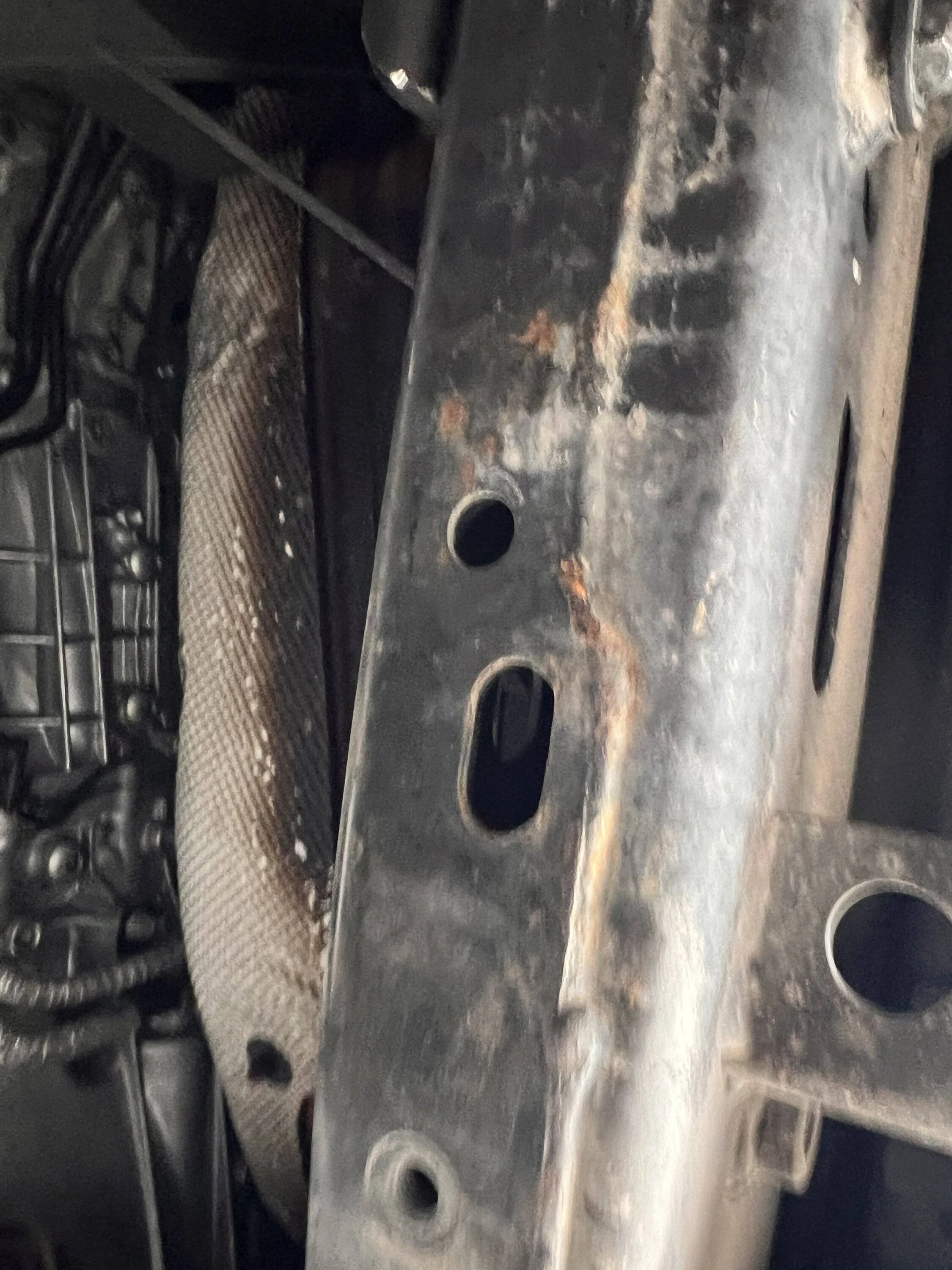

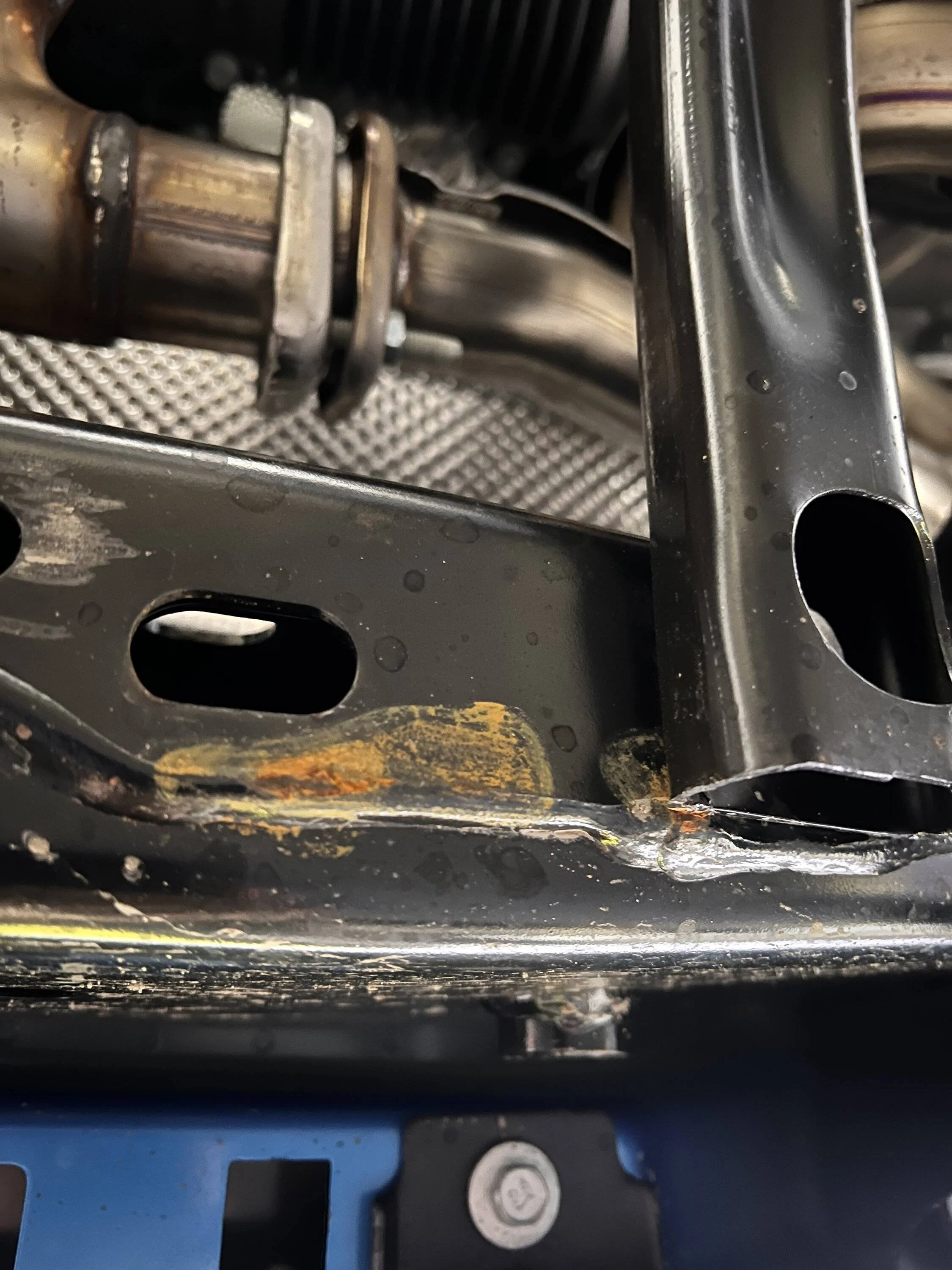

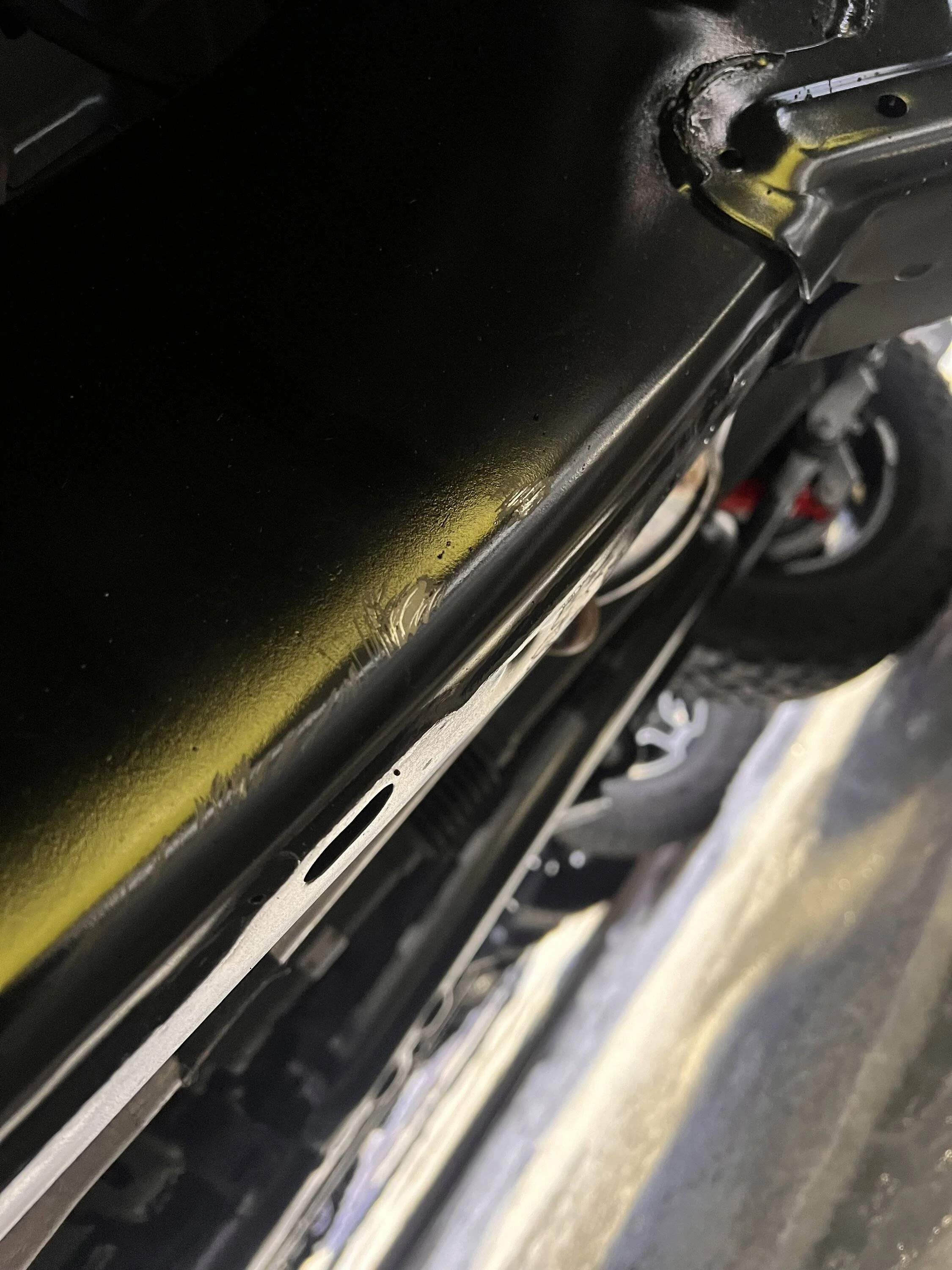

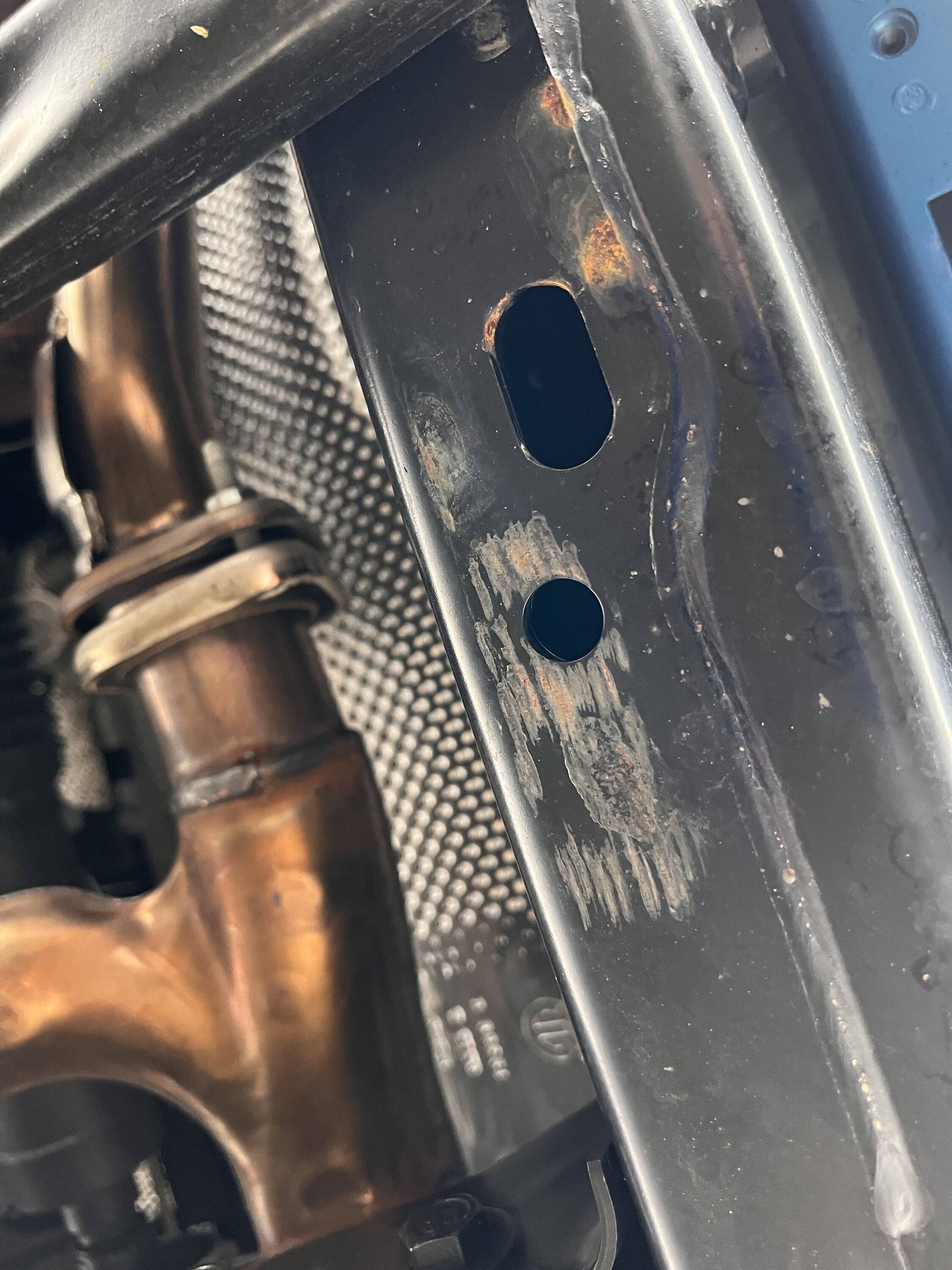

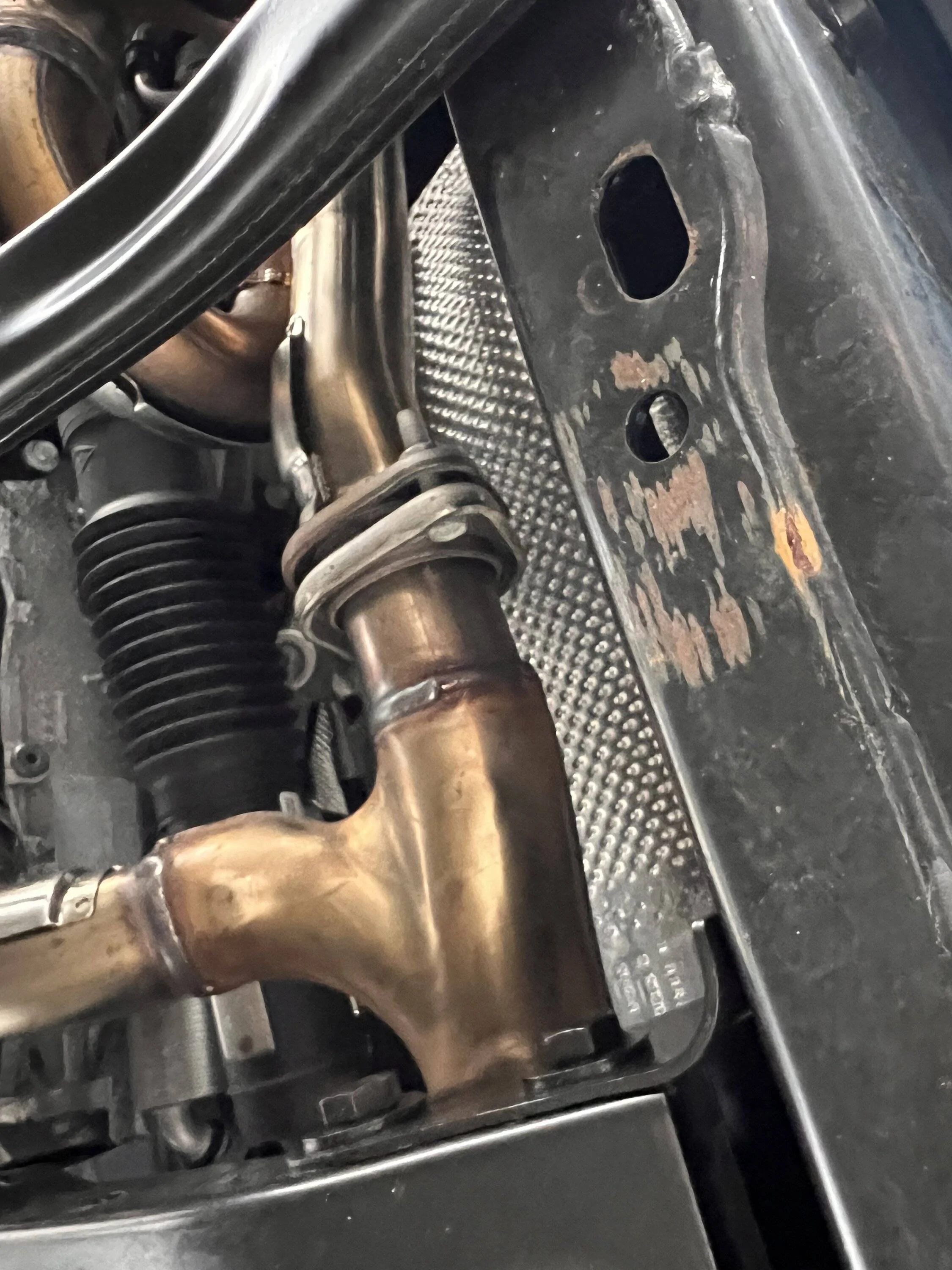

I was looking to buy a 2023 gladiator and there were several on my local lot at great deals. Since I’m a bit OCD I look over vehicles really closely before and after the purchase. On the truck I was interested in I noticed surface rust on the frame, it was a brand new vehicle. I did a Google search and found this post. I then went back to the dealership on Sunday and looked under every gladiator. I join the Facebook group for gladiators and submitted three or four pictures and asked peoples opinion, or if anybody had any dealings with JEEP on fixing the issue . I got heavily flamed like I was stupid and maybe that was the right reaction to my post. I don’t know. I went to a different dealership and climbed under those gladiators and took pictures.
So here are the pictures. You can look at them as a big deal or not. It doesn’t really matter. I’m posting this so someone who climbs under their brand new vehicle and sees rust will know that it most likely came like that new from the dealership lot because all of the rust is consistently present.
Before I post the pictures, here’s what I saw on every single gladiator and on lot of the Jeep wrangler unlimiteds.
All gladiators had several scratches near the rear wheel on the side of the frame with exposed primer/steel.
All gladiators had marks on the bottom of the frame like they were rubbing in some sort of jig that rubbed the paint almost completely off from the frame.
Almost all gladiators had some level of either rust, or some other brown substance in the welds on the frame.
Most gladiators had a similar paint, rubbing/ scuffing issue under the frame directly under the side mirrors.
And finally, as seen in these pictures, all but one (which was a used gladiator) had some level of rust on the passenger side frame under the side mirror, and also usually had rust in the same position on the driver side.
The pictures are of vehicle either a brand new 2023 gladiators or a used jeep wrangler with a couple 21 and 22 gladiators as well.

The bubbled areas, where it's more flaky or swollen, would bother me more than any of the surface areas.
What I'd do - clean any loose or flaking rust off, clean off the surface rust of other areas, treat with Extend or similar, let it dry 24 hours, then paint with a quality chassis paint (Eastwood or others). I use VHT black as it's a tough, great match and is an "epoxy" type paint, reacting with the moisture in the air to set.
A couple of those look bad, IMO, a lot of types of rust in a couple of those pics, some are not a big deal and you'll end up with similar just driving it.
I can imagine the hard core rock crawlers were all over you - but if you live where I do - you nip that in the bud or end up with a frame ready to break in several years (and yes, I've seen it)

Picture 3 (1) looks a bit concerning. My opinion is that it's not so much a rust issue as it is a substandard steel issue. A lot of these newer vehicles, irrespective of brand, are rusting much faster than older ones did. It's like the frame is rusting internally even before the paint was applied. GM, Toyota, Jeep, etc.
I happen to have a 1997 Ram pickup that has almost no rust to speak of on the frame, has spent its entire life outdoors, has driven on snowy roads out west where they use salt and brine, and which looks like the body and frame will last another 30+ years.
I have not gotten under my new Gladiator but will once the nasty weather is gone. If I see any issues I will take care of them myself. I trust I'd do a better job than the dealer.
