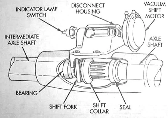

Thinking about this more ...
If your issue is a 'dry' Item 3 bushing, which it kind of sounds like to me, you could potentially get lubricant to it as follows:
Get the LH side of the vehicle as high as possible, and the RH as low as possible.
Overfill the diff with lubricant.
Rotate the RH tire to help work oil into the bushing.
The RH oil seal is outboard of the FAD coupling. So, if you can flood this area with oil, it would get into the bushing area. Normally, the RH intermediate shaft bearing gets some 'splash' lube, but I can definitely see the oil not getting to the bushing under normal conditions.
You could also try removing the FAD actuator, then drizzling oil around the Item 3 bushing while rotating the RH front tire. That might be a simpler way.
The sketch below shows the basic layout of the FAD, although it shows the older vacuum actuated version. But is shows you the layout of the bearing, collar & seal. Inner axle shaft = Intermediate Axle Shaft.
