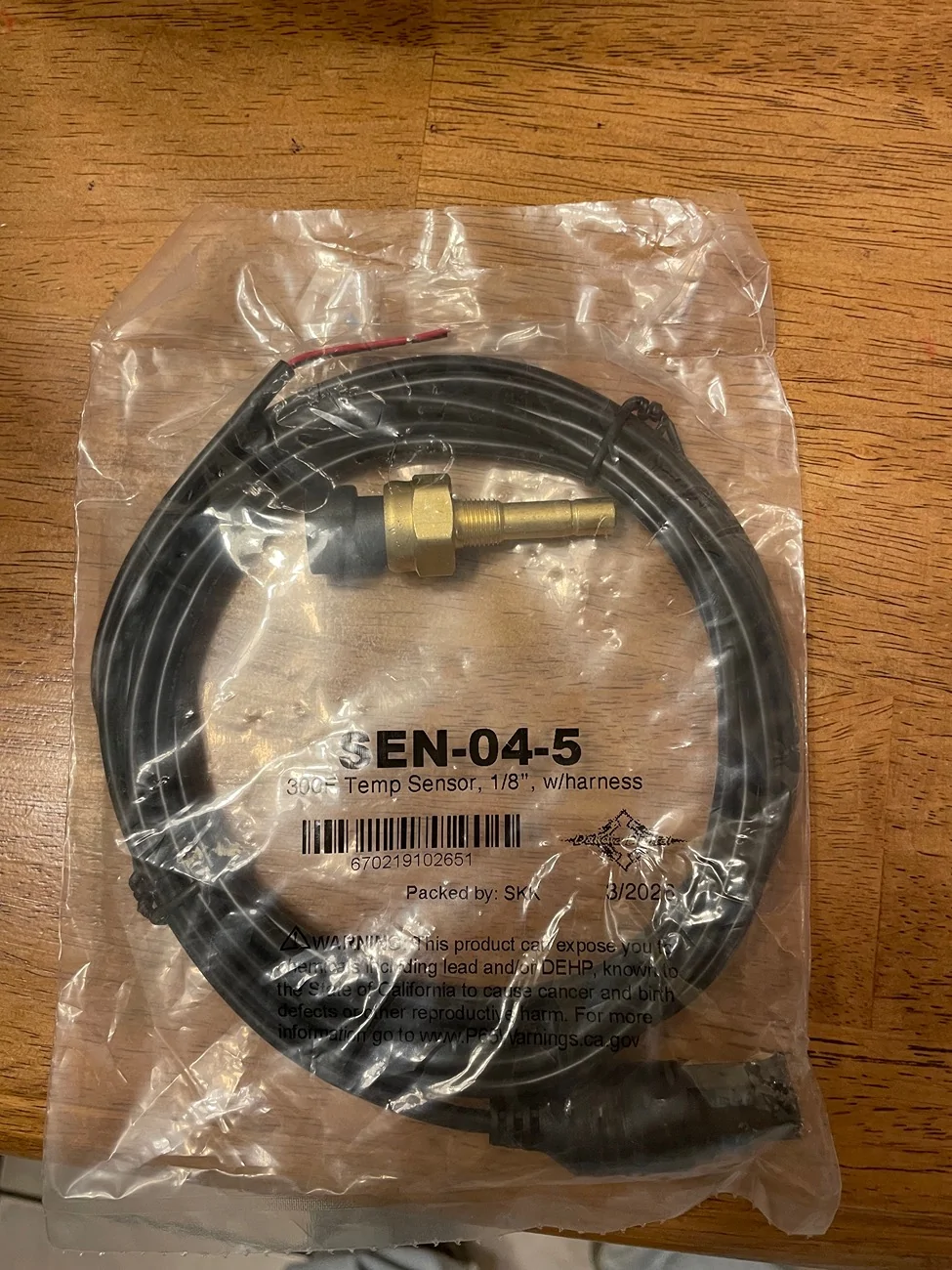

It’s just a coolant temp sensor, just find one that fits the threads in the hole. Dakota Digital has one that is 0-300 degrees. Part # Sen-04-5.
If you don’t want to splice the wires send me a DM and I’ll send you a connector.

I sure appreciate that! However, you don't have to go to all that trouble if you don't want to. I'm just so thankful that you figured out what connector it is. I'm not a "splicer" if I can help it. I'd much rather integrate into a factory harness so that I can return to stock if I have to. Have you hooked up the Dakota Digital temp sensor to see if it reads correctly?

Ok, I’m going to revise the recommendation for the Dakota Digital temp sensor, I went out and plugged it in and the temp read too high, about 135 and the ambient temp is mid 80’s. The sensor in the housing read 86 degrees so I tried another GM sensor and it read the same so that’s probably a better option, part number 213-4514, I bought several sensors trying to find a thread pitch that would fit the threaded hole in the Fleece housing with no luck. The GM sensor is M12 x 1.5 so that is the thread pitch you’ll need.
