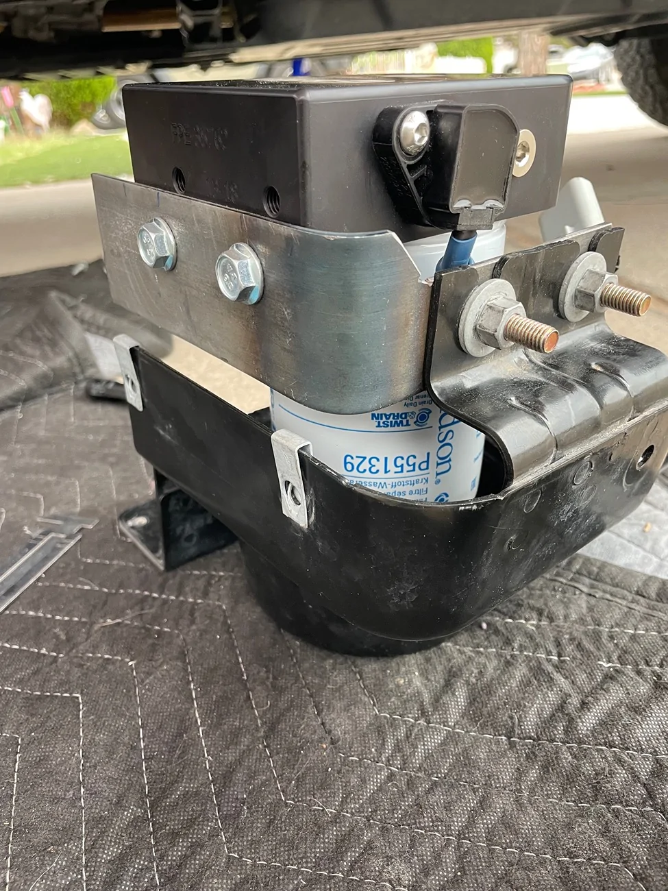

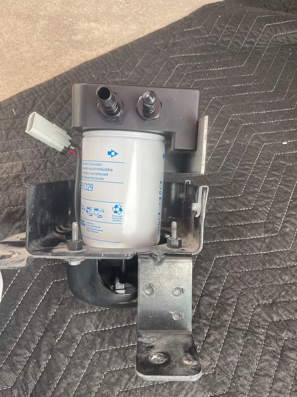

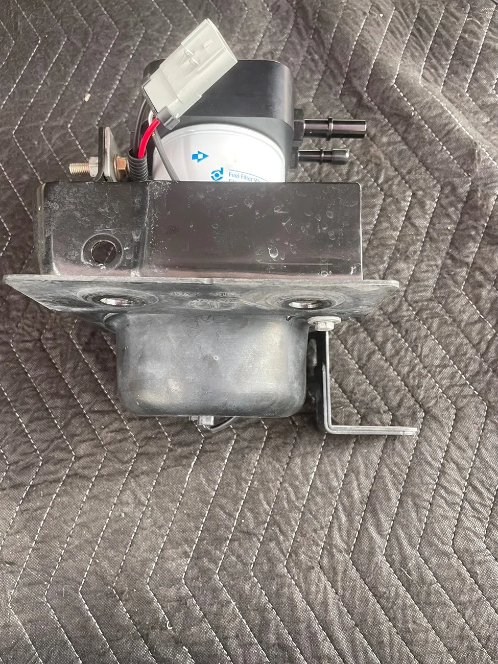

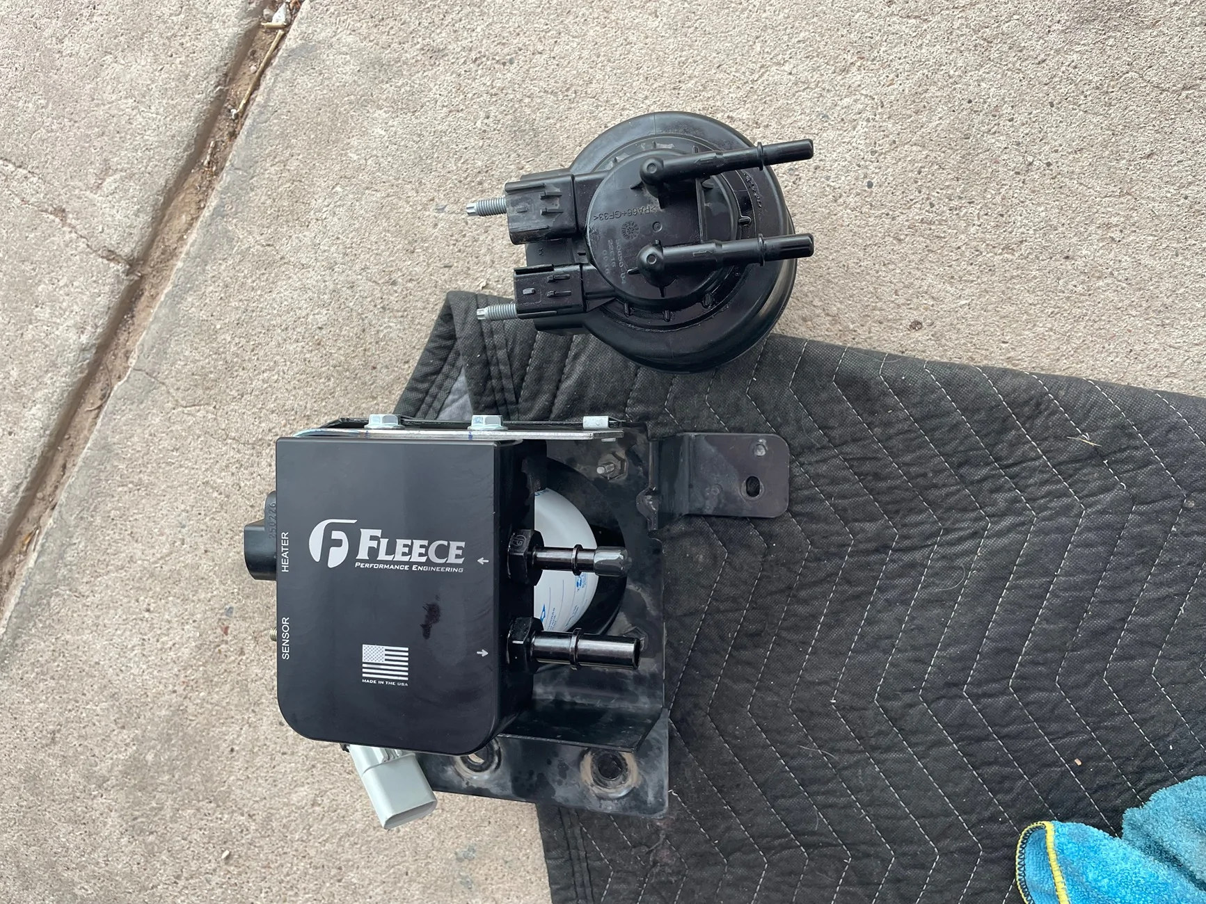

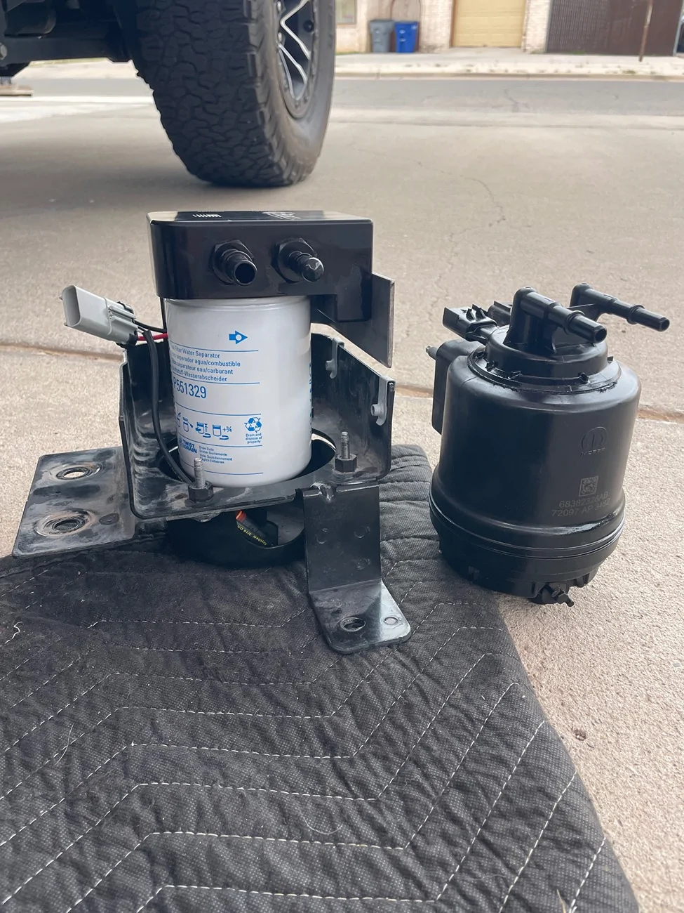

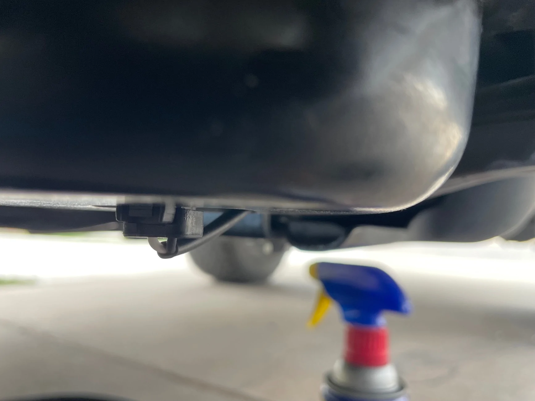

Ok, update time! First off, pitchers cause every body loves pitchers!
Jeep Gladiator Fuel filter upgrade maybe possible IMG_9903
Jeep Gladiator Fuel filter upgrade maybe possible IMG_9904
Jeep Gladiator Fuel filter upgrade maybe possible IMG_9901
Jeep Gladiator Fuel filter upgrade maybe possible IMG_9902
Jeep Gladiator Fuel filter upgrade maybe possible IMG_9907
Jeep Gladiator Fuel filter upgrade maybe possible IMG_9906

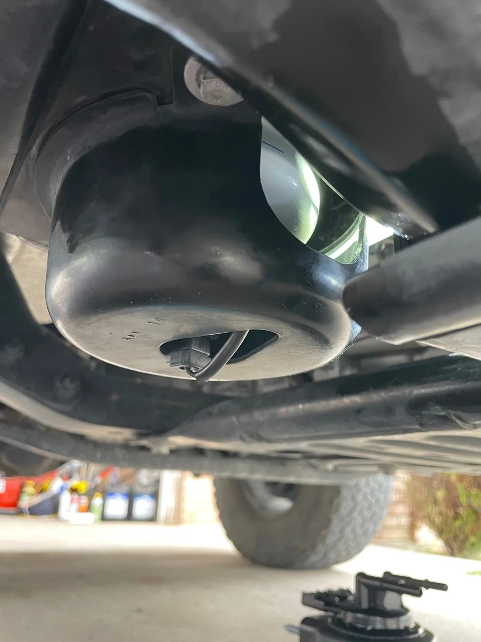

it actually fits pretty good, I think it can go up a hair more or I can get creative and lower the cover.
There are a couple snags, the first one is easy to resolve if you know about it in advance, the fittings aren’t the right size, order a -8 ORB 5/16 fitting because shocker!! The 6.7 has larger fuel lines! The 6.7 has 1/2 inch and 3/8 lines, our 3.0 has 3/8 and 5/16 lines. Just swap the inlet to the outlet and put the 5/16 into the inlet.

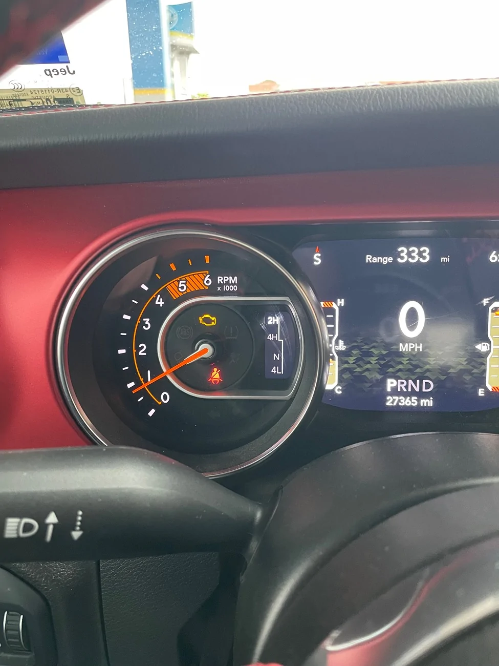

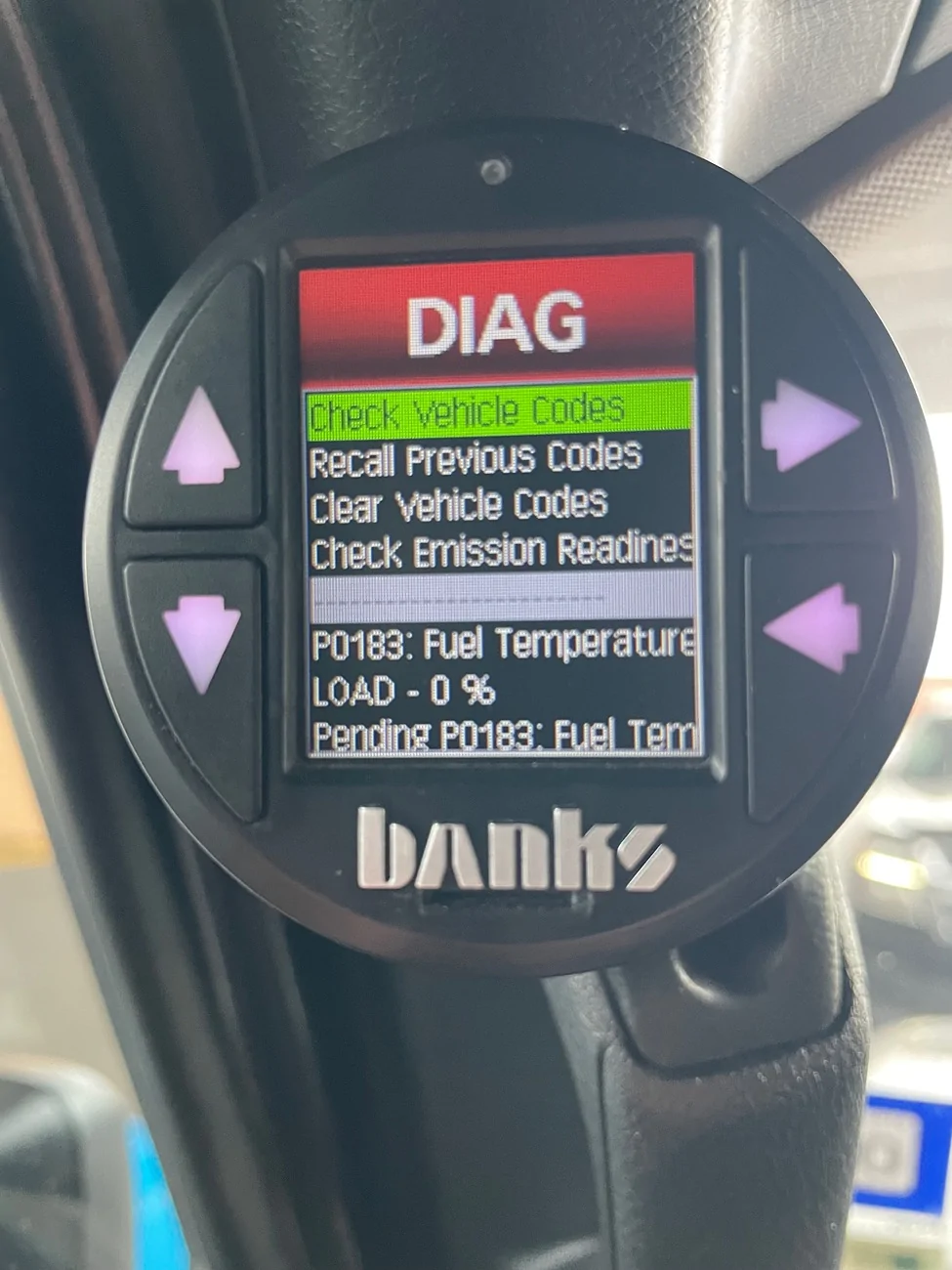

The second one is not so easy, the filter housing has the fuel temp sensor in it and the Ram doesn’t. I left it unplugged and the truck was NOT HAPPY!
Jeep Gladiator Fuel filter upgrade maybe possible IMG_9905

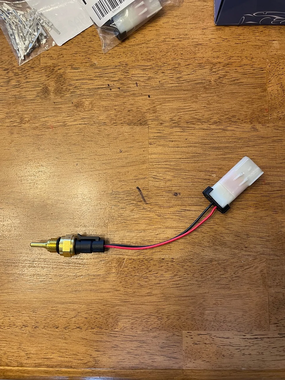

Update, got the connector and temp sensor in, the connector is not the exact one, it is the right series but is keyed a bit differently. I filed off the key so I could test it and it fits so I did some more digging and found the right one, I hope. Should be here in a few days, when I’m sure I’ll post the part numbers.

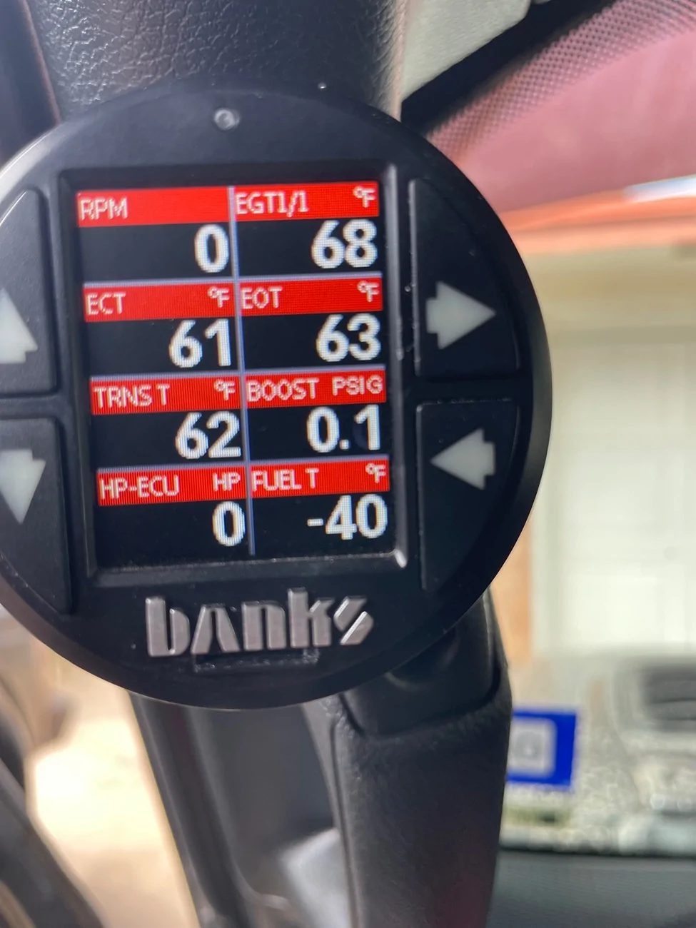

I put this together and tried it out, factory temp sensor, bottom right is fuel temp
Jeep Gladiator Fuel filter upgrade maybe possible IMG_9917
with the OEM unplugged
Jeep Gladiator Fuel filter upgrade maybe possible IMG_9918

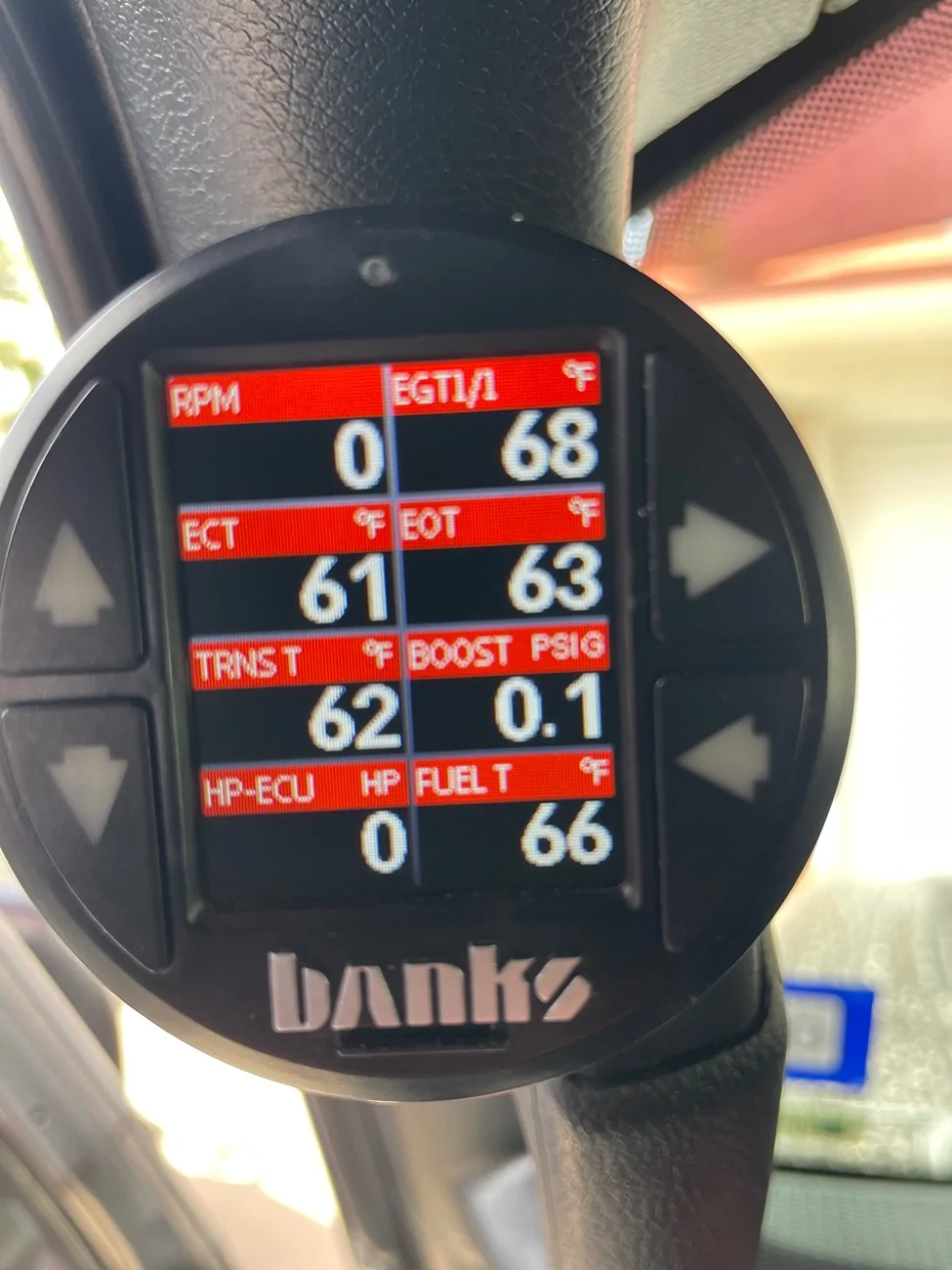

it’s cool today, in the 60’s, definitely not -40!

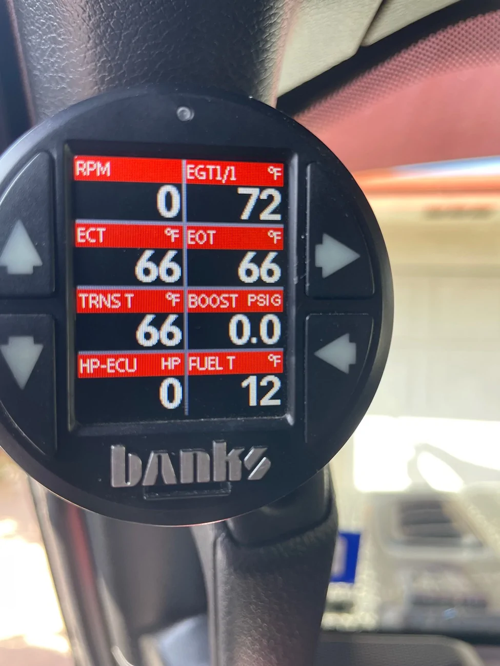

With the replacement sensor plugged in
Jeep Gladiator Fuel filter upgrade maybe possible IMG_9924
It’s not 12 degrees here but at least it registers, I warmed it with a heat gun the temp did go up. I don’t think this will be a problem for the Fleece fuel heater as it is self regulating and only turns on at 28 degrees and off at 45(?) so it’s not going to run all the time. We will see when I get it installed if the truck is happy.
I’m going to remake the bracket for the housing with a couple changes. The temp sensor I ordered is too big to screw into the housing so I ordered another one.

The sensor was a budget sensor and I’m sure it was bad, I got a better one and the temp was the same as the OEM in the housing. The problem is the housing is threaded 1/8 NPT and most sensors are larger than that, I believe I found a 1/8 NPT sensor at a reasonable price and it should be here this week along with the right connector.

I made the bracket for the filter base out of 1/8 x 2” strap, about 9 inches and bent in the middle and holes drilled to bolt it in the factory “bucket”
One -8 male ORB to 5/16 EFI fuel line fitting
Obviously, the Fleece filter mount and the Fleece fuel heater if you need it.
OK, now the bad news, the filter for that mount is a primary filter with a micron rating of 10-13 depending on where you look. That isn’t good enough by itself, so you are going to need a secondary filter with a 2 micron rating. There are a lot of options, and you will need a filter mount for it. I looked at the Cat 1R-0750 which has a 2 micron rating and is about 7 inches tall so it will fit under truck. The filter base has four inlet/outlets and comes with two plugs, so you need hoses to plumb it in and a reducer to screw your choice of fluid temp sensor in one of the extras. -6 AN hose and fittings are readily available.
