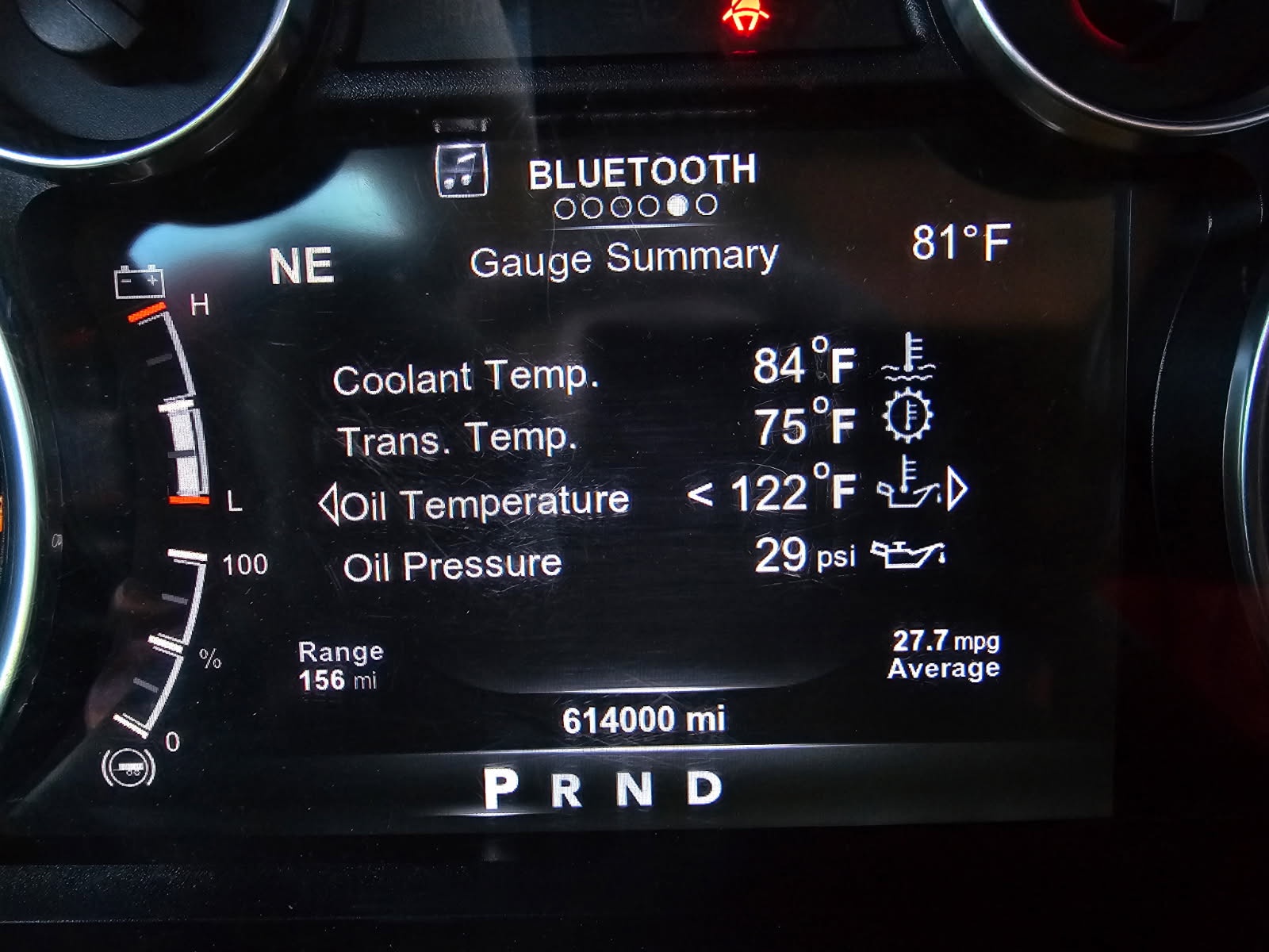

I will say afterlife oil is staying significantly cleaner.
Turning off EGR makes a huge difference in engine cleanliness. My buddy just turned 614,000 miles yesterday on his 2015 Ram EcoDiesel (GDE tuned).
