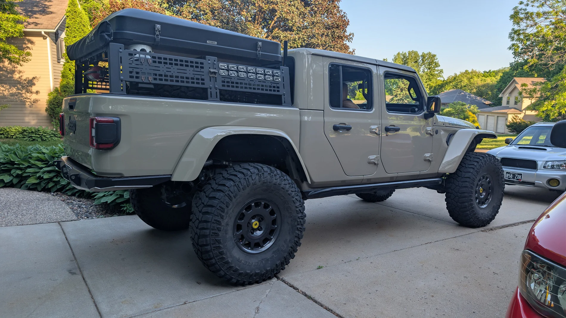

Update. Same rig, now 40s and 4.88s. MRTuning stage 2. Off idle pull, no brake boost. 4wd.
